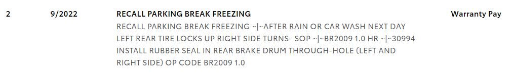

    Did not read through all the comments so apologies if this is redundant for anyone. Apparently my original dealer did not want to be bothered so I found a dealer in my area [Central MA] that dug into this issue and found a recall for it. It was fixed in September 2022 under warranty. Needless to say this is my new dealership for maintenance and problems. See attachment below for dealer comments from Toyota Owners website.
