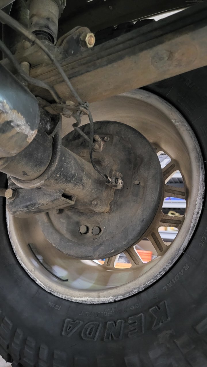

    An update to this thread original intent: I finally got my rear axle housing swapped to one that isn't bent in the last week, and a general whole-sale refresh of everything on the rear of the truck (springs, shocks, axle housing, bearings, shackle hanger reinforcement, and sway bar above axle, etc). And so the new rear brakes are installed. Not driven other than a test drive around the block yet, so brakes aren't bedded in and not fully bled either. Had to change rear brake soft lines to the axle as well, so there was significant fluid that came out and air went into the system, not to mention the new hard lines on the axle and new wheel cylinders in the brakes all have to be filled and purged. Probably take several bleeding cycles. Have some more work to do before taking the drums back off to check how things are looking and then going for a full blown bedding process and getting them really hot, broken in, and analyzing the performance.
    What I have in place now, just as refresher:
    trd sport. master and booster upgraded to tundra. 4runner front brake upgrade with larger and thicker rotors (EBC sport dimpled and slotted rotors), and larger diameter pistons in the calipers (14WA). EBC orange stuff extra duty brake pads (which are currently 80% worn, wondering whether to do rear brake testing with existing pads or put new ones in for the bedding process and brake testing). Rears I have 1-1/8" wheel cylinders installed (recall stock is 15/16"), and beefed up brakes ceramic pads installed, with brand new OEM drums. I also have brembo as well as power stop brake pads to try if I feel like I want to change anything.
    Goal for me was to upgrade the rears to have them do proportionally the same amount of braking as the upgraded fronts. My front brakes were doing "all" the work, and wore through a set of pads quickly, and I could just tell the rears weren't doing as much as they should given my fully loaded expo truck and the additional weight I'm always hauling in the rear.
    When I have more testing and info, and confirmed everything is working correctly, no leaks, no air bubbles, and bedded in I'll let you know.
