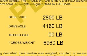

    I have really slammed the brakes hard several times... truck performed well. Fronts are still the ones that lock up first, so I can confirm I didn't overdo it in the rear, at least for my application and the weight I carry in the rear and the tires I have. Keep in mind I have a lot of weight when loaded up for a trip, 4000+ lbs on the rear axle. Even when I unload and not carrying consumables or some of the other gear, I still don't lock up the rear tires on flat ground with a panic stop. To me, this still confirms to me that the changes I made are in the right direction for me, given that the front upgrades changed the brake bias towards the front and the rears were doing less than their fare share of the work, even thought the rear has most of the trucks weight. Now it is more balanced, but not overboard on the rear.
  12. Nov 29, 2022 at 8:42 AM
    #112
    wicked1
    wicked1 Well-Known Member
    Dec 14, 2020
    #349587
    177
    Thanks for the reply.. I'm in the same situation..
    This is empty:

    Yep, I hear you on the weight, when all setup for camping and lengthy expeditions, they are heavy heavy...
