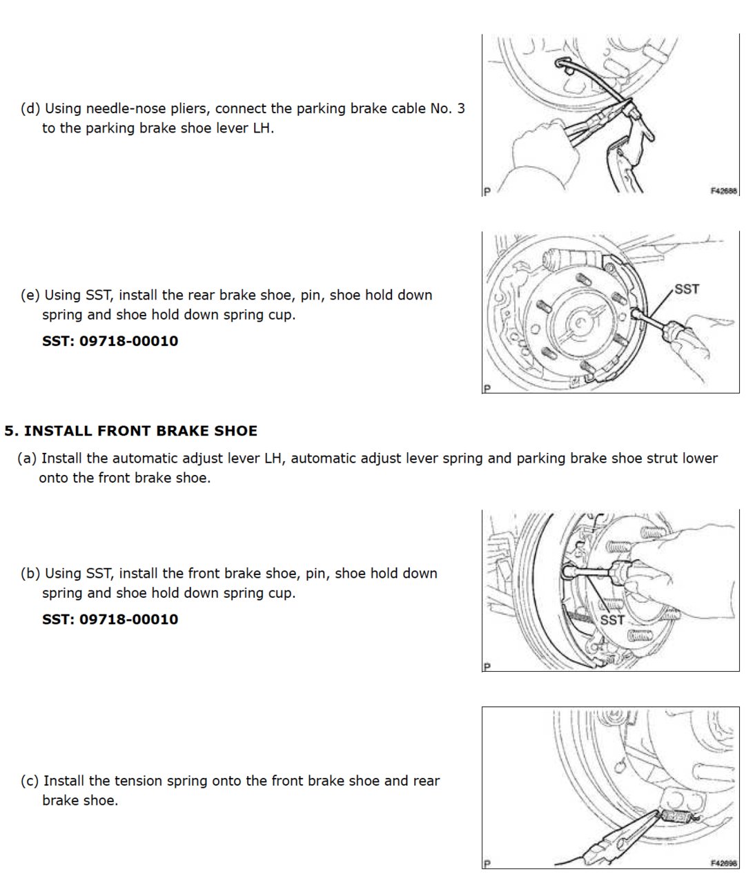

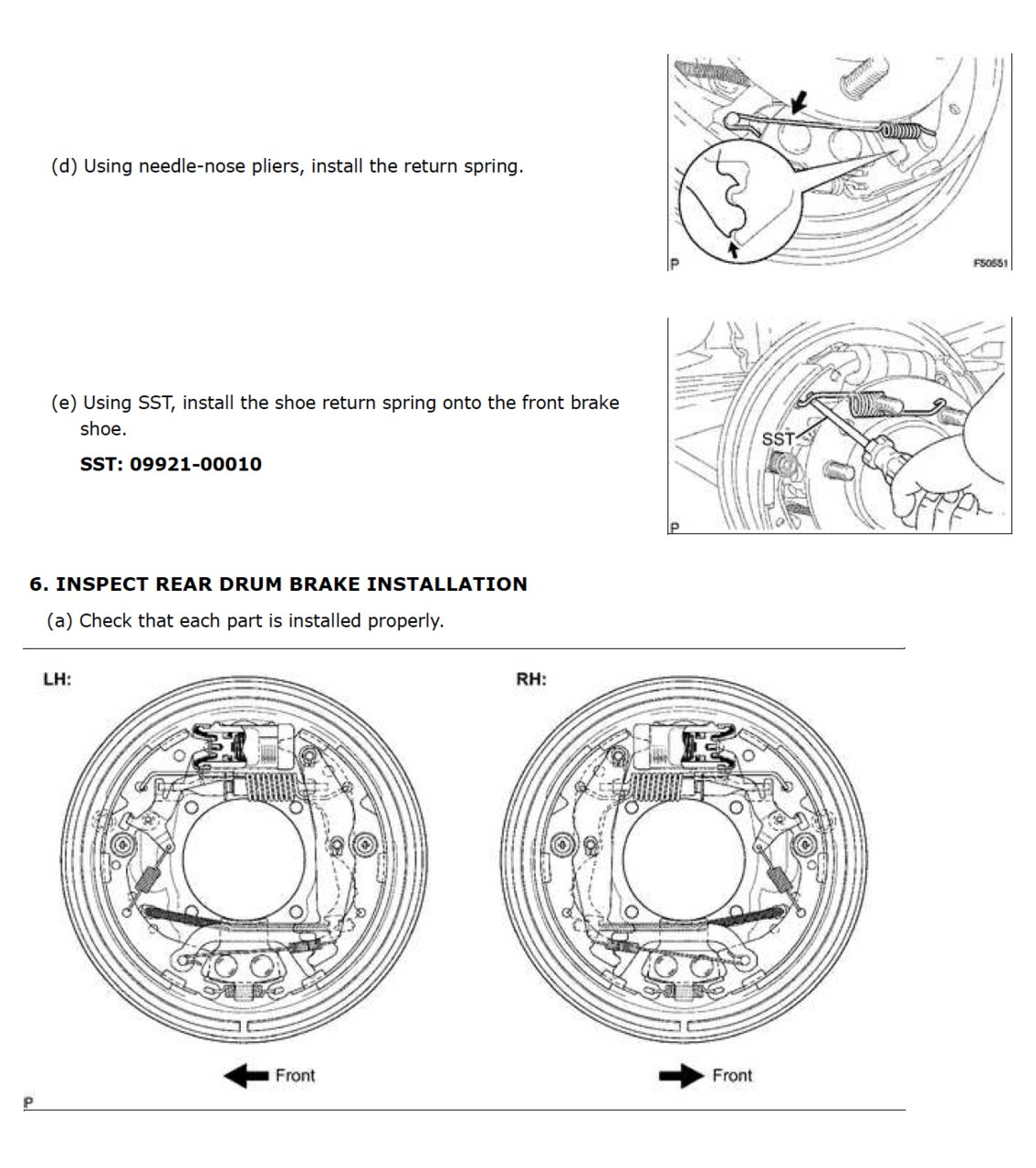

    Or just learn how to do them. It's not that hard.

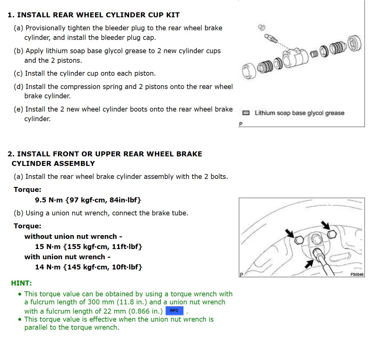

    Especially with some reference material like has been posted.

    To be fair, the post was before that material was posted, but sometimes you just have to learn how to do something. A little self reliance.
