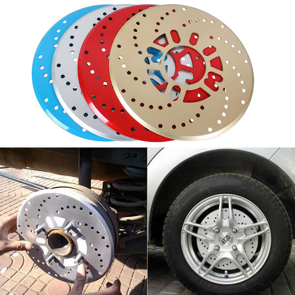

    Found your solution.... disc brakes bro!

    Too bad you had to show off that little secret, which has been on the market a while.
    Now all the mall crawlers will be ordering up. Make a nice contrast to their black wheels.
