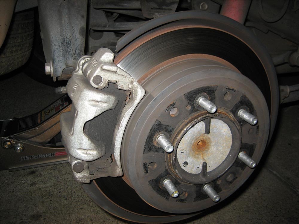

    Is that one of the whack-job disk/drum rear rotors? I've seen em on ford and others. Disks connect to the brake pedal, the drums connect only to the parking brake pedal/lever? That's a double whack-job and the rotors are more expensive, and you occasionally get to replace both pads AND shoes...
    Ford Explorer is one that comes to mind. Usually when the rotor has that really deep top-hat look there are shoes inside.

    I believe you are correct. The depth of the "hat" serves as an inner surface for the parking brake to sit.
    And yes they're whack. They also had a tendency to seize to the hub, so you would need a large mallet to knock them off.

    We haven't had a problem with that at GM, but some other car lines may have that issue. I know my wife's new Camry has the rotor hat design. I actually prefer the caliper actuator design like Honda and many other car makers use. I still would rather have 4 wheel disc brakes on my Tacoma, but it's obviously not a deal breaker.

    I just checked my parts catalog and sure enough, the Colorado uses the rotor/hat design.

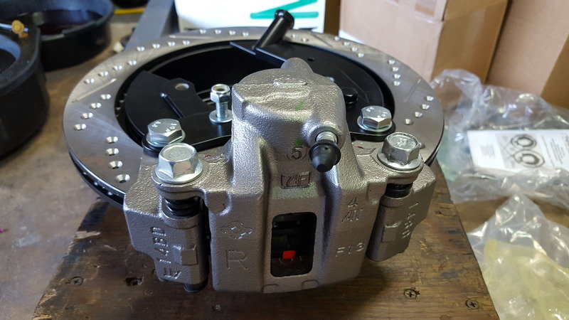

    A teaser.

    Not to complicate things but new trucks are starting to use air disc brakes lol

    For the rear?

    You're just bragging now. :p
    Most of us would never need that level of braking.

    Correct. All of the other pictures are near the end of my build thread.
