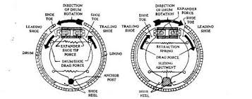

    The Tacoma and many other vehicles use a "simplex" (also known as a "lead follow" setup) style drum brake. As you can see in the image below the shoe that is leading in the same direction as the trucks motion (fwd shoe, fwd direction or rear shoe, reverse direction) will have more force applied to it. Hence why the fwd shoe will wear out sooner than the rear shoe and why the shoe liner tends to wear in a wedge shape. This is likely why it locks up while moving forward and applying the parking brake. What it is doing is touching the fwd shoe to the drum and essentially wedging itself in, like a cam roller lock that allows movement one way but not the other.
    In your situation you should ALWAYS apply the brakes when activating or deactivating your parking brake. Also while parking, come to a full stop, put it in park with your foot still on the brakes, apply the parking brake and then let go of the brakes. This will relieve stress on the parking brake cable when deactivating the parking brakes which will help alot. There is no set way the parking brake "should" work while moving, so thats a mute point. Vehicles with rear discs and parking brakes should not be used while moving. If it is a drum inside the rotor style parking brake (the shoe liner is maybe 1mm thick) it will disintegrate the shoe upon application and the ones that use the pads just do not provide much clamping force, just enough to hold the vehicle while not moving generally. Hence why many cars now have electronic parking brakes that cannot be activated while the vehicle is moving.
    In your case, you probably have a lot of brake dust build up inside the drum and need to clean it out. You may have to loosen the adjuster before removing the drum if there is a rust lip on the inside of the drum where the shoe does not contact. While you are in there you should lube the contact surfaces (3 per shoe) of the backing plate where the shoe rest as well as taking some sand paper and sanding the shoe lightly to remove the glazing on the shoe. DO NOT get the brake grease on the brake shoe lining, if you do, just spray with brake cleaner and wipe with a shop towel. I would suggest at least 2 cans of brake cleaner, 3 to be safe, one can per side. After cleaning, reinstall the drum, put the wheel/tire back on, tighten the adjuster while spinning the tire until you hear it just starting to make contact (usually like a faint scratch), lower the truck go for a drive and find a spot that you can get up to some speed in reverse. Next you will get up to maybe 10mph in reverse and SLAM on the brakes! You will/should lock up the front tires when doing this. Do this a few times. What you are doing is using the "self adjusting function" to adjust the shoes out to the correct amount. You should do this last step every once in a while to keep them adjusted correctly, maybe every 3-6 months or so. You'll notice after doing this that the brake pedal engagement point will be higher after performing this too as you are not having to push the shoes as far to make contact with the drum, which means you moving less fluid to engage all the brakes on the vehicle. If your curious how much of a difference that last step makes a difference, try it before doing the cleaning or on an older car with drum brakes that you know hasn't been serviced in a while. It's pretty crazy how much it can make pedal travel shorter and remove the spungy feeling.
