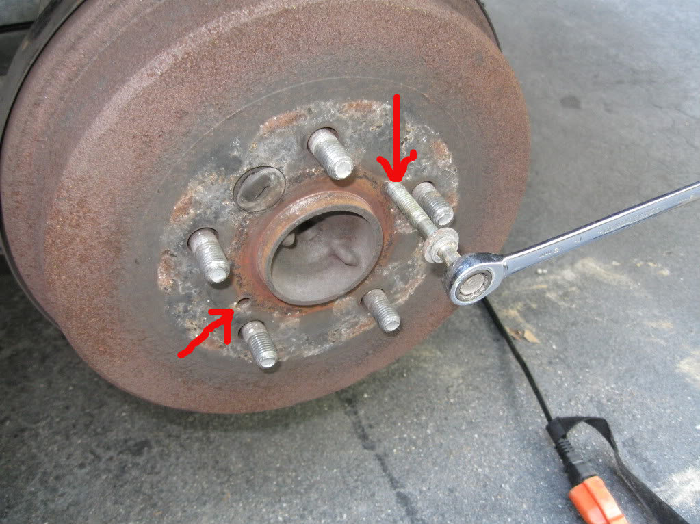

    other than spraying some penetrating oil around the flange and stud holes and giving a good beatdown, screwing a bolt into the threaded holes against the flange is all i know to do. and i have no idea what size/pitch those holes are.

    Try this....

    99% of the time they are stuck to the hub if you can't move it at all the breaks are not holding it. Once it's free and you can't get it off then you may have to back the breaks off. The 8MM bolt in the drum often works.
