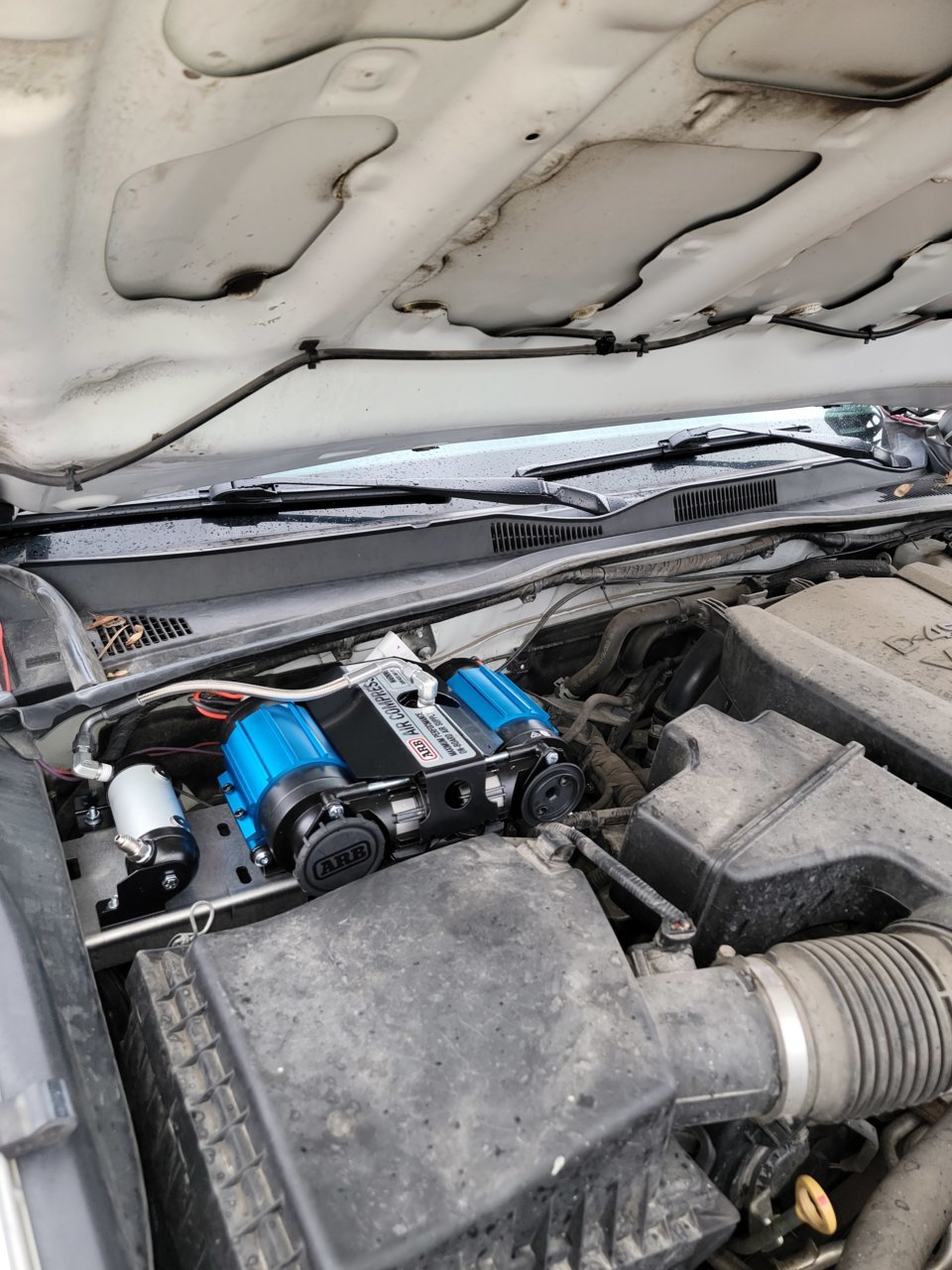

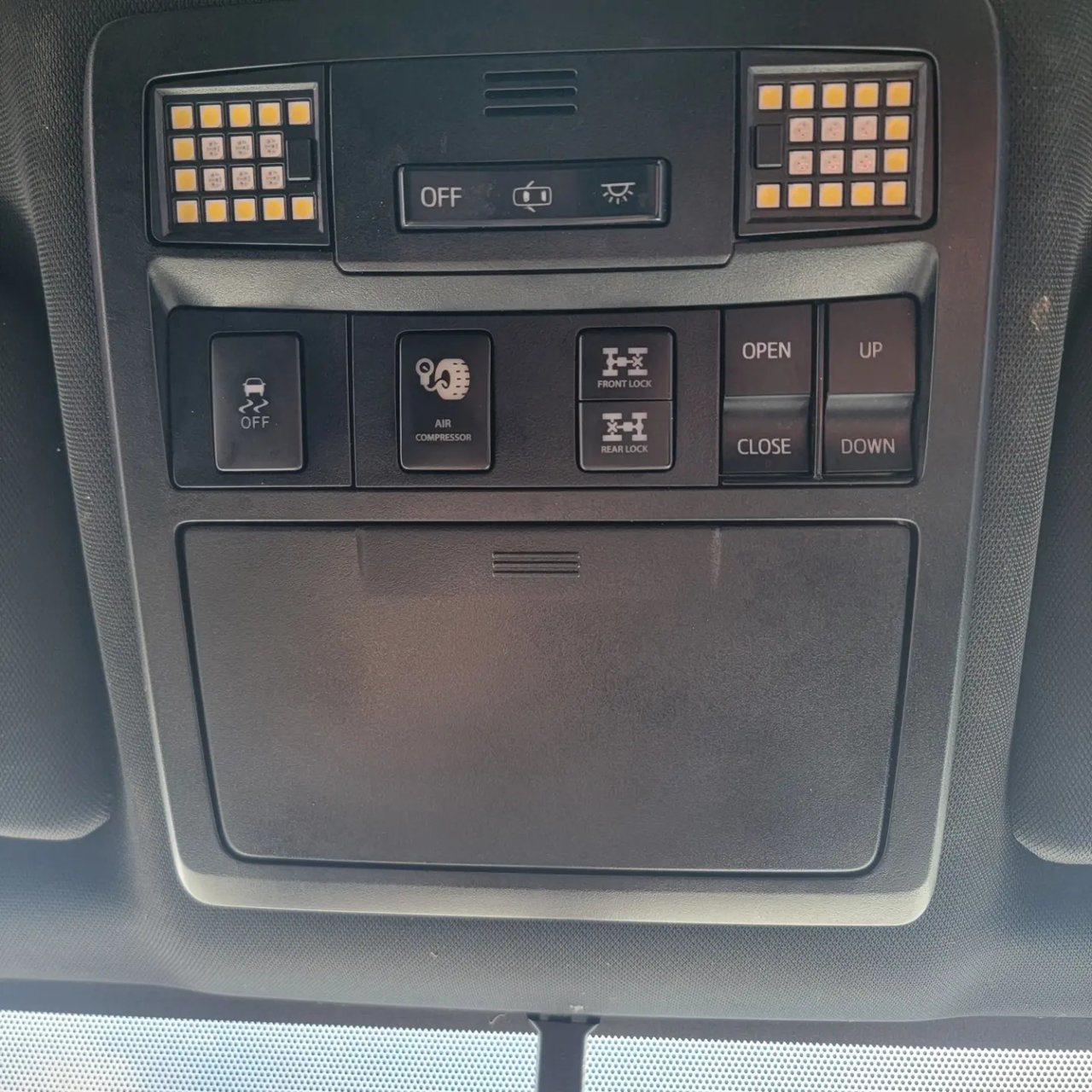

    As far as tricking the 4wd ecu. In ARB's instruction manual tells you too simply splice the electromagnet circuit to keep the 4wd ecu thinking the e locker circuit is complete. The other sensor in the diff is the position sensor for the locker. I've yet to test but I'm thinking as long as you are not commanding the computer to lock the diff it will never look for position.
    You could in theory build a circuit to keep the locker on. However it needs to be pulse width modulated to not over heat the unit. However it would not help the unit lock any faster.
    Some seal failures are caused by lack of maintenance and improper set up. Water intrusion, blocked vents, etc play a factor too.

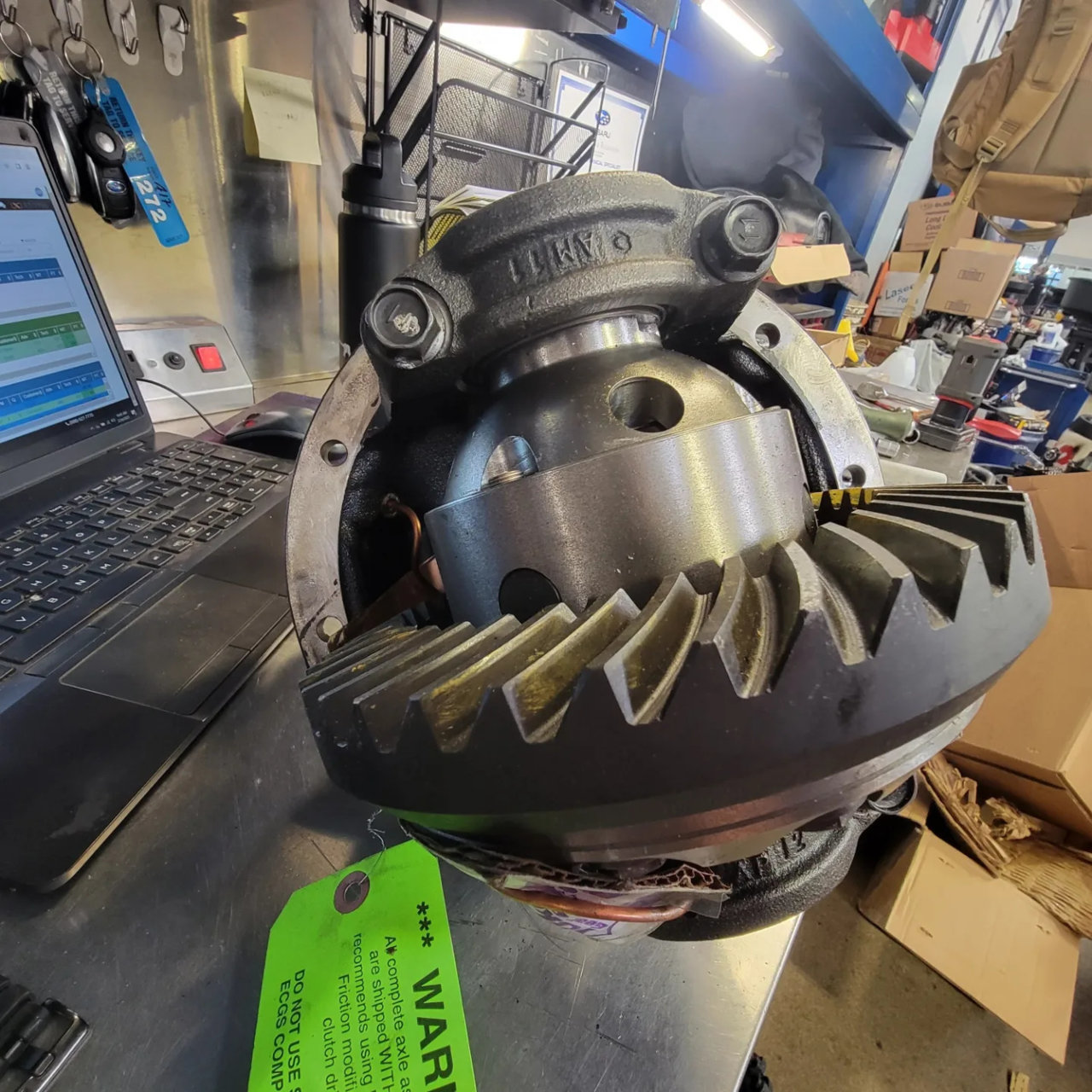

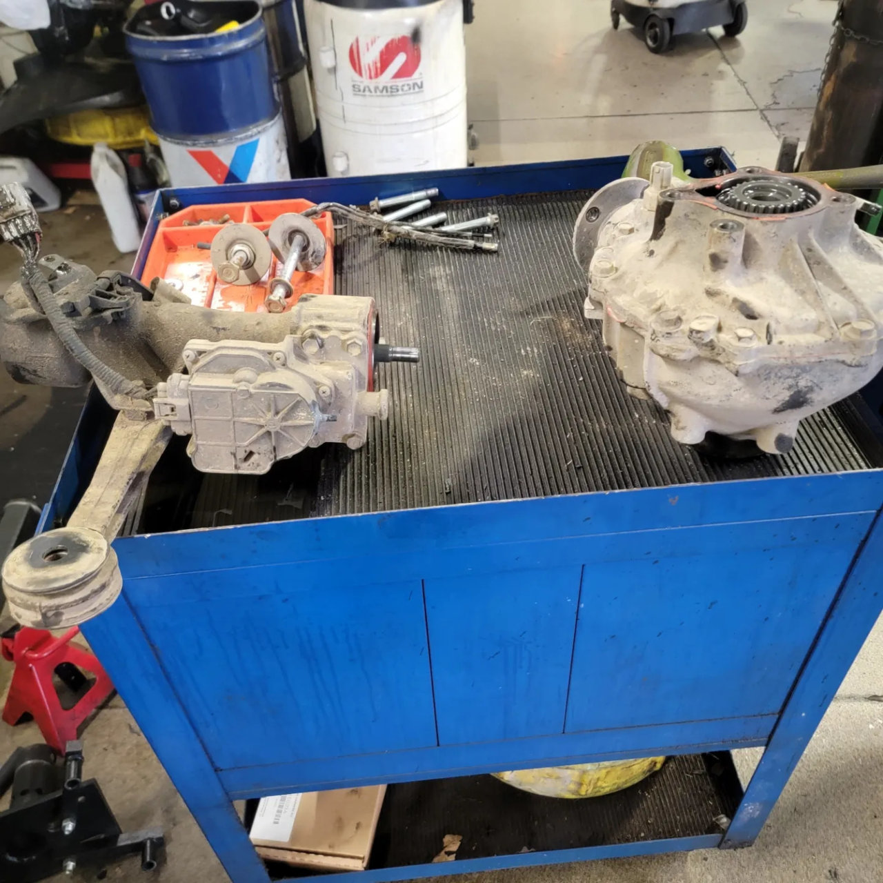

    Yea, the stock locker may always work, I can't rely on it coming on when I need it to. Which really makes it unreliable IMO for my use/truck.
    Anyways, got the gears and lockers installed. Not too hard of a job. Everything works great in dirt parking lot testing, and the 5.29's are great. The only thing needed to trick the 4wd ecu is to splice the OEM rear locker wires together. The position sensor can just leaved unplugged. Easy.IMG_20230301_124235_339.jpg IMG_20230301_124235_397.jpg IMG_20230301_124235_439.jpg IMG_20230301_124235_475.jpg 20230105_122337.jpg
