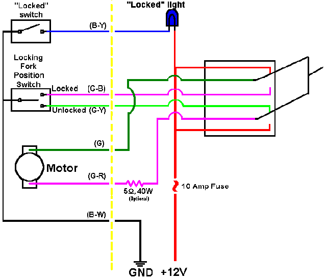

  11. Aug 3, 2014 at 4:07 PM
    #51
    cmj
    cmj Well-Known Member
    Jun 21, 2011
    #58636
    923
    Tucson
    98 Tacoma 4x4
    I just swapped one in. Tested it out this weekend and it was great!
    I did not use the control box found in a factory installation. I used a momentary DPDT switch with no relays.
