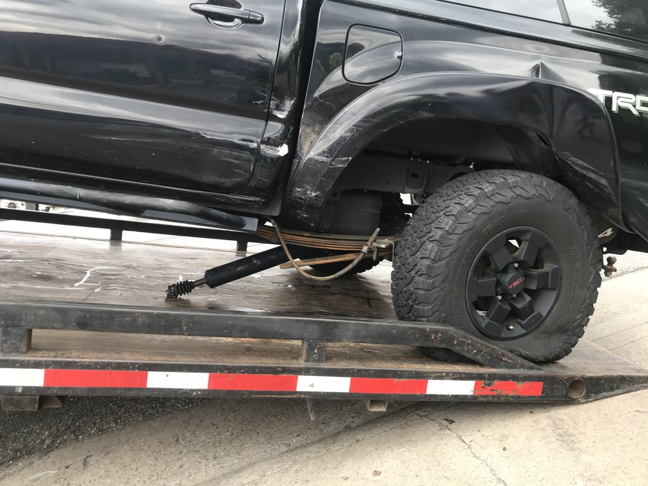

    My 2015 Sport was involved in an accident 2 years ago. I was hit right in front of driverside rear tire and it broke the leaf spring and separated driveshaft.
    The repair shop replaced the entire rear suspension (new Old Man Emu shocks/leafs), driveshaft, rear axle housing (used part), and supposedly straightened a bent spring hanger.
