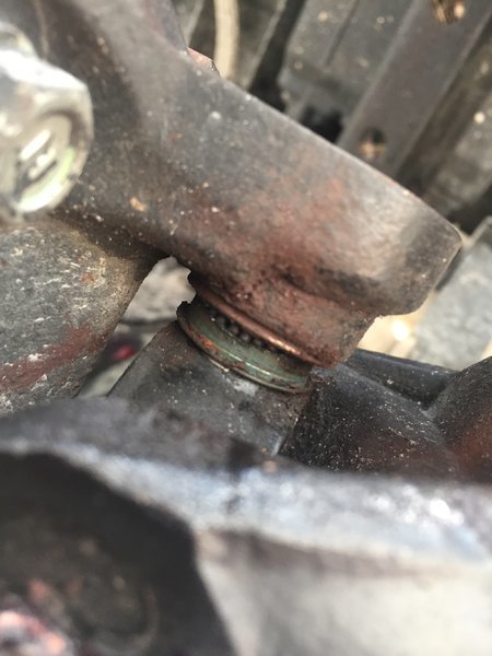

    I have a clicking sound coming from my rear end. I've tried to search but couldn't find much.
    It seems to happen when I'm slowing down and applying the brakes. Especially when in reverse.
    I thinks it sounds like it's coming from the drum area but I'm not sure. I just greased all the driveshaft zerks. Topped off diff fluid.... I do have some slack in the driveshaft and carrier but nothing that hasn't been there for thousands of miles.
    I tried to get a decent video hanging out the door. Any insight would be appreciated.

    Sounds like you have a Aussie locker, thats what mine sounds like lol

    Bleeder for rear brakes leave it alone

    This is text book U-joint failure (or pending)

    ^^^ I think the same, Universal Joint.

    You guys think my U-joint is shot???

    That's what it sounds like to me. But hard to pin down when it's not in person. Good news, it's a relatively cheap fix.

    Some ting wong!
    I see something peeping out. Like the needle bearings.

    They just want to say heyyyyy. Poor lil guys
