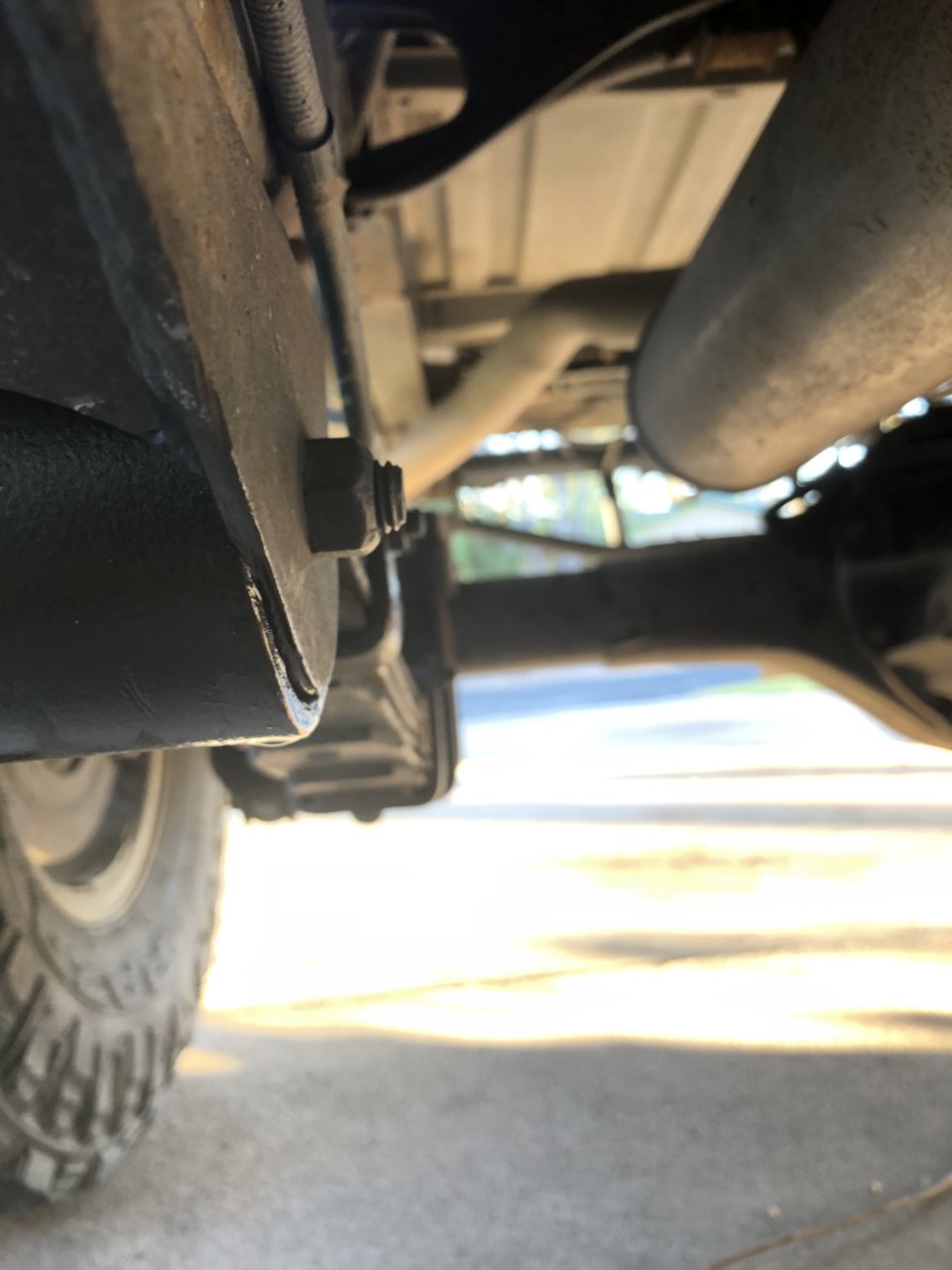

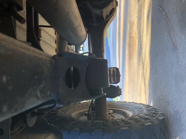

    It’s a rattle more than a clunk. Seriously sounds like it’s coming from the rear seat pans area. But I did find this..... see photos
    it seems as though at some point I bent my leaf mounts and now the leafs are rubbing on the mounts. If the bushings are shot, which I assume they are if it’s moved that far over this is likely my vibration rattle.
    Shook around everything I could locate and nothing is loose.
