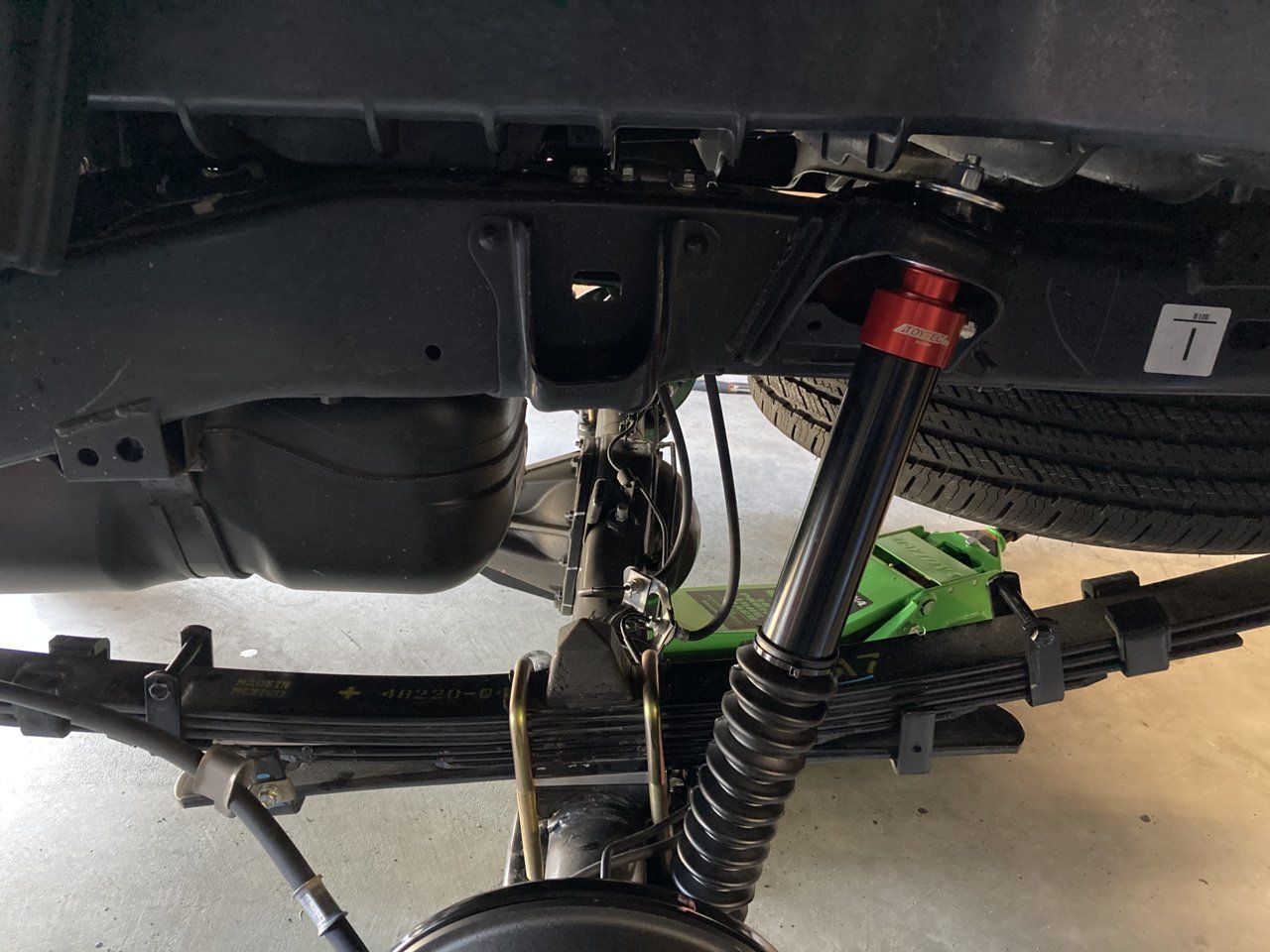

    Installed the toytec alumaseries full lift including Deaver 3leaf AAL and I left the overload left in. (Due to getting a canopy in the near future) including new rear shocks that came w the kit.
    I’ve installed many lifts before (including this exact same one, am very mechanically inclined, use to be a Toyota tech, I currently am a welder fabricator, and understand how shit works.
    Anytime I go over a small quick bump, speed bump, driving thru the neighborhood with small bumps, or even to the grocery store with normalish bumps in the road… I get a clunk/rattle in the rear end. It is worse on the right side. But both sides do it.
    Since install, I’ve checked the torque on everything 4 times.
    I have removed the spare, no change.
    Tightened up some loose fender well plastic, no change.
    Loaded a set of my factory wheels/tires in the bed, maaaaaybe a slight change…
    (I did not remove the entire leaf, I installed the aal in place with clamps)
    It almost sounds as if it’s something on the truck rattling (rather then directly on the suspension components) due to the stiffer ride.
    I have the aal shims installed that come with the kit. I do not have a CB spacer, and it drives perfect with no vibrations anywhere.
    WTF?!
    side note: at freeway speeds, the sound seems to be gone when hitting bumps…
    side note 2: yes I’ve searched everywhere on TW to find the answer. Can’t find anything

    Is this picture taken with the truck's weight on the rear suspension or at full droop? Just wondering if the sound is the shocks going to full extension driving over bumps.

    I will pull overload out, and see what happens. Shocks are meant for this lift, so they have plenty of travel.

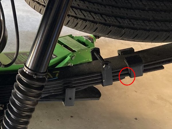

    ^Put the tires on, then jack up the axle one side at a time. How close does the rear tip of the AAL get to the OEM keeper bracket?
    Also check the AAL front keeper bracket bolt tip isn't hitting the fuel tank strap on the driver's side.

    They both clear front and back from the oem bracket. And nothing hittin fuel tank strap

    Take a look at the rivet holding the bracket on the overload leaf. When i first installed my AAL keeping the overload, that rivet would chatter a bit on bumps against the lower leaf, mostly at low speed. Eventually it flexed the overload ends a bit and stopped making noise.

    Shock mounted properly? No slop in the upper or lower bushings?

    Shock mounted properly.
    Even with shocks removed, still makes clunk.

    On the pic of your rear shock, it look like the little silver “button” thing on the upper collar (I’m guessing it’s a port to recharge the shock??) could be hitting the upper mount.

    the silver button is not touching anything.
