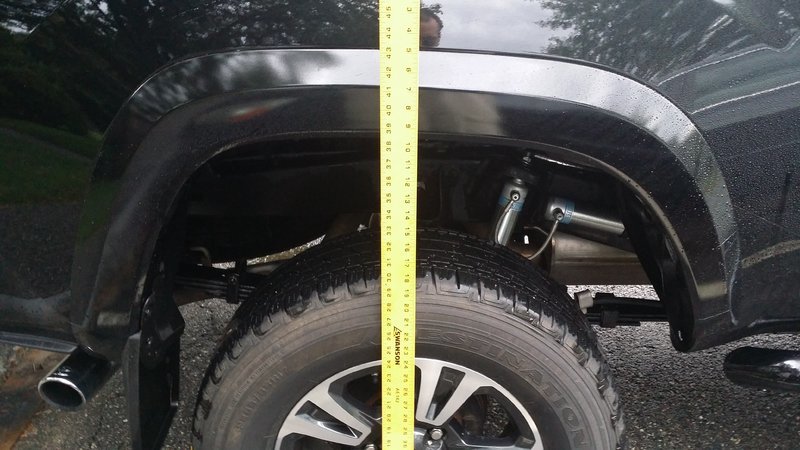

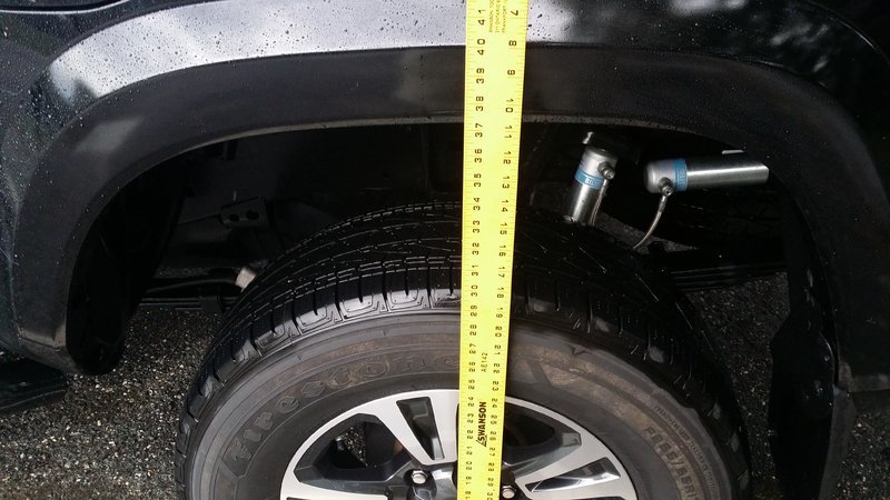

    Whats slight though? Was slight but lift definitely made it much worse. Im off 1.25" side to side without my fatass in it. Which is noticable...

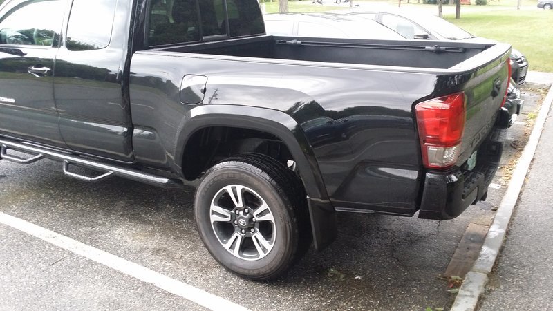

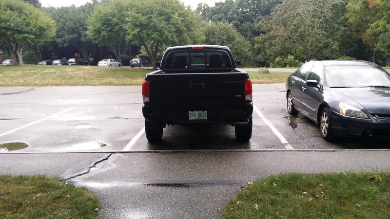

    This is not slight:
    This is 'slight':
    Admittedly it's hard to capture the Taco Lean in a photo - especially when it's raining. LOL

    I figure if my 67 year old mom noticed it and asked what was wrong with my truck, it isnt slight. She hasnt noticed i lifted it 4 months ago so yeah...
    20160914_180656.jpg 20160914_180709.jpg 20160914_180725.jpg 20160914_181039.jpg 20160914_181116.jpg
