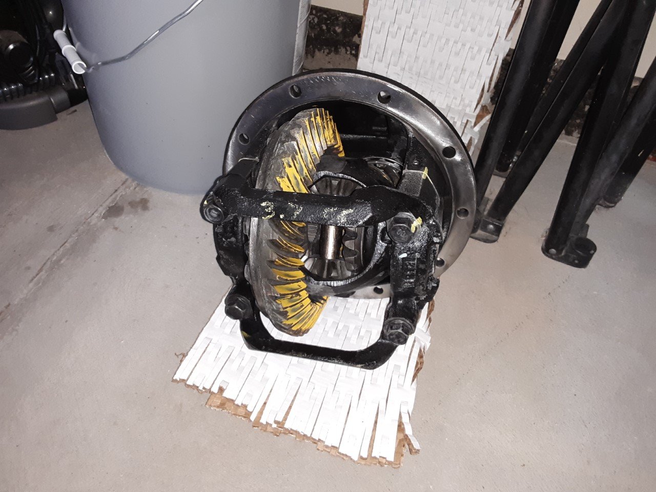

    heres the new one from ECGS....currently living in my rear axle & waiting to go for a spin
    (plan to test drive around noon tomorrow after I finish the rear brake reassembly)

    first off - thanks to US marine & ECGS for help/replacement 3rd
    buttoned up the rear end/rear brakes this morning
    (if I did not mention it before, drum brakes are dumb)
    went for a test spin & NO MORE HOWL at 60mph decel/no howl with cruise control at 60mph
    problem solved !!!
    went around the block 14 times for this one, but now I have won the game of patience
    & hopefully this thread can help others dealing with rear diff 'HOWL'

    I tried many things to isolate the howl, but in the end, removing the rear driveshaft, putting it in 4hi & going for a test drive gave me the results I was looking for.....no howl with rear end disconnected from the drive train (this made me confident it was the rear diff)
    I then pulled the trigger on the ECGS unit, swapped out my 'howler' diff, & as the title states 'ISSUE SOLVED"!
    I damn near did a back flip once the howl was gone
    sooooo nice driving without that annoying, possibly catastrophic noise

    best way to assess the matter
    & its a trip FWDing the taco!
    be easy on her & dont do anything nuts while in FWD mode :) haha
    if you lift the truck & listen it changes the dynamics as there is no load
    & you may not hear anything with a scope unless its really bad
    my carrier assembly looked fine on visual inspection, but there was something def wrong (worn pinion race or maybe the preload was a hair off)
    good luck on your noise hunt fellow taco fan
