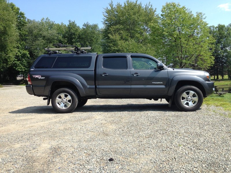

    My set up is fairly minor in lift also. Wanted to stay close to stock but account for the sag with cap and bed mat on a lb. I went with 5100s' set at .85 in front, and out back I got a set of tsb springs and added a 1.5" Wheelers' progressive aal. No overload. Ride is very comfortable.

    yea this what i,m after. nice looking truck i must say.
