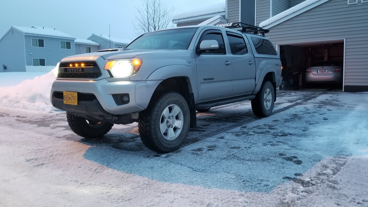

    So I forgot to get a picture of the back (I know I know. I'll get one later), but here's how it sits now. Love it! @wobble

    Ridgefield, WA
    2014 TRD OR
    Modified RCD Lift, 315/70R17 STT Pros
    Looks good!
    nazlax10[OP] likes this.
