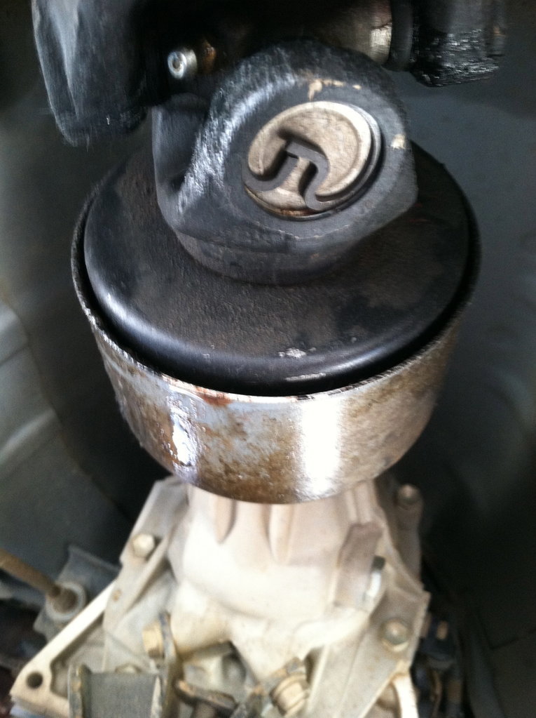

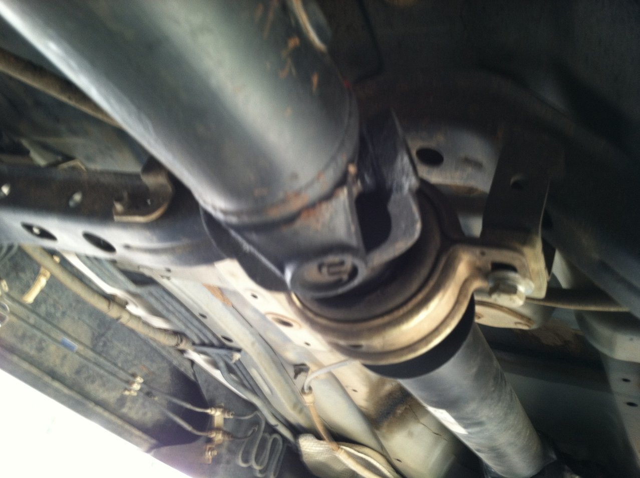

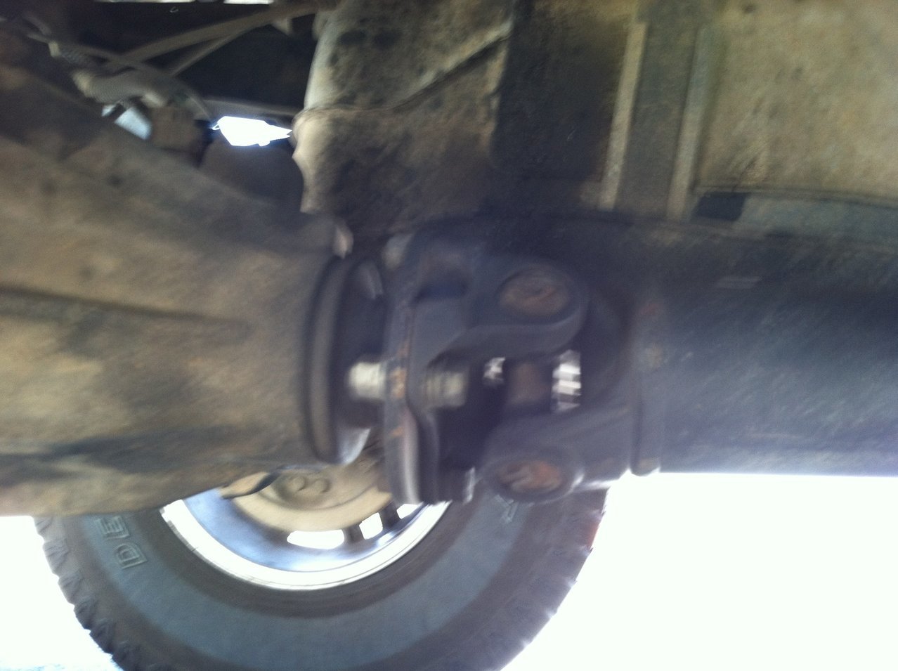

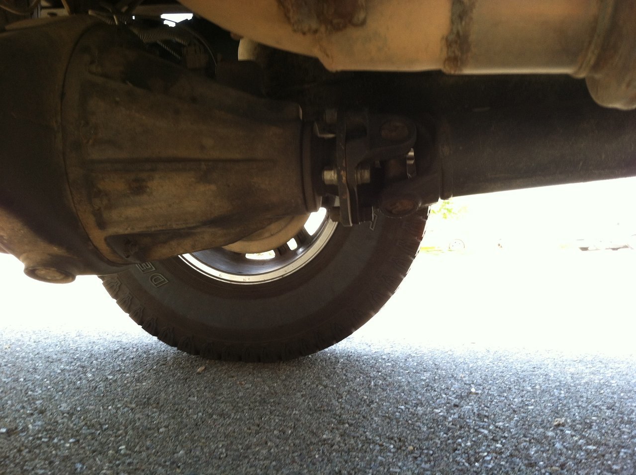

    Hey guys so I was under the truck checking out some things and I saw that my yoke joint was leaking some tranny fuild. I did the flush maybe a year or so ago but the U Joints all have less than a year on them. I dont know if this is normal or what. Heres so shots of my angles and carrier bearing as well
    IMG_1253_4d1cd5bc848728aeb26a06bb12e482d68b55265f.jpgIMG_1252_3e3cd805378b7c84ddc99bd5ed4f6a88bff2c0ef.jpgIMG_1254_6c257cc7ab29c009b2d90a3efc2aa07245bc1c06.jpg
  15. May 9, 2012 at 1:33 PM
    Jerez
    Jerez SoCal LED Dash Swap
    Feb 1, 2010
    #30488
    17,074
    Rod
    Diamond Bar, CA
    08 TRD Sport
    Estock
    mine has a humming/like spinning noise when coasting...
    i think i might need new u-joints...and i bought another carrier barring as well
    and thats alot of tranny fluid if its leaking...mines leaking a super small drop tho :eek:
  16. May 9, 2012 at 1:41 PM
