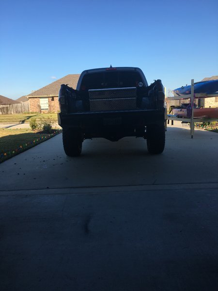

    Like this? If do you need this...
    JTD408[OP] likes this.

    Yeah exactly like that. And the distant between top of tire to top of wheel on drivers side compared to passenger side is very noticeable
