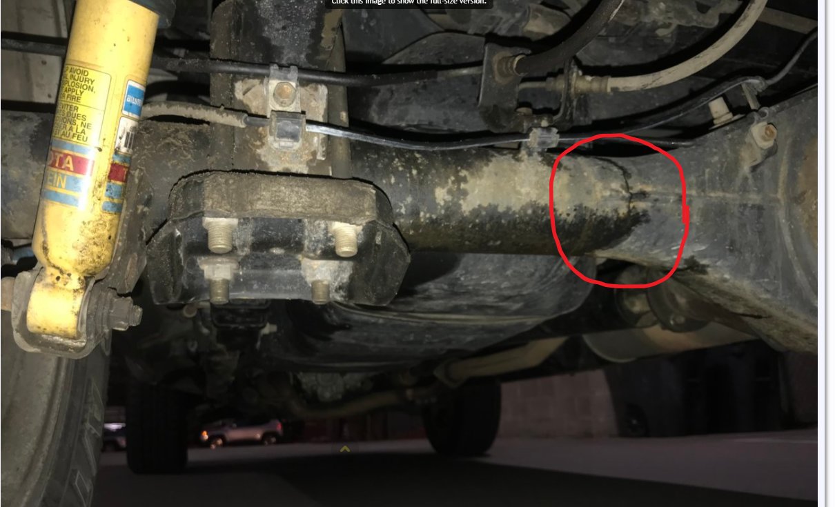

    Is this a crack ??
    wi_taco likes this.

    good eye, I really hope not. I’ll check ASAP though. I’ve heard it could also be an axle seal burst. Seems like there are 10-20 possibilities as to what could be wrong

    Checked, and that is not a crack. Thank god
    Jerry311SD[QUOTED] likes this.
