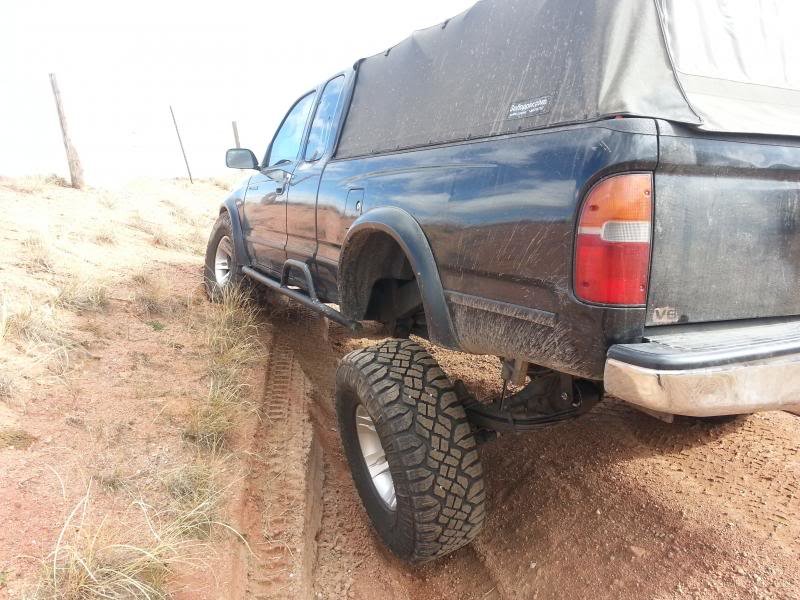

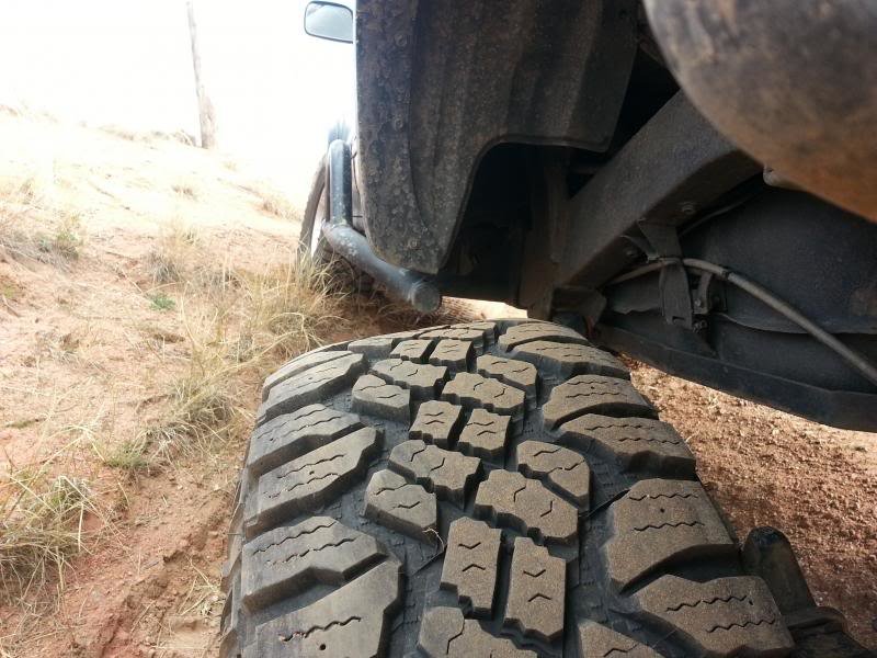

    Toytec 16" coilovers with Tundra Bilstein 5100s, Light Racing UCAs, Alcan Leafs with Orbit Eyes, 12" Bilstein 7100 short Bodies, ARB rear locker, 33x12.5 Duratracs, CBI sliders, Bushwacker fender flares, self made front bumper, M8000, Vision X 6.7" Hi/Lo Beam HIDs, full skids, Inchworm dual case setup - 15º clocking
    For what it's worth, you can fit 12" travel 7100 short bodies under your bed, in the stock locations. They are 16" collapsed and 28" extended.
    See my thread over here: Since I posted over on ttora, I've gone with longer shackles, which have netted me more droop and the longer shocks are great for that:
    Clearing my slider:
    I've been very happy with the 7100s. Check out my build thread for more detailed information.
