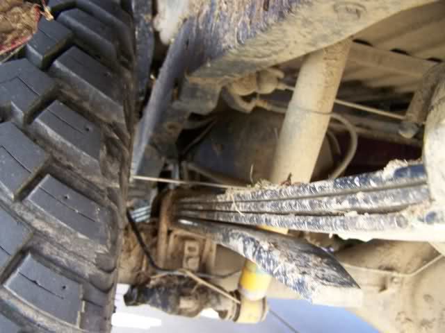

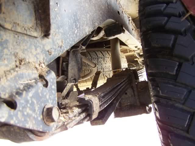

    I greased the u joints and it didn't seem to help. Do ya'll think it's the leaf springs? Do yoiu want me to post a pic of them?

    Go ahead and post a pic.

  13. Nov 28, 2010 at 12:34 PM

    Yeah, they're definitely frowning. They should curve upwards, not down.
    I'm pretty sure you're axle wrapping.

    Im a mechanic by trade, those springs are most definately shot. if they were working, they would curve down, yours have curved upward and look dangerously close to snapping! Replace em and your truck will definately thank you for it.
