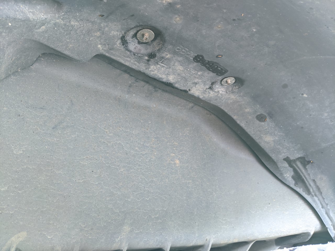

    Hey, Folks.
    After probably my second off road run with washboard climbs a couple years ago, I would get a squeak from the rear. I found that it was the push fasteners in the top of the rear wheel wells coming slightly loose. Pushing them in again would clear it up for a week or so, depending. The right side was most often found loose.
    The other day, I swapped in SS 8-32 x 5/8in socket head screws, SS 7/8in fender washers, and mating wellnuts. The squeak is gone, similar to re-seating the push fasteners.
    The metric wellnuts that I had for my bike were one size too big and Ace didn't have metric wellnuts. I don't like mixing SAE and Metric fasteners, but I should never have to touch these again.
    The wellnuts were tight to get in. I used some grease and wobbling pressure to get them through the upper side which seems to be a molded flange off of the bed.
    I am not sure if this will help anyone, but I thought that I would toss it out there.
    Have a good one.

  6. May 16, 2020 at 9:29 AM
    tonered
    tonered [OP] bartheloni
    Sep 25, 2017
    #231055
    31,081
    tony
    Lynnwood, WA
    Post mod pic added to the 1st Post.
