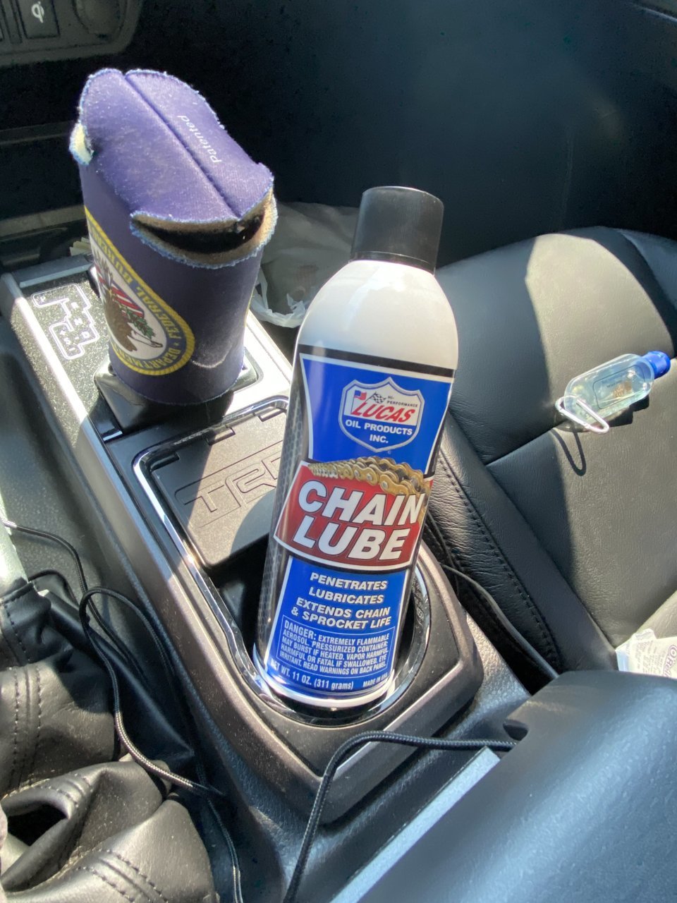

    Let’s give it a try.
    diabetiktaco[QUOTED] likes this.
