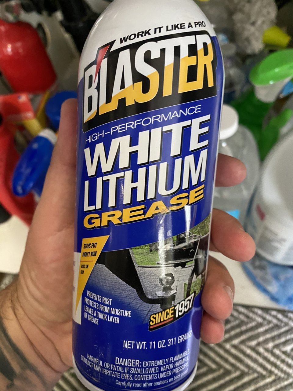

    Here is the answer. I tried everything for weeks... even had a thread on it. . Nothing worked...
    then my dad heard me bitching when I was visiting and showed me this. Sprayed my truck months ago, and to the day I sold the truck... no squeak.

    Okay, removed the spare completely and drove down the road and heard the squeak. Jacked the rear end up and pressure washed the leaf springs good and sprayed white lithium grease on all the joints of the leaf springs and it still squeaks. While it was wet from being pressure washed there was no squeaking. I'm going to lift the rear and spray the leafs with the bar and chain oil nest and i guess go to the long process and start wetting every spot individually and try to locate the squeak that way.
