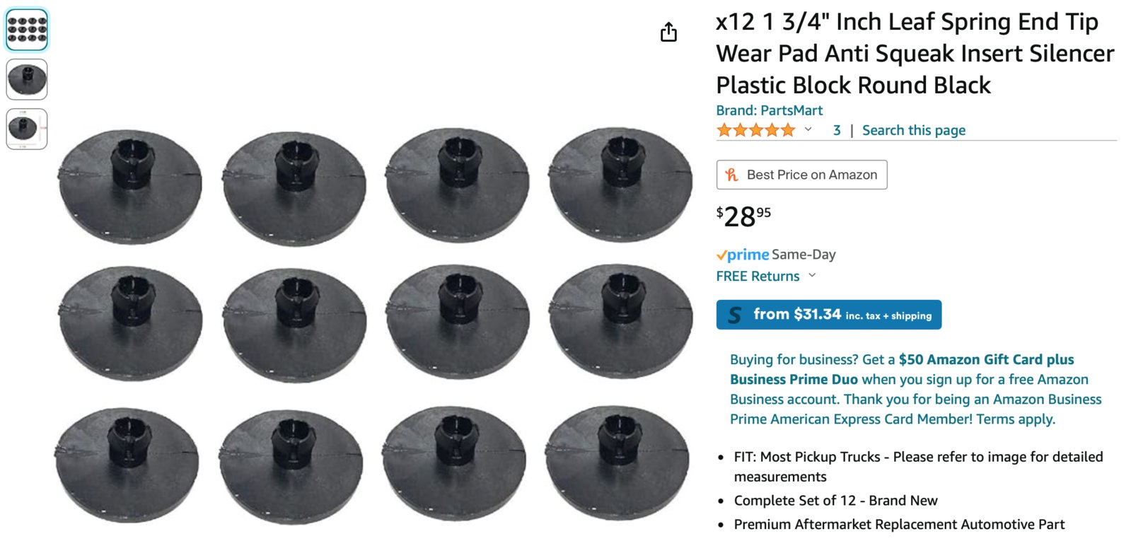

    These have worked the best for me. They are a little ticker than the pads that come with the leafs, well at least the OME Leafs. Jack up the truck from the hitch as high as you can so the leafs get the most drop possible. This will spread them out and allow you to remove the old ones and replace with these. You'll need a couple of pry bars for extra motivation. Added some Red Tacky grease between the leafs. Worked very well.
    https://amzn.to/3JebZGk
