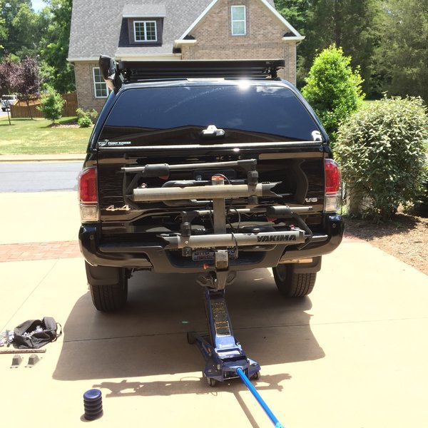

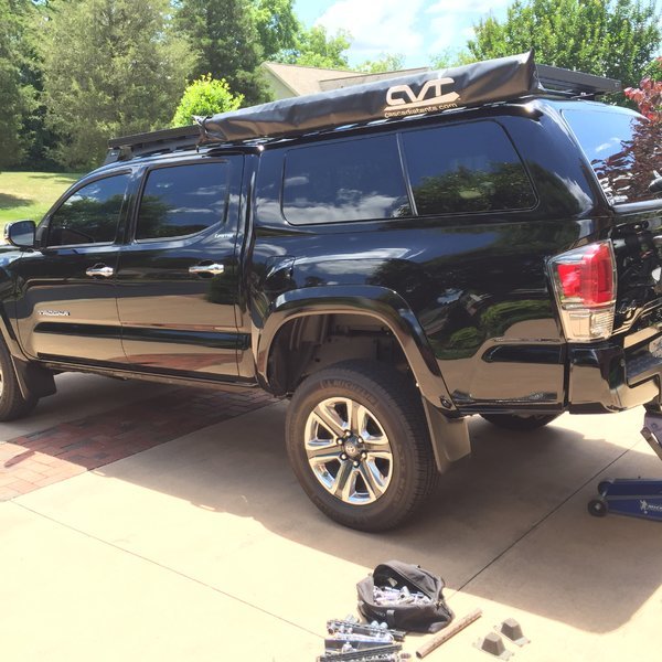

    They're excellent. My before numbers in back were 35" and 35.5". After were 35-7/8" and 36.25". Rides like stock especially with the weight I'm carrying.
    Install: climb under and loosen one sides u-bolts. Remove the stock bump stop and install the sumo plate. Tighten the u-bolts. Do the other side. Chock the front wheels and take a floor jack and jack up the rear under the hitch. Thread on the sumo bumps. Took all of 15 minutes and never removed the wheels.
