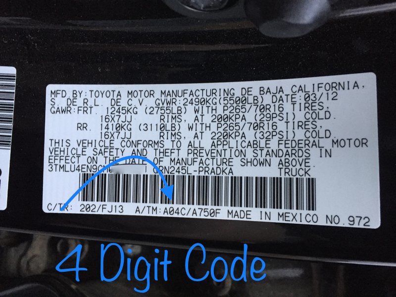

    #s on driver side door post
    Or
    Add your VIN# at ToyotaOwners.com for build specs.

    Says my diff is an open diff. If gear ratios and everything else we the same could you put a diff with limited slip in without having to change anything else out?

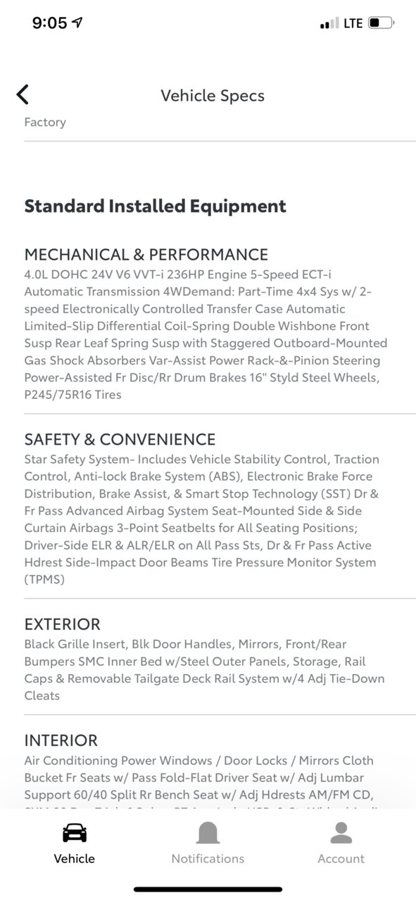

    When I go by what the door jam says it says mine is open, but when I type my vin number in in Toyota app it says my diff is limited slip

    Toyota app with my vin says mine has limited slip
    by the vin number on Toyota’s app it says mine is limited slip

    It just says automatic limited slip

    Yes, in your case Limited Slip has nothing to do with the Differential.
    It has everything to do with the BRAKES.
    In the Pre-09’ trucks you used clutch packs INSIDE the differential.
    In the 09+ trucks the they used the brakes on the OUTSIDE of the differential to “Limit Slip”
    Why replace clutch packs when brakes are easier and cheaper?
    How it works
    https://www.tacomaworld.com/threads/trd-sport-lsd-questions.565436/#post-18571958
