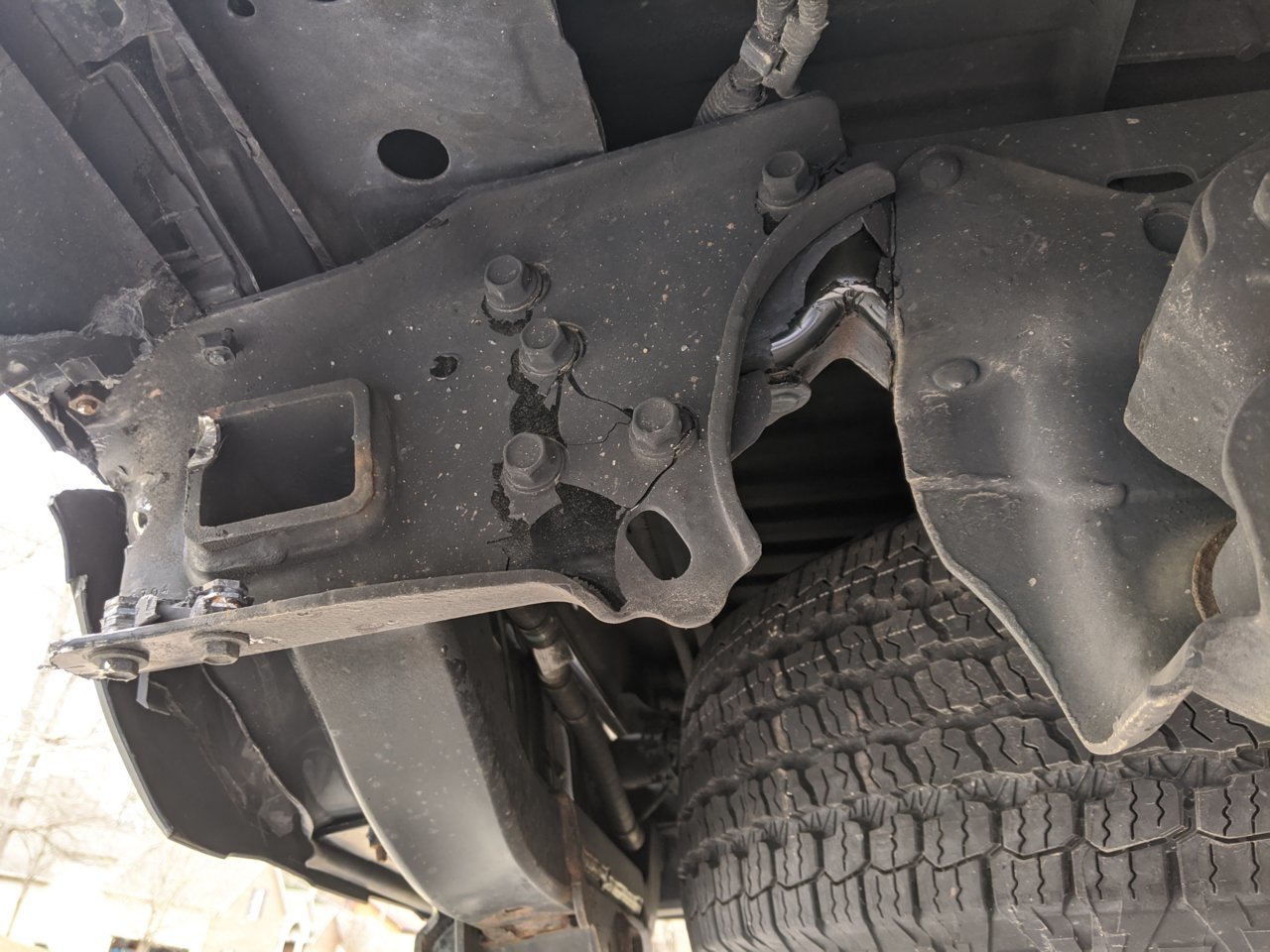

    Got in a 3 vehicle wreck this morning. An F250 carrying a 26ft toy hauler rear ended me and pushed me into a Kia. Could have been a lot worse...
    I'm far from a mechanic and while I wait for an estimate wanted to get some feedback. The first pic is what I'm concerned about... It's the rear passenger side.

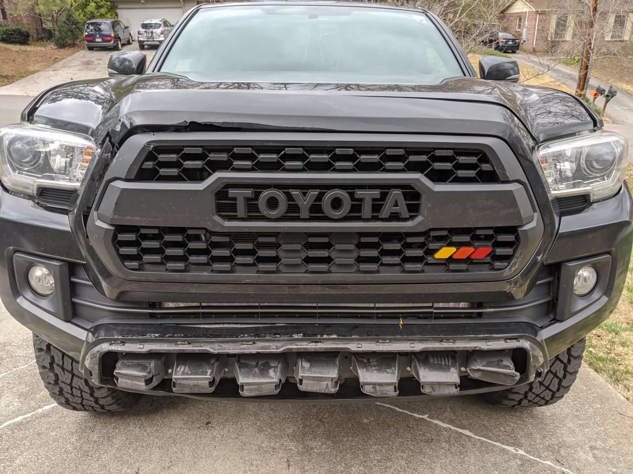

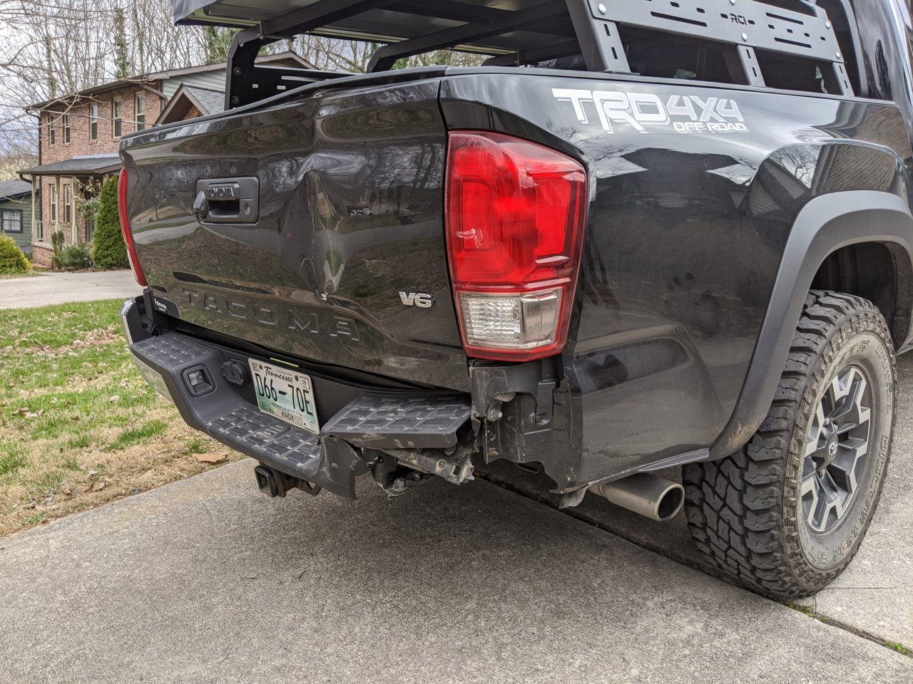

    Picture does not show how bad the hood is warped and the bed has obviously shifted a bit too.

    The frame is bent but because it's so far back I don't know if it'll be a cause to total. Curious what they find because the bed isn't square anymore and it pulls hard to the right.
    I came to a dead stop on interstate and he was still moving pretty good when he hit. Thankfully he swerved and didn't catch me square on.

    This is what happens when the vehicles involves hit bumper to bumper. The impact force is localized to the bumper mounting points, in this case the frame buckled in the crumple zones perfectly to absorb the impact. The front end has a bit more damage, but it looks like the majority was taken up by the front crash bar.
    If it would of be the other way around and the kia hit him from behind then he would not of been pushed into the car infront of him, but the kia would of lifted the back end of the truck up. The kia hood and core support would take a hit from the hitch and crumpled like a tin can. There would be damage to the spare tire and mounting for the tire along with some mild plastic damage to the rear bumper as the hood folds up into it.

    Can I really look at between $8-12k for the frame work alone? That's the range I've found when looking at other people that have had same kind of accident. Wasn't expecting or thinking this could be totaled but if that's the case with the frame I would come close to $16kish in repairs which I believe would total it in TN.

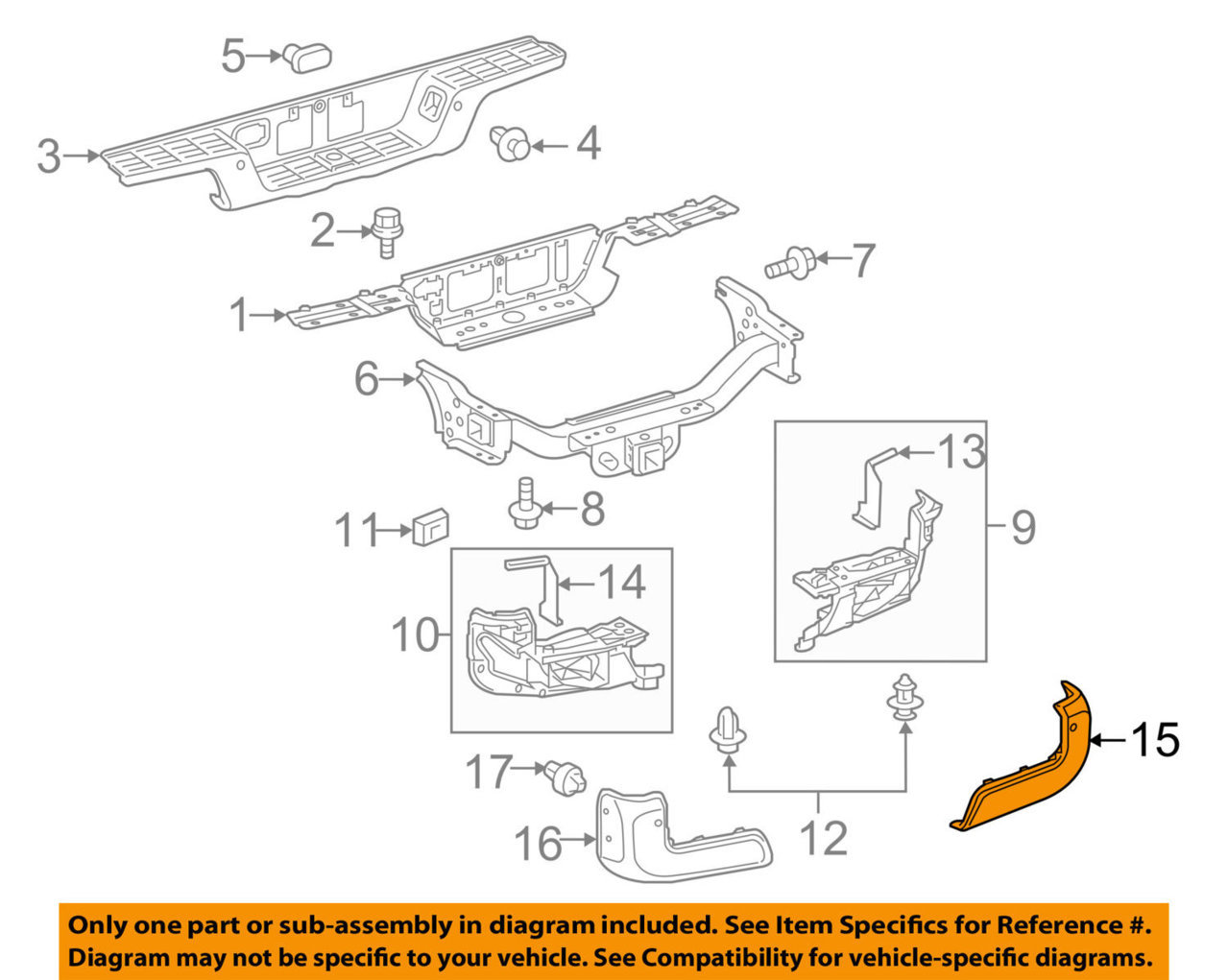

    Is your frame bent or just #6 hitch assembly in the below digraph?
    Clearwater Bill likes this.
  19. Mar 6, 2020 at 6:16 PM
    #19
    bhayes423
    bhayes423 [OP] Well-Known Member
    Oct 16, 2019
    #308149
    211
    Knoxville, TN
    It's actually my frame. The #6 hitch assembly shattered.. thought that was kind of weird instead of just bending.
