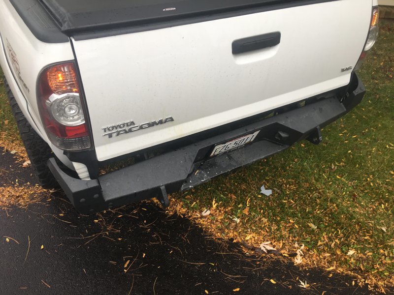

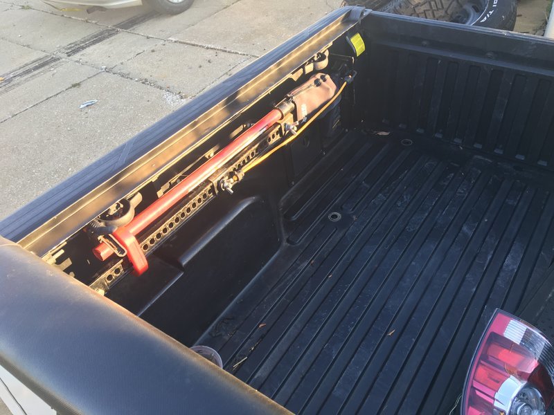

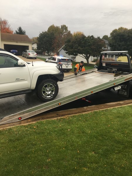

    October 26, 2016
    I had been driving about 6 hours that day, most in a rental for work and had dropped off my co-workers an hour earlier. This happened literally 30 seconds from home. I did see it coming as I was waiting to turn left, but cars were coming in the opposite direction so I just had to wait for impact. I did think to put the truck in neutral (automatic) to hopefully minimize damage to the transmission. No airbags deployed. I felt the jolt pretty hard, then pulled the truck off into the grass in my allotment. A lady at the intersection called police and they were there in minutes:
    I was checked out by an ambulance and had (have) lower back pain which is being treated. I went to see my doctor the next day. The kid that hit me was with a friend and don’t know if he was texting or just not paying attention. They both jumped out of their Civic because they thought it was on fire (his radiator was compromised and therefore steaming.) The first thing I did was take a picture of his driver license and insurance card. He was cited and I told the police about the dash cam video. Police said it was obvious what happened here so video was not necessary. The flatbed hauled my truck away to a body shop that I’m familiar with and know the owner well. Police helped me take my luggage and personal items out of the truck and gave me a ride to my house 100 yards down the road.
    Before I left, I checked out the truck:
    - 2” long scratch in the powder coat of the rear bumper
    - Pushed in rear bumper dented the bottom corners of the rear quarter panels

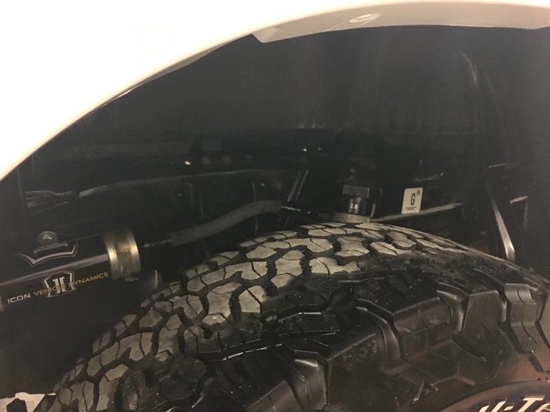

    - Bed is a little tilted when you look at it from the side. It does not line up vertically at the cab
    - The OEM tow package hitch is pushed in against the spare.
    - The tailgate won't open since the bed is flexed (?)

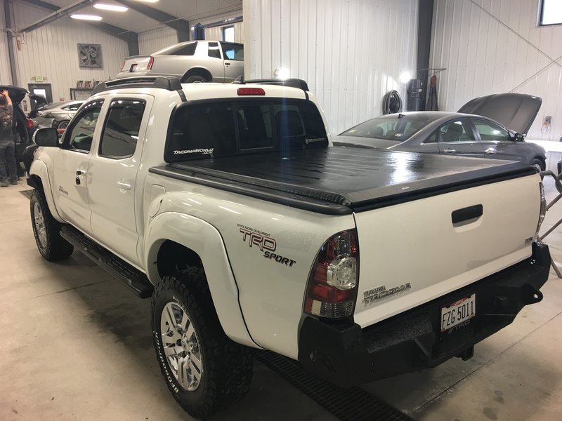

    The 3rd party insurance shows up at the body shop and gives an estimate (Supplement #1) based on no tear down. Supplement #1 $2,390.11
    October 29, 2016
    Frame gets measured to see how bad the damage is. It ended up not being able to go on the rack because it was so out of alignment, he could not get the the clamps on the rack to attach. Therefore, had to use a Tram Gauge to measure. It is bent near the rear bumper and twisted under the cab.

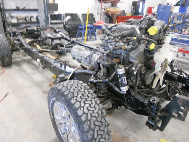

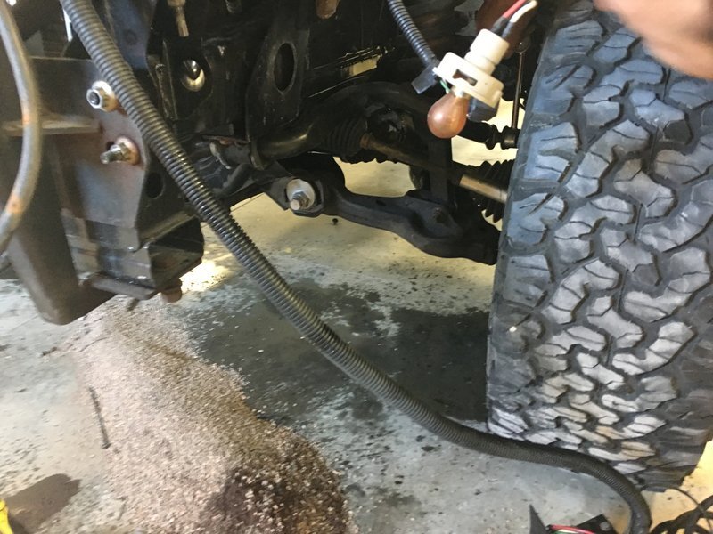

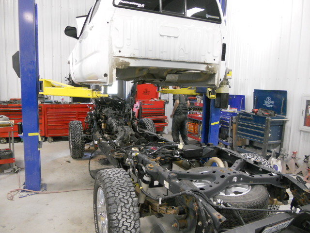

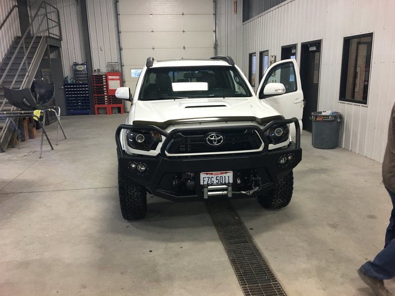

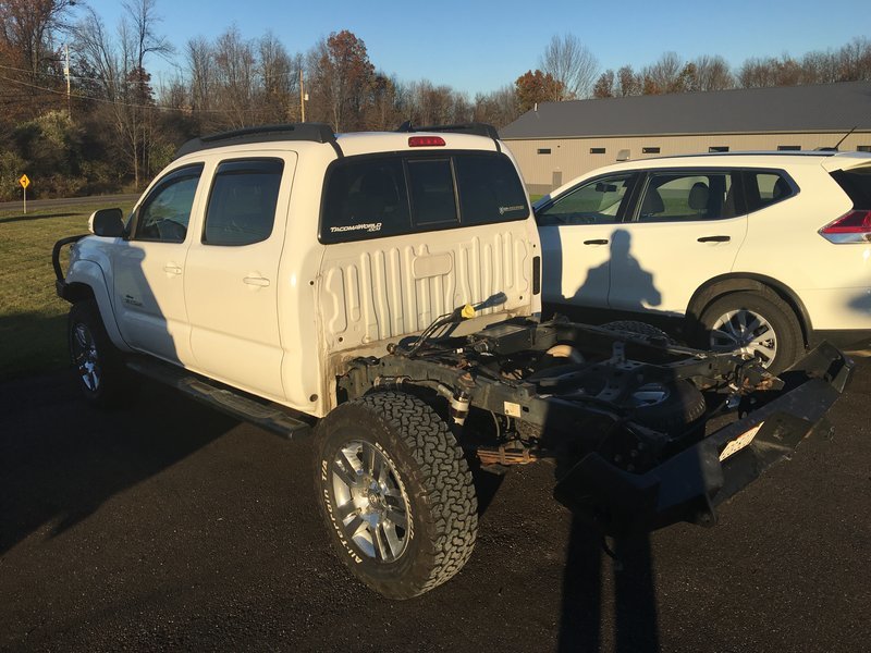

    The frame has arrived at the body shop…I left the office early to go see:
    I only did a little research but soon realized that the frames are no longer made by Dana after the lawsuit. This frame came from Mexico:

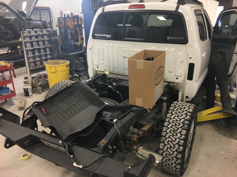

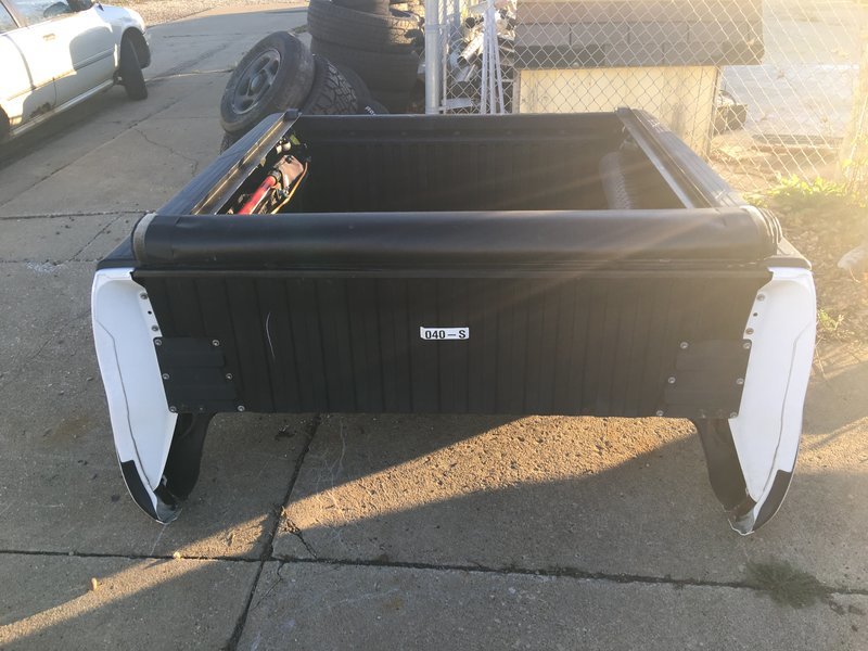

    Work soon began, mostly disassembling the truck. I kind of like the 70” lift!
    This bracket behind the grill for S/C components was rusty so they cleaned it up and coated it...was hard to source another.
    Out with the old front end components...
    Now that the frame is in, it will take several weeks to get everything done. It was not just a frame swap, it was body work too among other things.

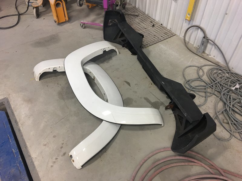

    “The Rear Bumper Debacle”
    From the beginning, I had a concern was about my rear bumper. From my understanding, you can’t “fix” powder coat – you have to re-powder coat. Plus, the bumper had surface rust on the inside. I wanted that fixed and fine if it were on my dime.
    The body shop called and said after taking the bumper off the frame, the passenger side mounting bracket was 10mm off. While it could be fixed with cold or hot working, I’m getting a new bumper.
    It is a Fab Fours bumper, but I did not order direct from them. I called a retailer and placed the order for a replacement. It will be there in 5-7 days. Five days later, the body shop calls and says the bumper is at FedEx, but it is too big and too heavy to deliver. What? I’ve got free shipping. The retailer messed up the delivery so I had to pay $50 to get it from FedEx depot to the body shop.
    When the bumper arrived, the box was beat up and taped, like it was previously sent to someone and returned. Upon inspection, there were two less than an inch long scrapes on the top in similar spots on each end:
    I called the retailer and filed a claim. Their customer service was frankly a pain. Just get me a new bumper, it is the only thing holding us up right now. After a lot of back and forth, a new flawless bumper arrived at the body shop’s door in about 5 days via a different carrier.
    I call back customer service and follow up on the RA. The RA was sent to the original carrier, FedEx (who would not deliver to the door originally, so why would they come this time?) Customer service said FedEx has two weeks to pick up the part otherwise you can “throw it out.” My response “Ok. Thank you very much. I appreciate the help. Bye now.” Seriously.
    It has been two weeks and no pick up. So, I now have two extra steel bumpers….they will go in TW FS section or Craigslist. I’m in NE Ohio if you are interested.
    Fab Fours great customer service

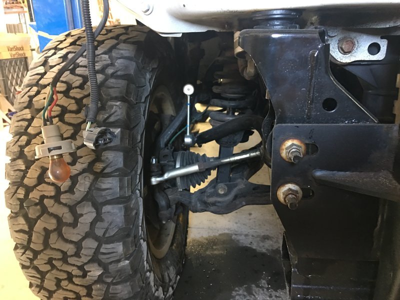

    During re-assembly, it was noticed that the passenger turn signal in the front steel bumper had corrosion on the connections and needed replaced. The body shop could not source the correct replacement. Upon calling Fab Fours, they immediately shipped out a replacement at no cost and don’t even need to send them a copy of original purchase invoice. That is great customer service!
    Here are all (I think) the things that were replaced or fixed:
    1) Got the frame plug kit! About $40 from Toyota dealers: Part #04002-07104
    2) Should I undercoat the whole frame since I’ve got the chance? End up not doing it because it already had a coating. I know, maybe not the best coating. If I keep it, it will get regularly oil spray or Fluid Film.
    3) Noted that my serpentine belt is getting worn, it will be replaced on my dime
    4) Full 4 wheel alignment
    5) Clock spring in steering wheel replaced
    6) Brakes bled and new fluid, checked out
    7) ATF fluid checked

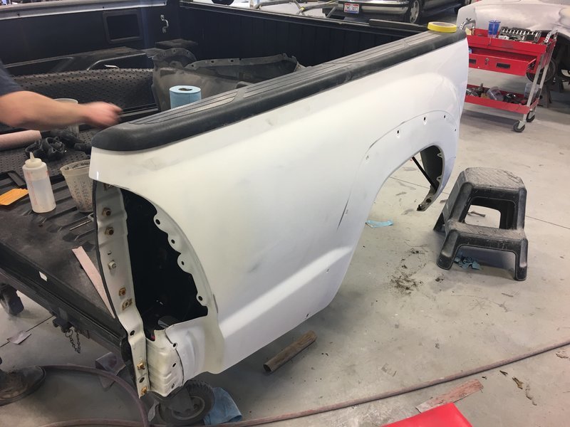

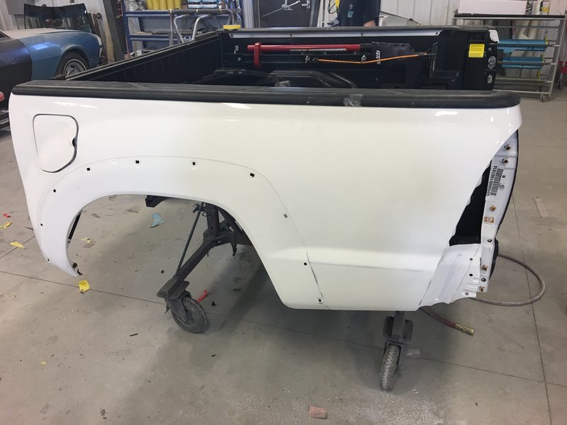

    8) New rear fender flares
    9) body work on bed and new paint on both rear bedsides
    10) New charcoal canister – pulled codes P0441 and P0455, P0456 due to evac leak
    11) All new tie rod ends, LCA cam bolts, bushings, etc up front…nice because I have lifetime alignment from Firestone and they always have trouble because of the cam bolts in the LCA’s.
    12) A/C evac and recharge
    13) Lots of cleanup of surface rust underneath. Lots of new bolts and other hardware throughout.
    14) New factory tow package trailer hitch– that thing is $1,200!
    15) New rear bumper
    16) Replaced engine coolant
    17) New PS fluid
    18) Thought about getting new leaf packs, already have AAL from Icon, but decided not to. The leafs are the only thing “rusty” underneath right now.
    19) Minor body work on the cab near the rear window where the bed rubbed up against the cab

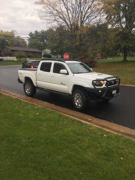

    March 31, 2017
    Got the truck back and have put about 500 miles on it so far. No issues to report, drives like new.
    Frame plug example:
    The weather is rainy out now so that is all the pics I have....
    Heated seats feel great, missed those….and the sunroof for 5 months. I don’t need no 3rd gen! Well we’ll see. Might wait for the 2018’s to come out and see the new Safety Sense features. If Toyota made the TRD Pro with a sunroof, it would be in my driveway.
