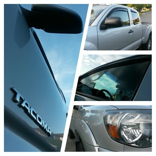

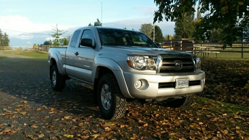

    So my trailer is a total loss and my truck has minimum $23,000 damage not including unforeseen issues. It's not officially declared dead but expected and accepted. It would require a new frame and there is a back order on frames here, pushing 5-6 months.
    Wrong place, wrong time, idiot drivers and gone. Poof. RIP "Ginny"
