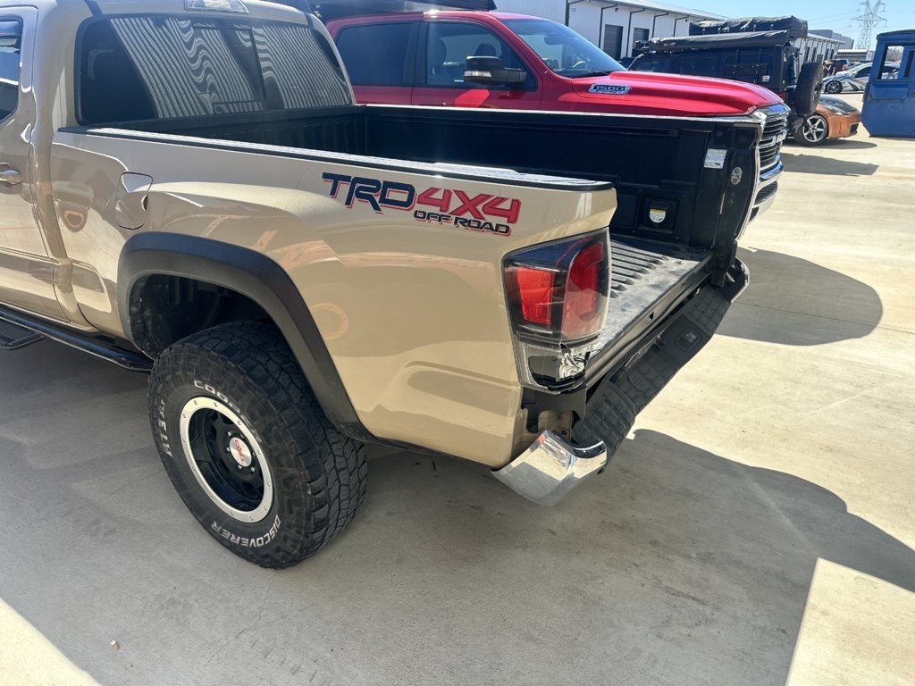

    Wow.. amazing if your camper survived without damage! Especially with the frame being severely crushed after your Yakima box acted like an airbag.

    You may want to read through the fine print on your insurance policy. They might have some requirement to alert them if you've ever been into an accident. As far as the frame, yeah that'd be a complete replacement if they go for it. What year is your truck? Any pictures from the back after the wreck? Just for us rubberneckers:D

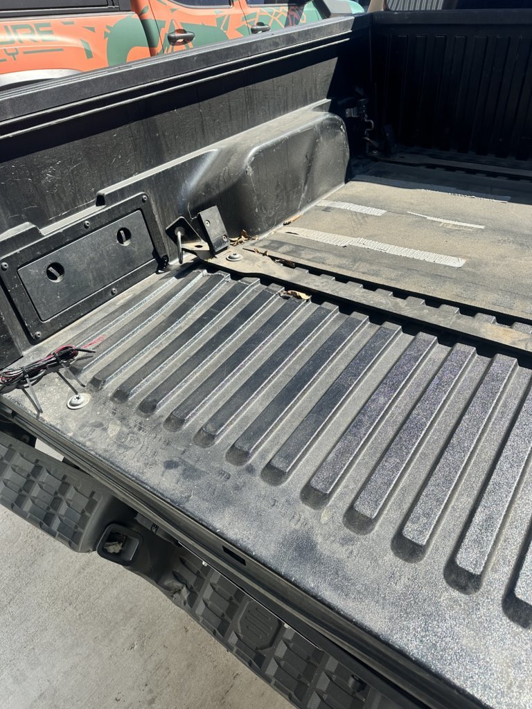

    Thanks for all the comments. I have contacted my own insurance. I have a seperate policy on the camper. I have the camper off and luckily the only damage is the turnbuckles stretched.

    Yes it definitely looks like a frame and as far as I know insurance does not let frame replacements.. My advice is let insurance talk with other insurance, and see how much they will give you, then go and buy other 3rd gen. Make sure they count the rims, tires and all the good stuff, not just random bs kelly book price without them looking at details.

    Had similar damage in 2018 when R/E in my 2016. Per two different Toyota shops the frame is designed to “crumple” in that area so it did its job. At fault party’s estimator wrote for a full frame replacement which did not total the Taco. Zero body damage in my case.
    I’ve been around the collision repair industry in some form for most of my 50 years on earth and decided I’d rather deal with a frame repair than frame replacement so I cash settled with other insurance carrier. Found a a take off bumper/hitch assembly locally. Paid an old school body guy to straighten/reinforce the frame and swap bumper/hitch. So far, so good for the last 75k-ish miles including towing. Frame damage was isolated to behind axle because of the “crumpling” so no issues with alignment. Had the frame been compromised between axles I may have done something different, in fact probably so. Installed a lift about 15k miles ago and no issues including realignment after lift.
    Bottom line, you don’t know until you know. Get the best info you can on your specific dilemma from people who know what they’re doing and do what’s best for your situation.
    Dont see me getting rid of this Taco by choice so the consequences of whatever I decided were my problem to live with good or bad.

    Yeah that's done my friend, sorry. Beautiful truck.
