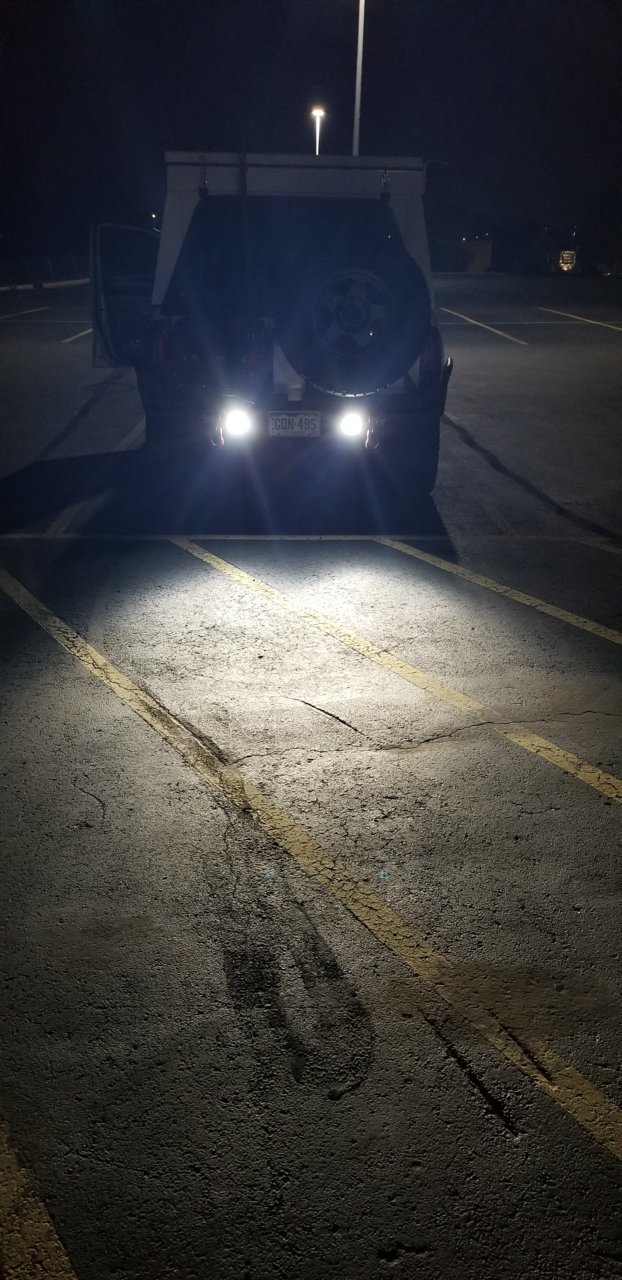

    Rigid SR-Q in Brute Force Fab standard rear. Hooked up to a 3-position rocker for Off/Auto-w-Rev/On

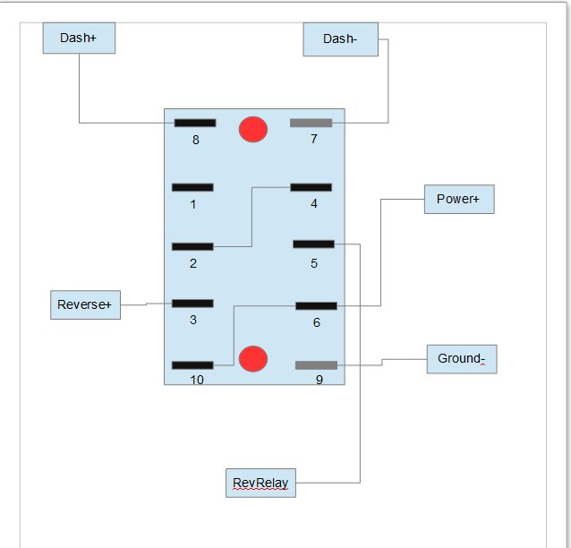

    How did you wire that switch? I've been playing with that idea for a while but i can wrap my head around the wiring.

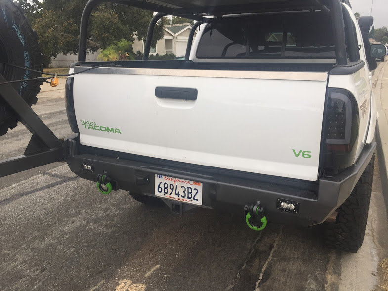

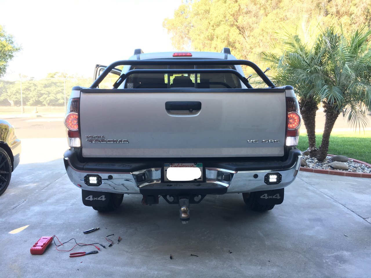

    $30 Amazon leds and a few hours of cutting/filing/cursing. Reverse wire tapped and soldered off the trailer harness.

    I've got a wiring diagram on my other computer, will try to dig that up tomorrow. It took me a while to wrap my head around too, and even bought another switch thinking the original one wouldn't work.

    This is how I wired mine, it's a 10-pin On/On/Off 3-position rocker from OTRATTW. The wires labled 'Dash' are for the upper LED, pins 9 & 10 are for the lower LED, Pin 1 is unused. - @Faheygf87

    Just added these Amazon Nilights(flood pattern) to the @At The Helm corner tie downs.
