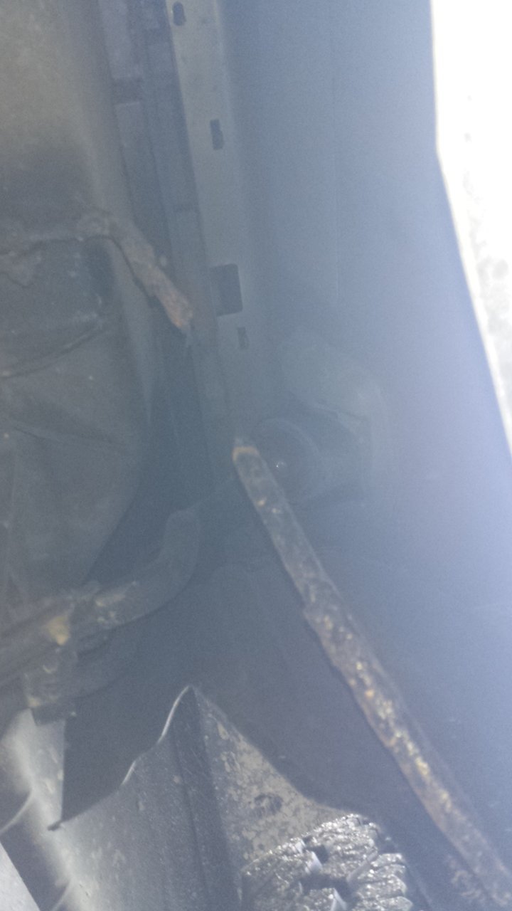

    Thread revive...i need a fix for this.. both sides support broke..:goingcrazy:
    No welder. :anonymous::bananadead:

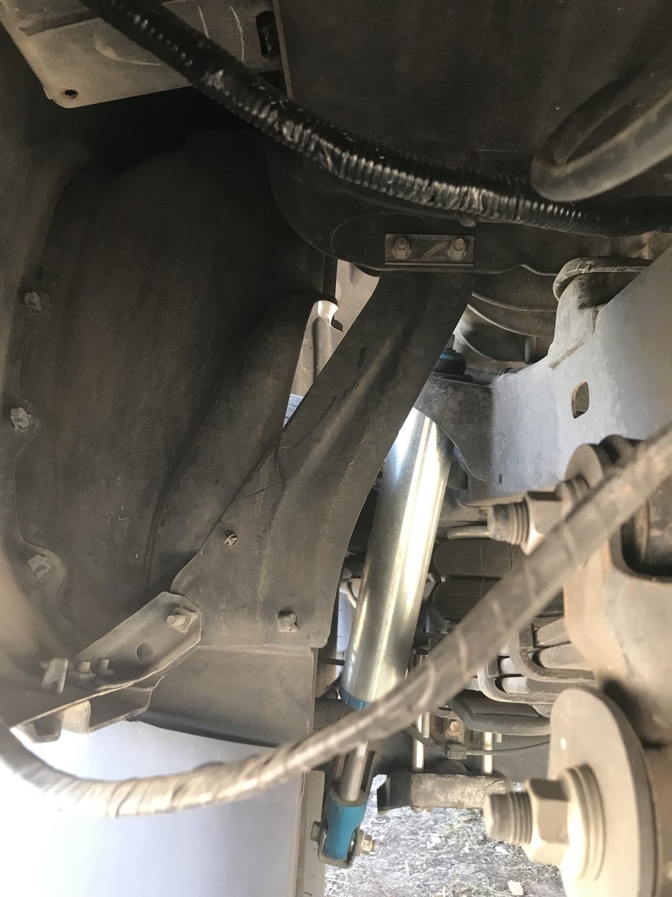

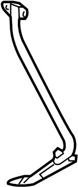

    If you have a chop saw, you could replace the two brackets that are behind the rear fender well with some steel or aluminum flat bar cut to size. You will probably have to replace the top two bolts with some longer ones, but i think it would work..
    Here is the bracket im talking about you could replace.. is it the same ones you are missing?

    Really bad picture but the bar that broke on mine is in front of rear tire..
    I think it's about the same fix here as you said on other bracket though.
