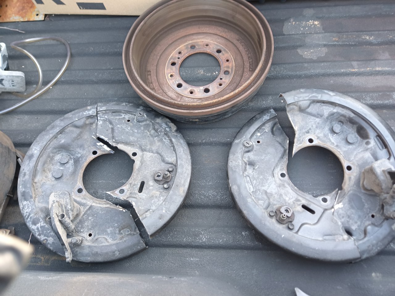

    Or do what I did.

    bummer... i was going to ask if you wanted to sell your backing plates. I need some.

    They could be bolted on and mig welded back together. Cover shipping and i'll send them.

    All that so you don't have to remove the rear axels? The backing plates come right off after that, or like most people do, cut them off. My Tacoma did not come with the E-Locker, so I was upgrading mine anyway, my setup also has ABS system.

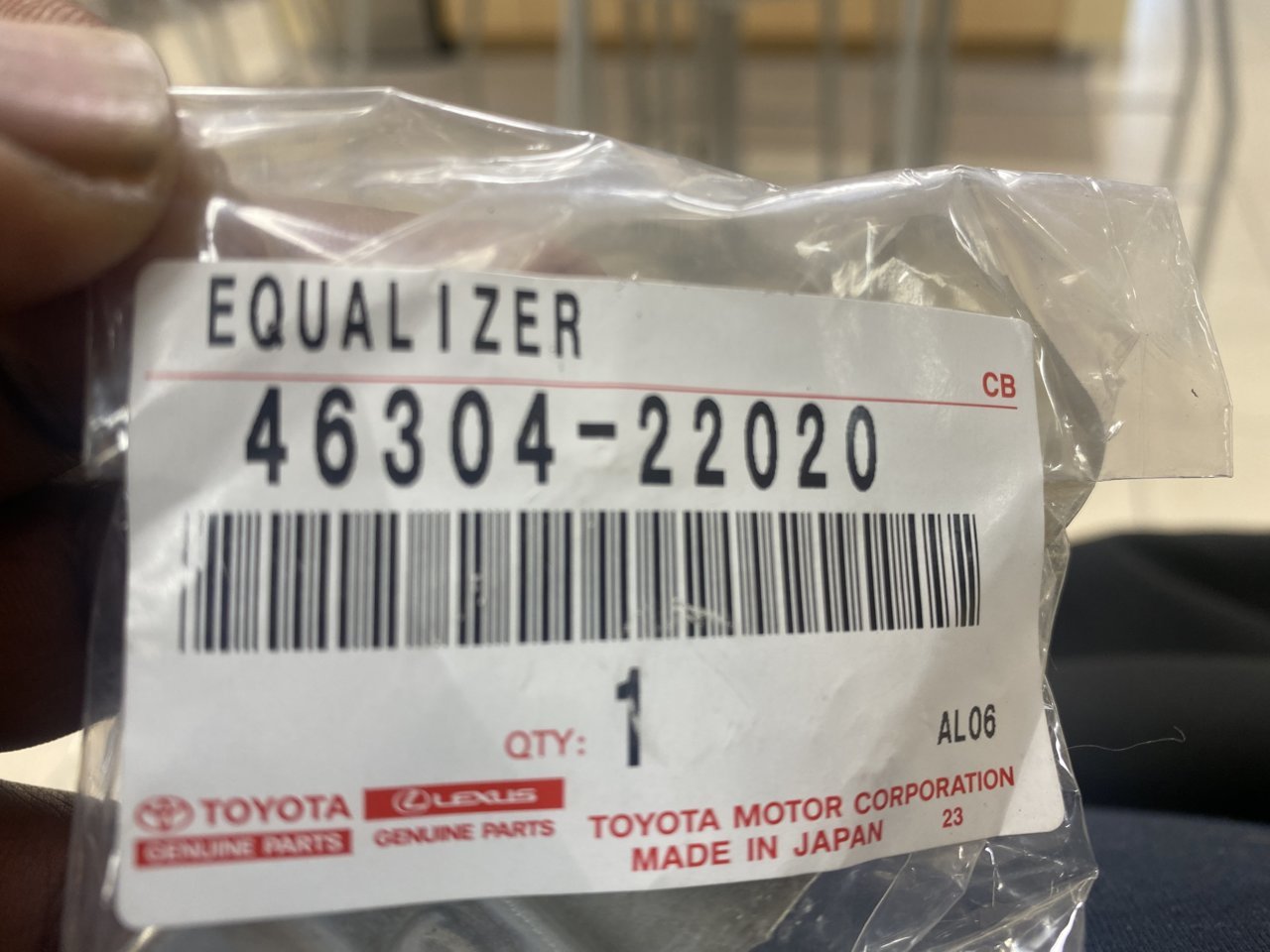

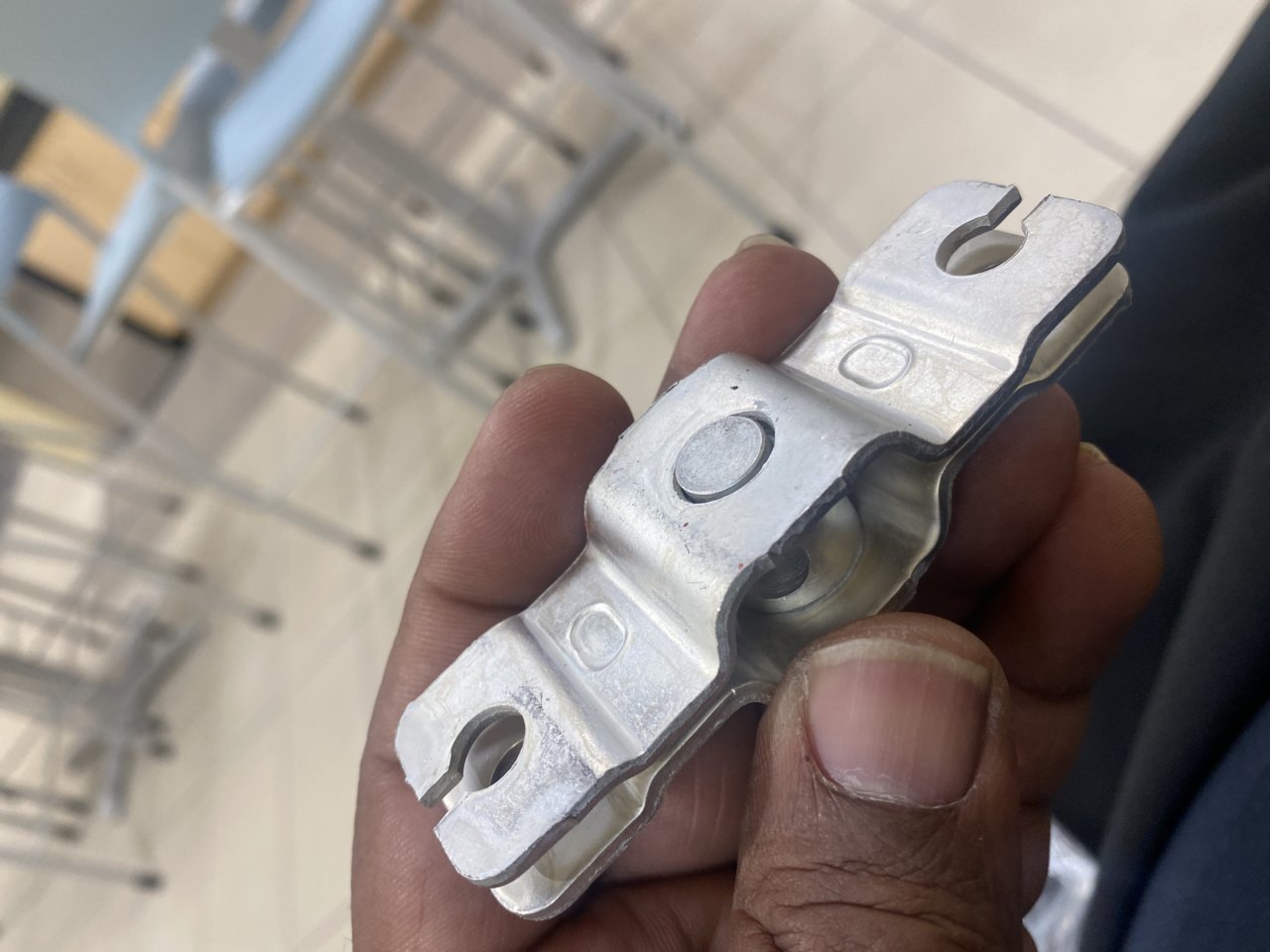

    D24BD91B-CB0E-47BD-B586-6FBA028CB1C8.jpg The equalizer where the e-brake cables mount to, then you have to adjust the pull T-handle

    You have to press the axle bearings off to get backing plates off.
