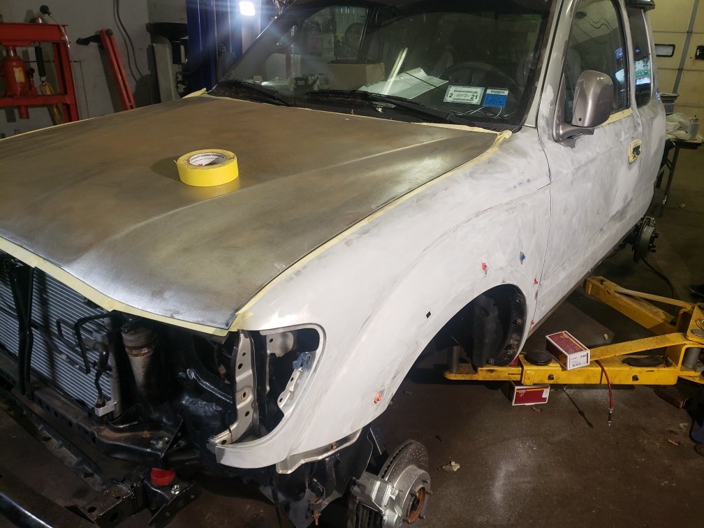

    SNEAK PEEK!!!! OF WHAT TO COME

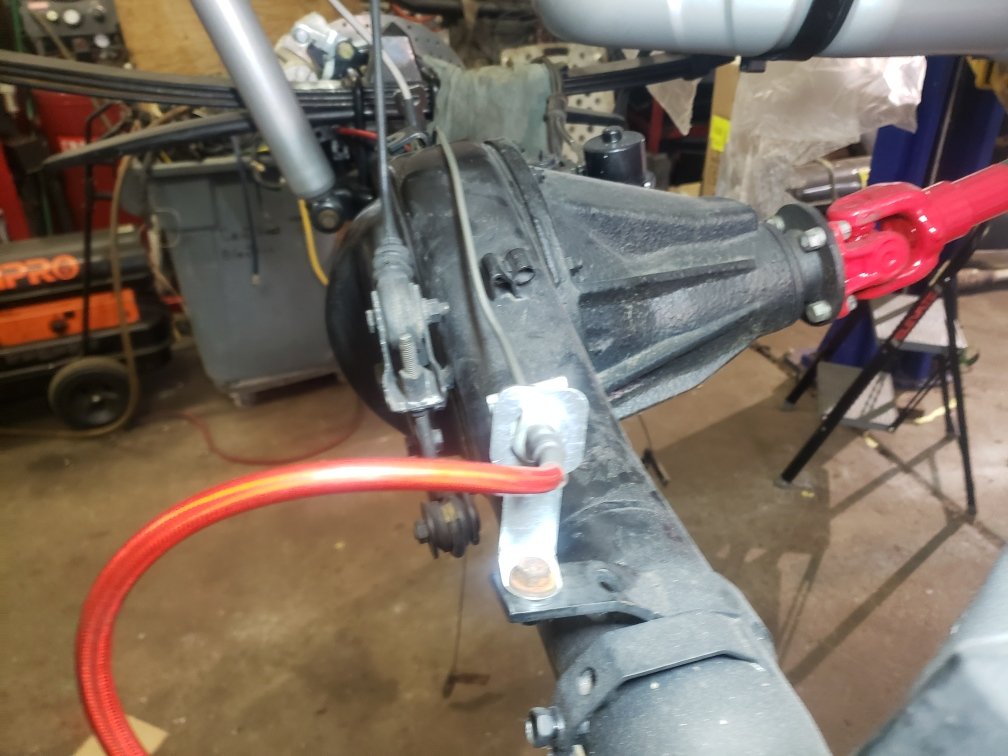

    This is how I had the lines routed using mounting areas already on the Tacoma, it's like Toyota knew I was going to do this to my truck!

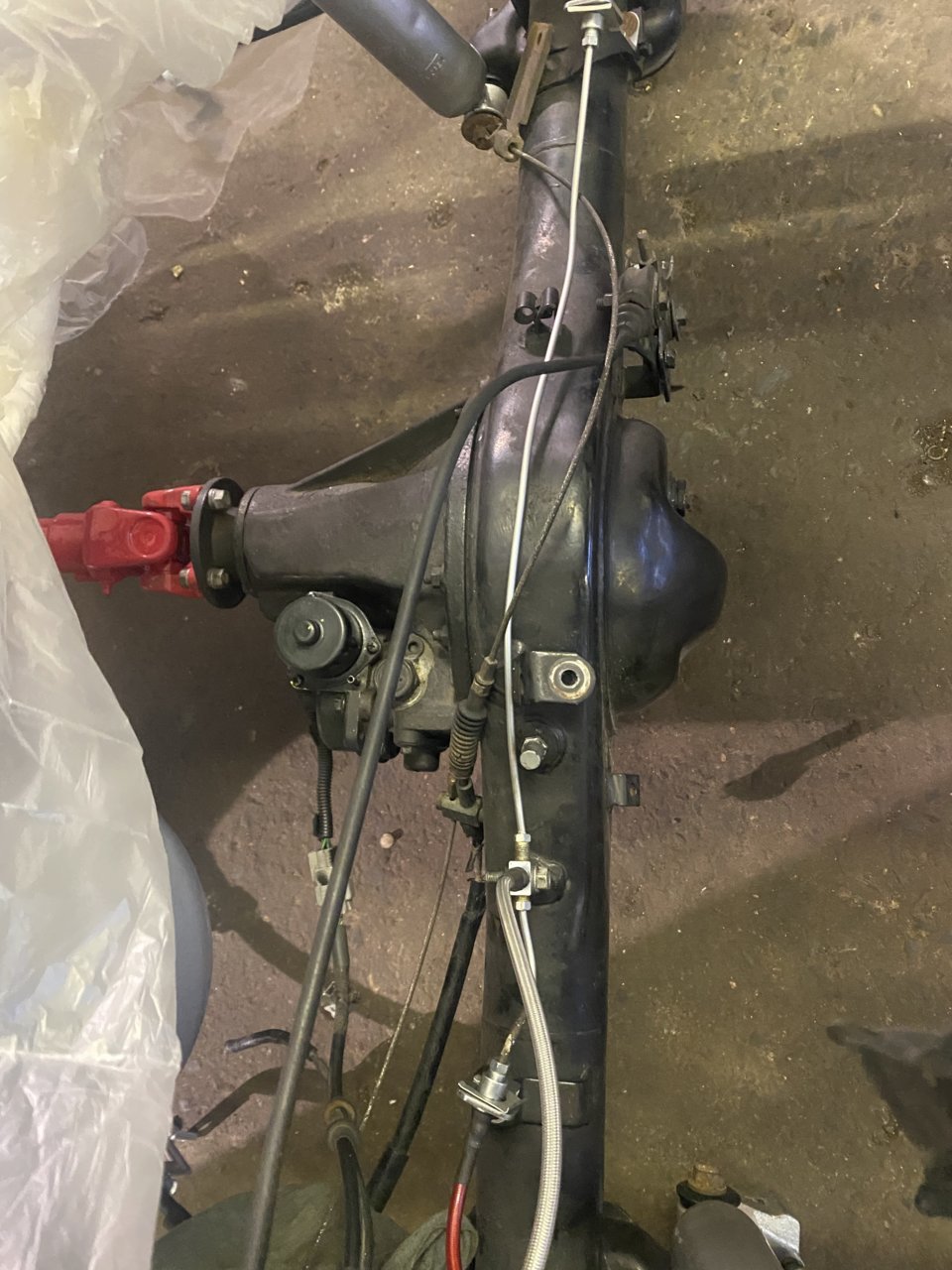

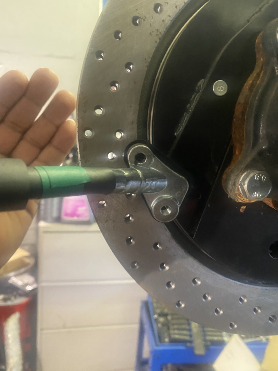

    My E-Locker Rear Diff. Now has Disc Brakes!

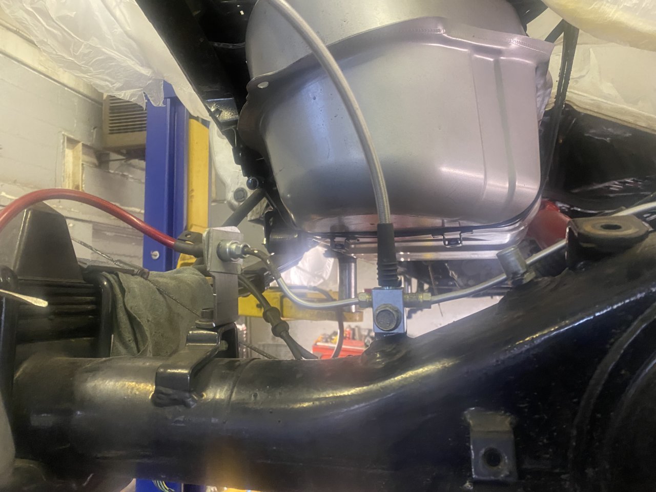

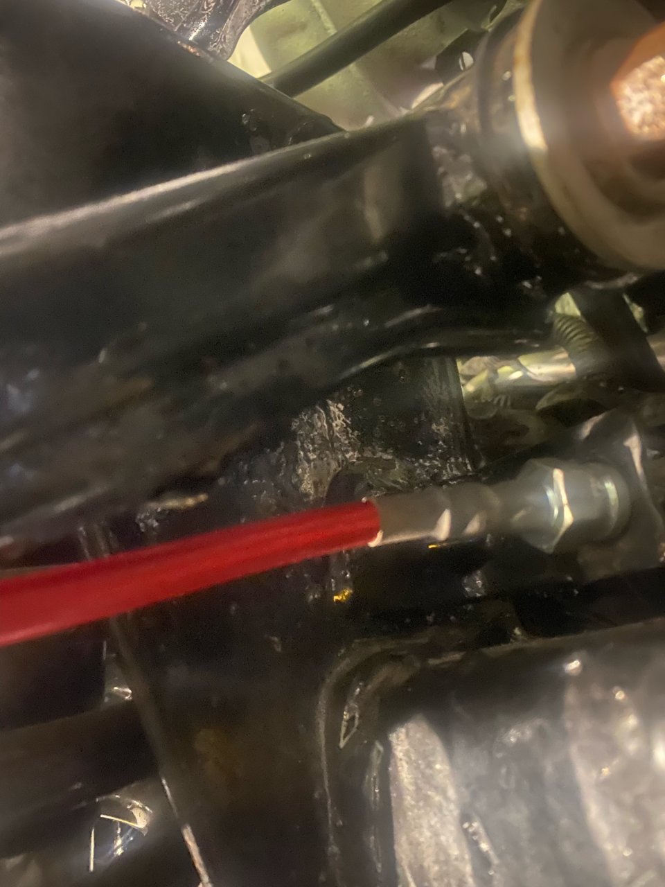

    This hose right here is a 21" long UNIVERSAL STAINLESS STEEL HOSE with a hard line T-Block at one end from Amazon.

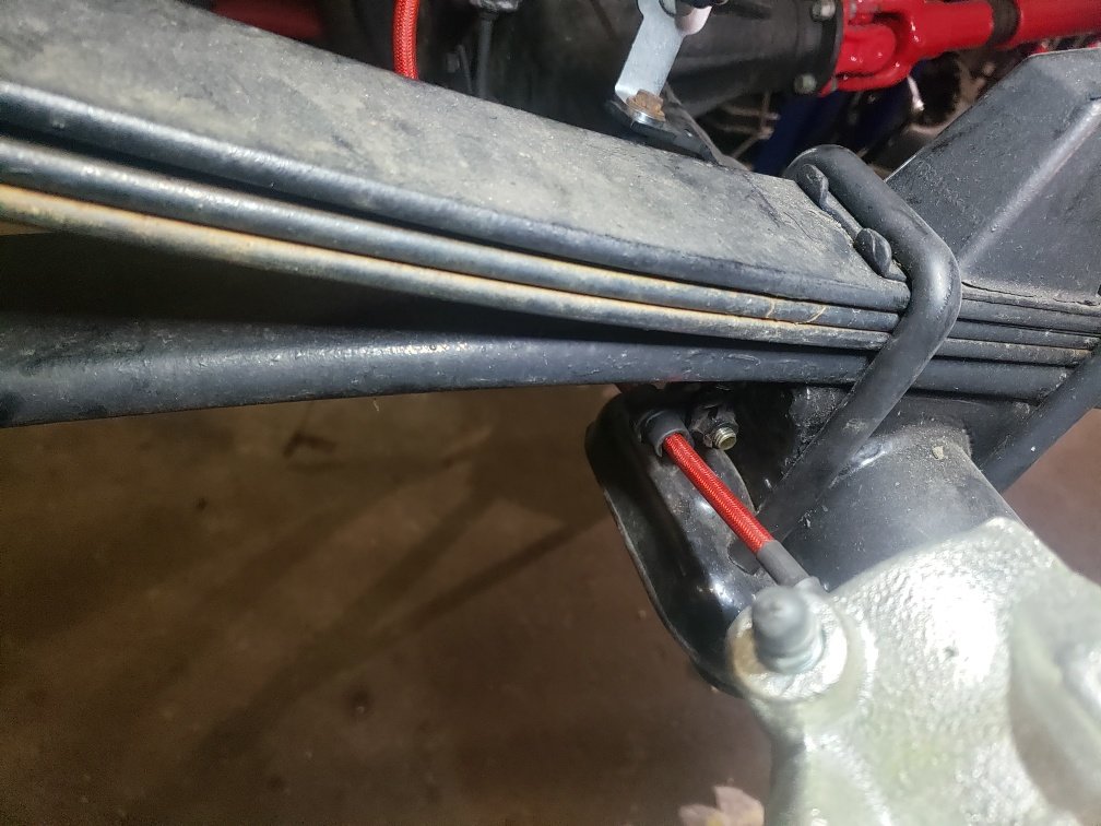

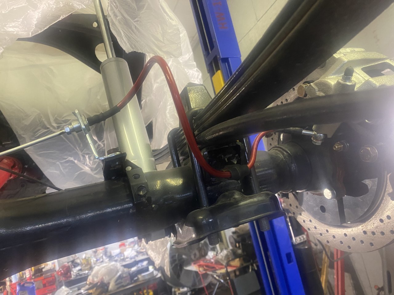

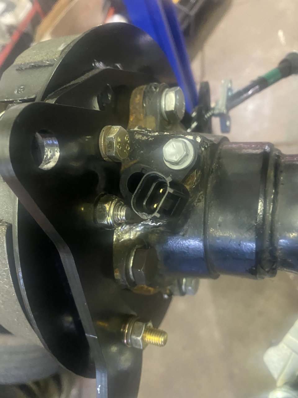

    E-Brake Cable install
