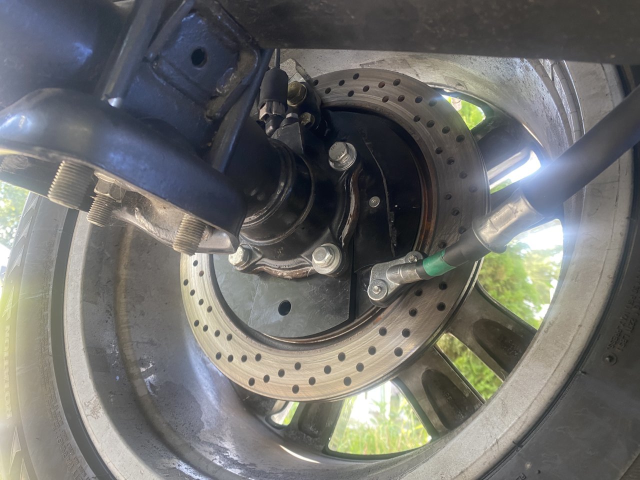

    I used the AC Delco e-brake cables, now that I matched the numbers, they are for the 2005-2015 Tacomas, they match up to the SOS kit. I heard too many complaints with the cables that come with the old kit.

    I do not like those rubber hoses that come with the kit, I went the stainless steel route.

    quick question: is the middle round hole big enough for our 1st gen's on that backing plate?

    Hmm? I’m not sure what you’re asking about sadly

    The holes do not match to our tacomas, but how about the center hole does it clear it?

    Oh. I believe they’re bigger too the bearings a fair bit bigger

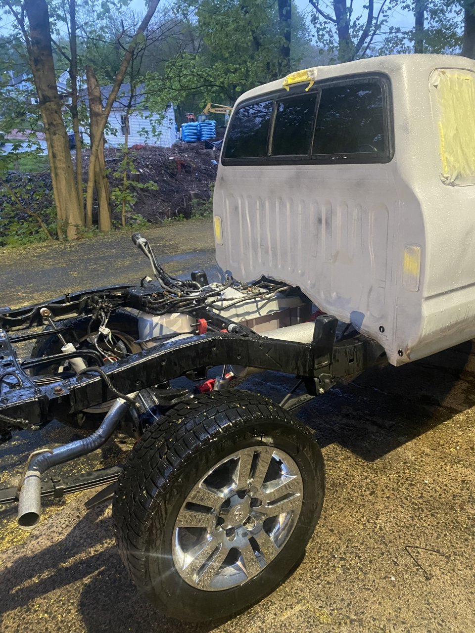

    Hey, can anyone point out or take a picture on how the EVAP canister is suppose to be mounted?

    look at post #9 < I added some pictures on how I am currently using them.

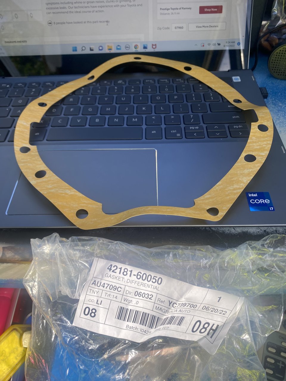

    One of the axels started to leak and it turned out that the 1st mechanic did not use the OEM seals that I gave him. So, I just had the inner and outer seals replaced and the center pinion gasket as well. There is absolutely NO LEAKS ! Now
