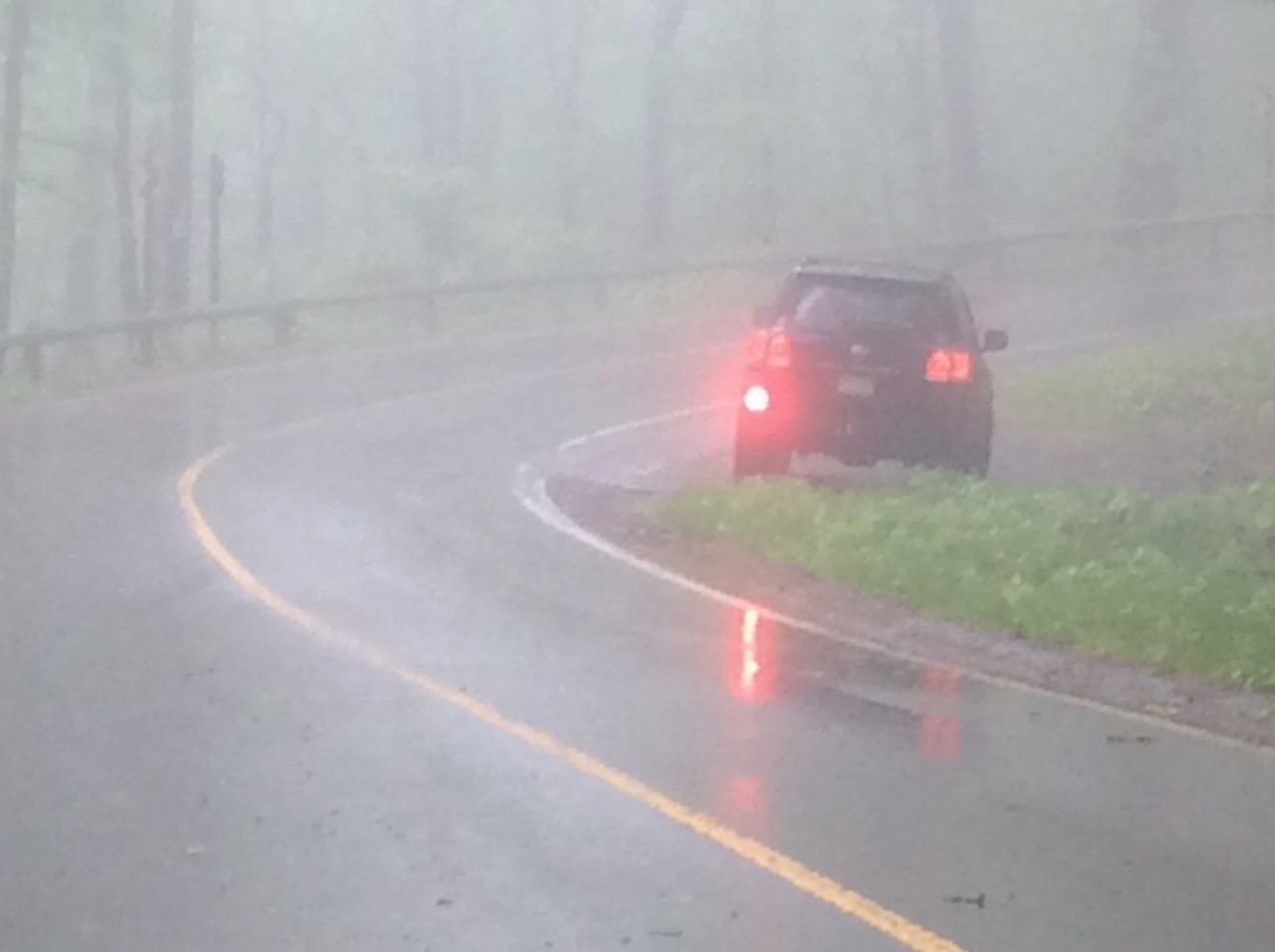

    Rear fog on my wife's Land Cruiser.

    Are they really called "Fog Lights"? Surely they actually have a different name?

    Rear fogs are a euro thing, or were back in my vw days..
    Usually on the driver side and one red lamp stays lit brighter than the tail lights.
    Dust/chase lights are high up and mostly yellow. used so the guy behind you doesn't run you over in the desert.

    Rear facing fog lights are typically on vehicles on the passing side of the vehicle, they are brighter than the tail lights and are found on lots of euro vehicles like mentioned above and are there for added visibility in foggy weather, similar to the function of the forward facing fog lights.

  16. Dec 4, 2019 at 4:27 PM

    Jowett
    Jowett Well-Known Member
    May 5, 2016
    #186182
    1,625
    Brian
    North Adams, MA
