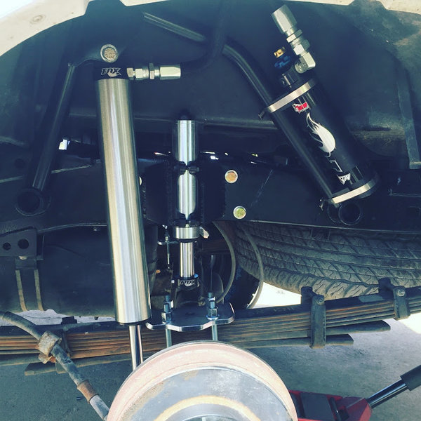

    UPDATE:
    So I have my Fox DSC 2.5 FJ shocks installed perfect length for dakar leafs.
    They are 9" travel 3" up and 6" down travel... after a small tweak.. I'm running a smaller bushing to shorten the shock a little...
    But unlike the other Fox shocks they don't just bolt in.
    1. You need a .5 to .75 bushing
    2. Go to 1/2 bolts
    3. Trim the width of the rubber bushings
    4. and Grind the bottom of the shock so they fit in the mounts
    5. Flip the reservoirs
    6. reclock the drivers side reservoir...
    But after all that they fit great and are the right length.
    Not worried about the valving because I had planned on getting custom valving anyway, but should be real close..
    If I were to do it again I would order the Tacoma lower eyelets and have them installed.
    You could use the Tacoma shock and use a spacer under the bushing to make the shock 1/2" longer but the FJ shock has 1/2" longer travel and I may be lifting the rear a little more...
    When I get my ecu back I be running up north for a test run...
    I also clear coated the shocks for the northern salt.....

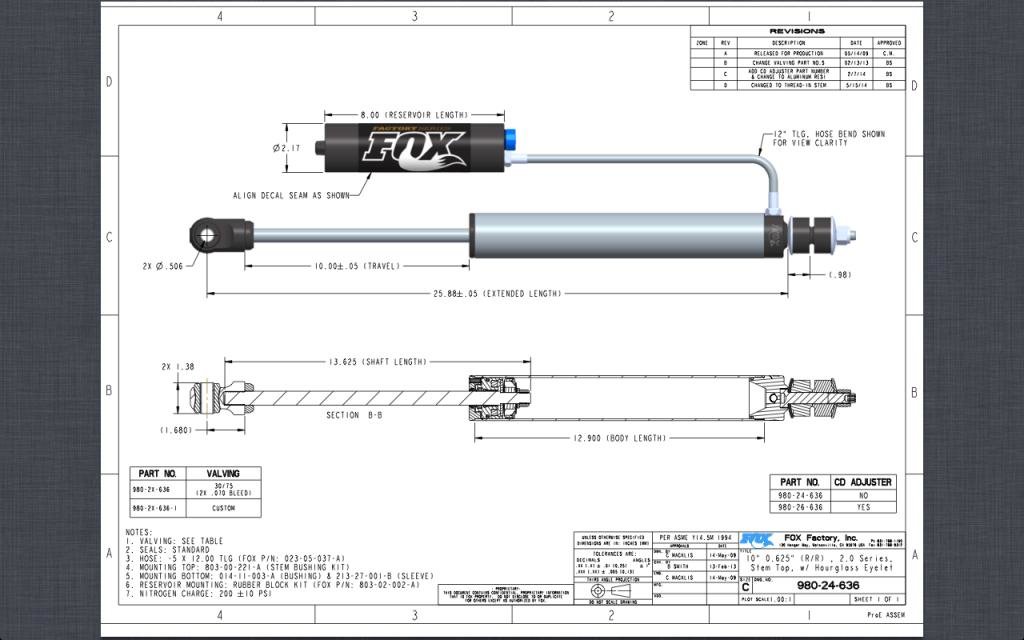

    You don't want to go with Performance Series. They have issues with the upper stem top breaking off. Ask me how I know. Fox acknowledged this issue and for the steel shock body Factory Series they made a revision to their stem tops to allow a screw in upper top cap and independent stem from the rest of the shock body, just in case it breaks. Them just like the PS used to be solid on the upper stem top as well. Not anymore.
    Go Factory Series.
    You will see what I mean upon viewing the image of the two. The Factory series shock displayed on this link does not accurately show the right upper mounting stem top, it shows eyelet, but,
    - P/N 980-24-636 is 10" stroke (25.88 expanded/ 15.88 collapsed) and
    - P/N 980-24-637 is 12" stroke.
    A little more pricey than the PS shocks, but worth it. Choose your flavor.
    https://www.polyperformance.com/fox-2-0-smooth-body-remote-reservoir-shock-5-8-shaft
    PM me if you need any additional help with this or want any clarification in what I am saying. :)

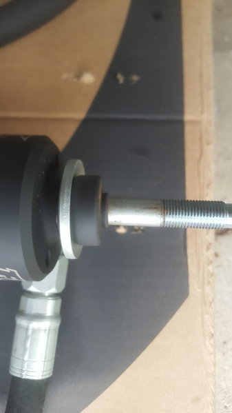

    My shocks made it no problems, now they are out of stock.
    Got a .75 to .5 bushing from the hardware store for the lower bolt.
    The fronts are in now to install the rears.

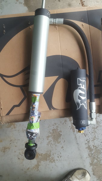

    Ok took out my nitrochargers and measured up the fox FJ shocks and they are the perfect length for dakar leafs springs.
    Mounting height is just over 25" and the truck is at 22" and it's a 9" shock giving me 3" up travel and 6" down travel with 200 lbs in the bed.
    My stock bumps start to hit at 5".
    Just what I want.
    They are about a 1/2" longer than the nitrochargers and are also a 9" shock. But I was running washers on the EMUs so I'll pick up about a 1/4" more down travel.
    The foxes also have heavy duty 3/4" thick bushing that could be modded for a little more up or down travel if needed.
    The lower bushing much different than on the tacoma about a 1/2 wider and 19mm (3/4).
    I'm going to call fox to see if I can get the lower bushings.
    If not I'll mod the bushings to fit and get a 11mm to 19mm bushing for a tighter fit than the .5 to .75 bushing.
    Some people claim this is a 10" shock but from what I find it's a 9" shock and measuring it's only 8 1/4" to the rubber stop and 8.8 total.
    Dang wish it was a 10" shock that would have been perfect....

    UPDATE:
    2. Go to 1/2 bolts

    First run up north went great.
    Shocks work great.
    FJ valving seams good, maybe a click stiffer than the front..
    Need the longer shocks with the tacoma and dakars...
    The adjusters work great you can feel every click..

    I would say using the FJ shocks are a pain to set up, but in the end are the perfect length for driving fast...
    I would do it again..
    But should have just went to 12" shocks. but we'll run these for awhile...
  16. Jul 21, 2017 at 9:12 PM
    #16
    shr133
    shr133 [OP] Well-Known Member
    Jul 8, 2013
    #107900
    2,215
    Steve
    Muskego, WI
    2010 V6 Sport
    K & N filter, 275 70 17 Cooper AT3, OME Nitrocharger shocks, 884 Springs, Dakar leafs.
    Update:
    The FJ shocks worked great at the dunes. They are stiffer than the Tacoma front coils but on the dunes the valving is closer than the Tacoma coil overs.
    So I'm going to have all 4 shocks revalved and we should be good.
    The FJ shocks were at 6 clicks but the coil overs were maxed out and still soft.
    If you are getting the Fox DSC the front coils need more compression and rebound dampening .
    The FJ rears just need a little more rebound.

    Think these 980-24-636 might be perfect for my deavers. Wanted king 25001-121a to match my fronts but 2.5s are probably overkill for me Just looking for a good extended rear shock with adjusters
    for occasional weight. Quoted from poly:
    Fox 10" 0.625" Remote Reservoir 2.0 Series, Stem Top, w/Hourglass Eyelet, Black, "30/75 Valving"
    Would you recommend this valving for street driven occasionally crawling "i wish i didnt have so much shit in the back so i could go a little faster" setup. Would rather not revalve since i really dont have the knowledge and trucks a DD so sees a lot of highway/ town.

    As far as valving is concerned on any car, absolutely not. I recommend probably something like 50/30 (equal to about 10C/8R) if you are going to be occasionally crawling and having some fun but still want to enjoy DD. Personally I run 90/50 on my rear which is equal to about 15C/10R, but my shocks are valved towards "Go faster than the quad next to you as you blast across the dunes" style setup.

    Ok thanks for the reply. Ill have to hit up poly and see if thats the only option as fox would have to add the adjusters anyway. Just read your build thread. Good stuff

    What would a 30/75 be good for outta curiosity. Still trying to learn
