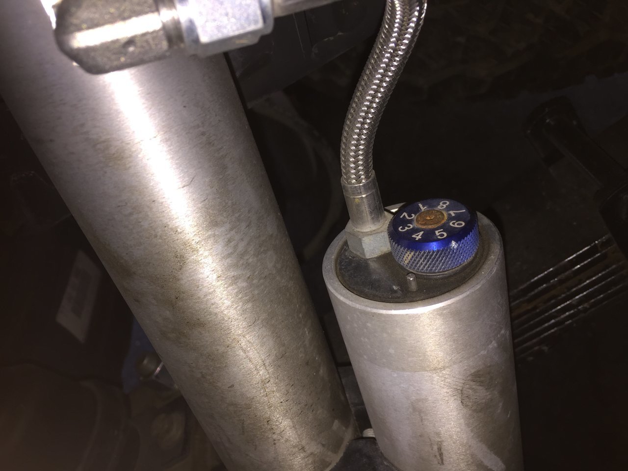

    Yea the adjusters in front were pretty much a wash for my application but i woulda always wondered what if so lived and learned.
    But i do use the fox clickers in the rear somewhat often. Although I only go from #3-#5 outta the 8 possibilities. So having a shock set at #4 setting initially (no comp. adjuster) would save a few hundred bucks

    IMG_3242.jpg @*TRD* i
    yea these are definitely not dsc
    *TRD*[QUOTED] likes this.
