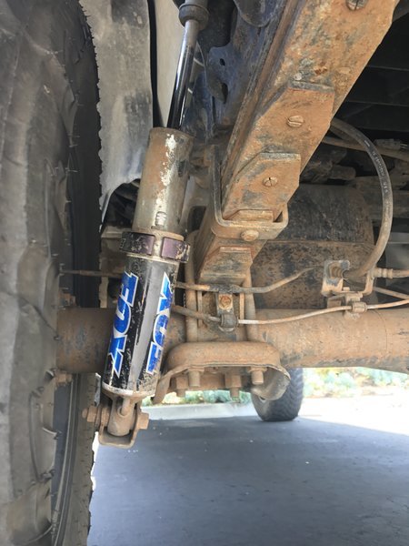

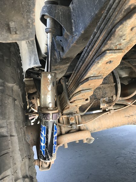

    Hey guys,
    I got a suspension inspection this morning and the guy was hard to read.. not sure if he was truthful or trying to play me.. I'll admit I am not the smartest with suspension yet.. He was saying that my driver side rear Fox shock needed to be replaced/rebuilt. Not really sure why.. He couldn't really explain either. I don't think they are that old so it doesn't make sense that they would need to be replaced.
    Anyone have any knowledge around this? How often these should be replaced, if at all? How do I know if they need to be replaced?
    PS.. Excuse the dirty undercarriage.. Need to pressure wash this bad boy..
    :mudding::crapstorm:IMG_0495 (1).jpg IMG_0496 (1).jpg
    Thanks,
    Tyler

    Looks fine from the pic. I think that is rebuildable as well so it shouldnt be replaced completely

    How many miles do you have the shocks? Do you see any oil leaking?

    I've got a lot of LOUD squeaking up front and I want to upgrade suspension anyways. The right side UCA ball joint is shot too. That's where the squeaking is coming from, so I'm told. Only thing that makes sense so far.
    For the rear, no oil leaking. Doesn't feel super soft either

    to test it, check for leaks, then bounce the car on that corner, if it keeps bouncing then the shock is bad, if it settles quick then its fine.

    Take the shock off, inspect it for leaks and what not.
