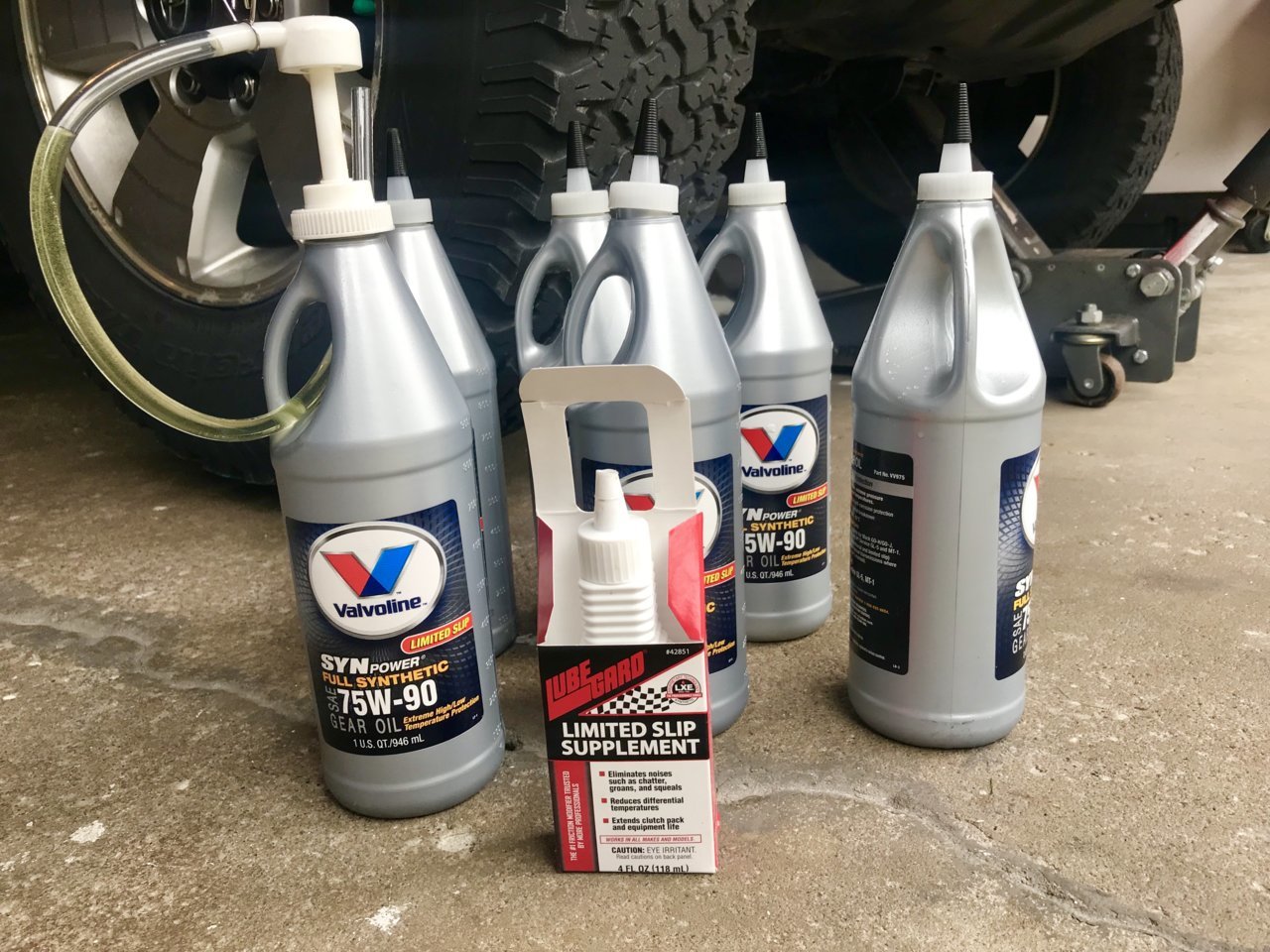

    After reading a few posts, I felt like I became more confused as to which brand of gear oil I should or should not use so I stopped reading. I looked at the owners manual and went to the local auto parts stores and settled with these. I have not heard any explosions from underneath yet either.
