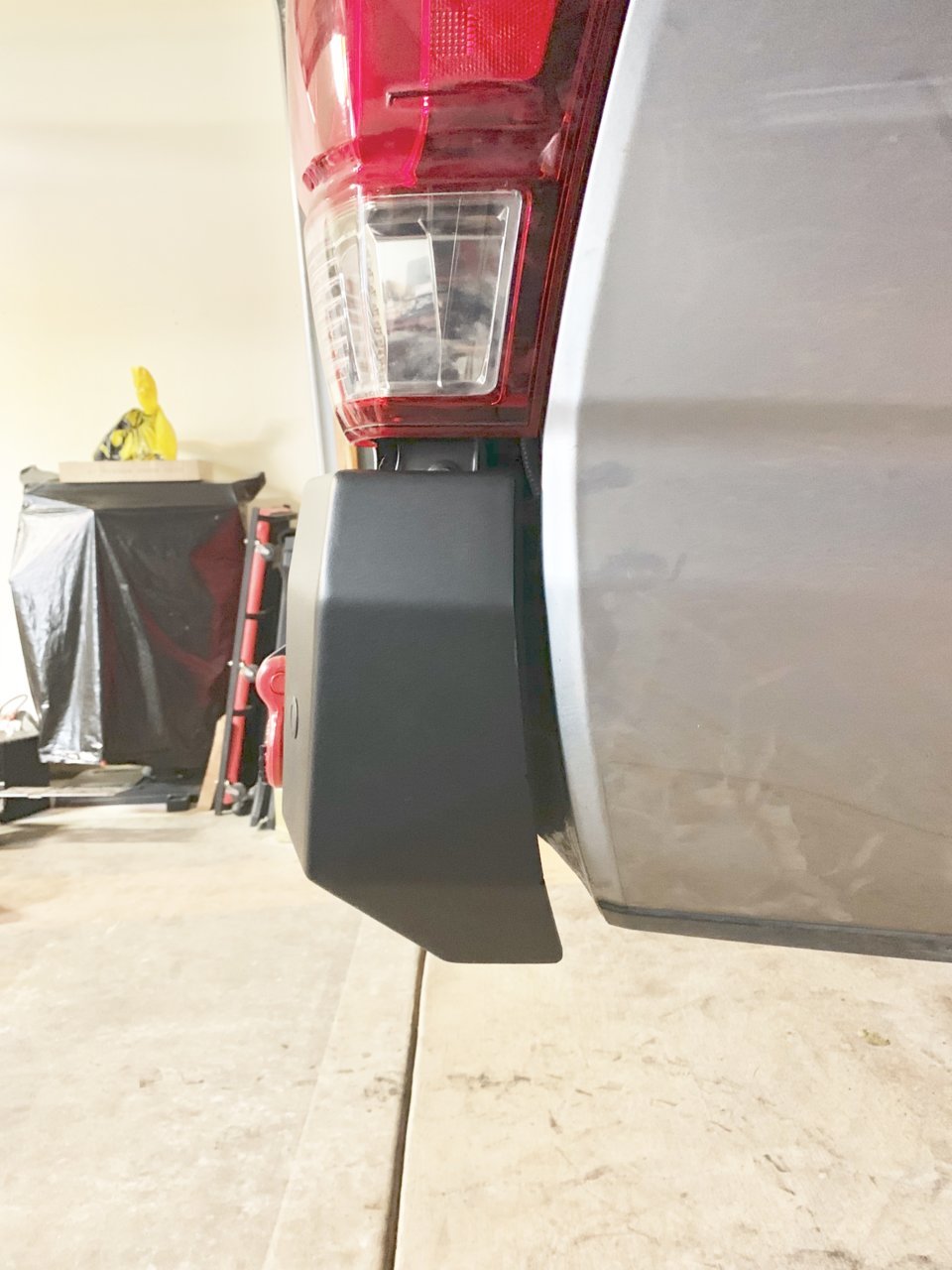

    Actually, I did notch that flange to try and use the bottom holes, but it’s too high. Bumper was contacting the tail light before the holes lined up. The bottom hole on your bracket looks higher than mine, but it looks like yours fit good.
    Since some of the bolts definitely still has some play, I’m going to remove a couple of the bolts that I think is causing the issue and see if I can align the bumper better. This should help me identify the holes with issues.

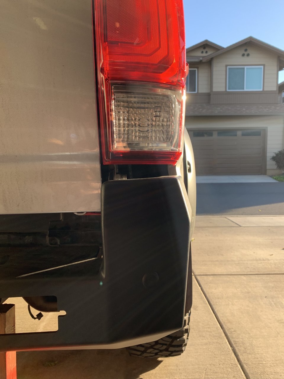

    So I got around to messing with this stupid bumper again today. I removed the back 2 bolts to try and align it better and it still had a fairly large gap below the tail light, but definitely better. However, I would have to enlarge the top rear bolt hole quite a bit and there wouldn’t be much metal to bolt on to after. Here’s the best I could adjust without the back 2 bolts:
    Here’s what the bracket looked like with the bumper adjusted like this:
    That bottom hole needs about 1/8” shaved to get a bolt in there. The top hole needs more than 1/4” shaved:
    I didn’t want to take that much off that hole so I left it alone. Besides that wouldn’t completely resolve the issue anyway. There would still be quite a bit of gap.
    I decided to just try and adjust it the best I can with the holes as is. At this point the only way to reduce the gap to the taillight is to tilt the bumper. I had to trim this piece of metal because the bumper was hitting it when I tilted the bumper.
    Here’s what it looks like now. I basically traded off symmetry for less gap. From the rear it looks better than before, but the gap is still quite large. The side profile still erks me. Since the bumper had to be tilted to reduce the gap to the tail light the bottom corner of the bumper is about 1” away from the body and the top of the bumper is about 1/2” away from the body. Basically it no longer follows the body line and the bumper is still hanging lower than the body. I’m not sure which is worse. Not having symmetry to the body line or having a huge gap from the light. Here’s what it looks like now:
    Basically this RCI rear bumper fits like f@&king shit!!!!! I am so erked. still can’t believe how different the fit is compared to others. I hope others that got their bumpers made at the same time doesn’t have this issue.
  14. Mar 3, 2019 at 4:15 AM
    #94
    kystnTRD
    kystnTRD Ramblin Man
    Sep 19, 2007
    #2741
    762
    NW Pennsylvania
    2016 TRD Sport 6MT
    I feel your pain dude. That's completely unacceptable.

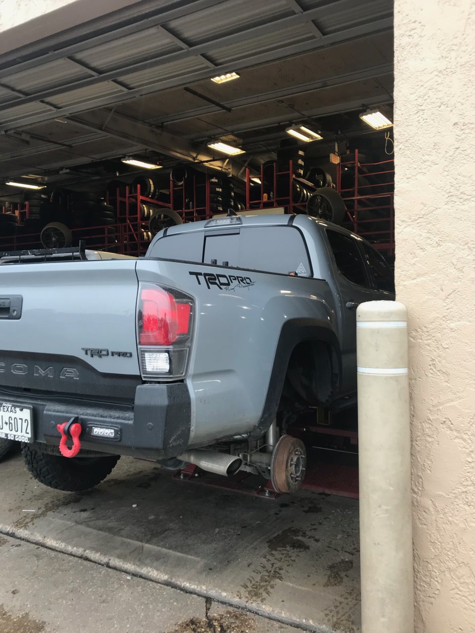

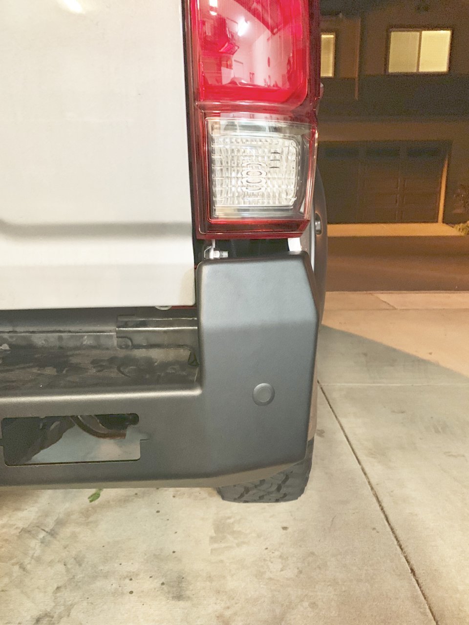

    Not to add any salt to the existing wound... but I dug up a few more pictures to show how much gap I ended up with. I did have a little bit of wiggle room left but I was happy with the install results.
    Something is screwy with this bumper @SK808, unless you were rear-ended in the past and haven't told us.
