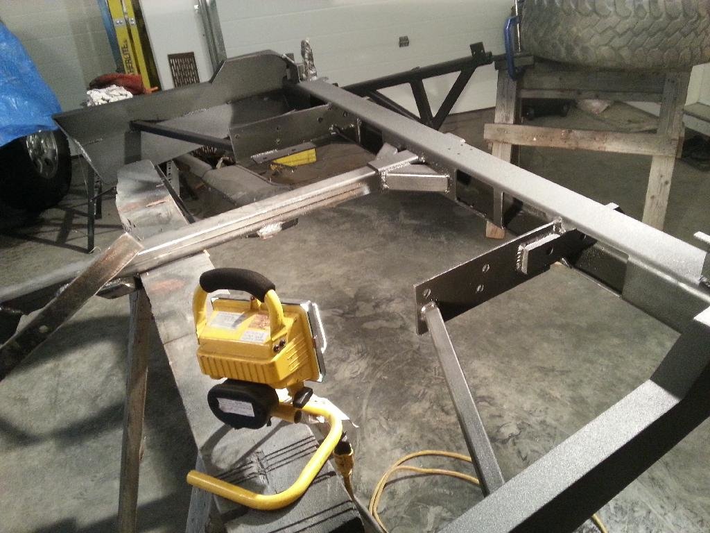

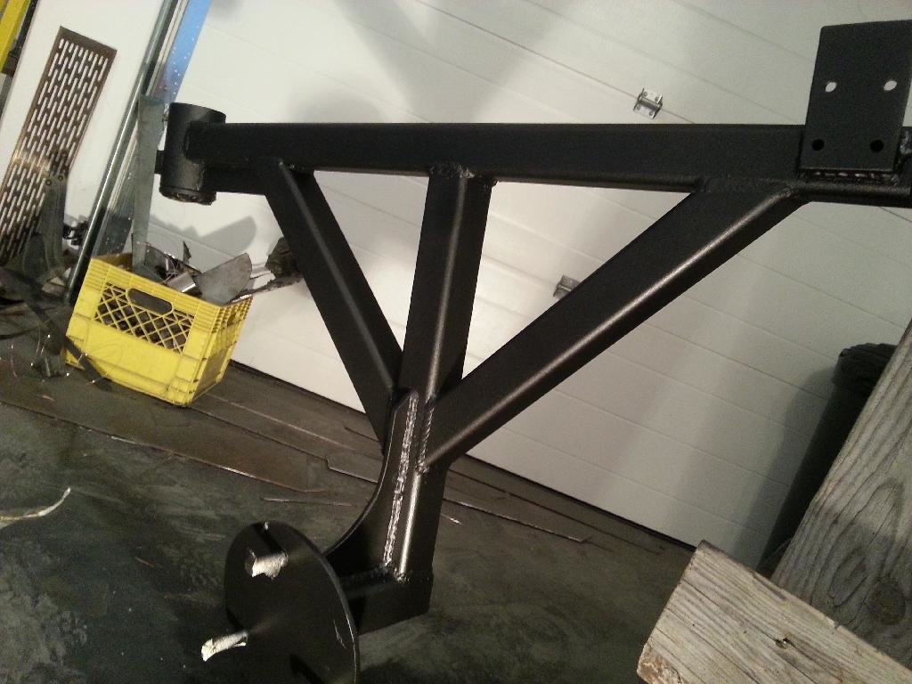

    Got quite a bit done today
    yry3ype7_478c11032861812a138db01d6fe7ee1f21660172.jpgmepaga5a_990be53ac29e8c9e50b01a2b816e2d3e0d41ca2e.jpg
    Holes drilled for water drainage
    sa5ygaba_201605618abf9e64d4c71b445ab2578e227635ca.jpga6u2uneh_eab74bf2f4228dff31097c0b175fc4d4c31a3eca.jpg
    Wheel studs pressed in

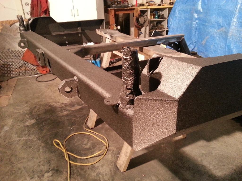

    Christmas Baking: nylon seat for swing arm. Formed it over the edge of the main 4x4. Forgot to take a pic of finished product.
    ny9yme8u_d4c1d6839ceb9890a0fcb348ffe6843cee0b6af9.jpganugypy6_ee1d6db1da6899ddeb79591d670d0f7c730e3dfb.jpg
    Primer!

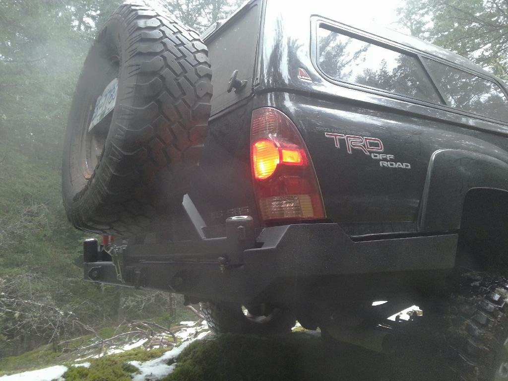

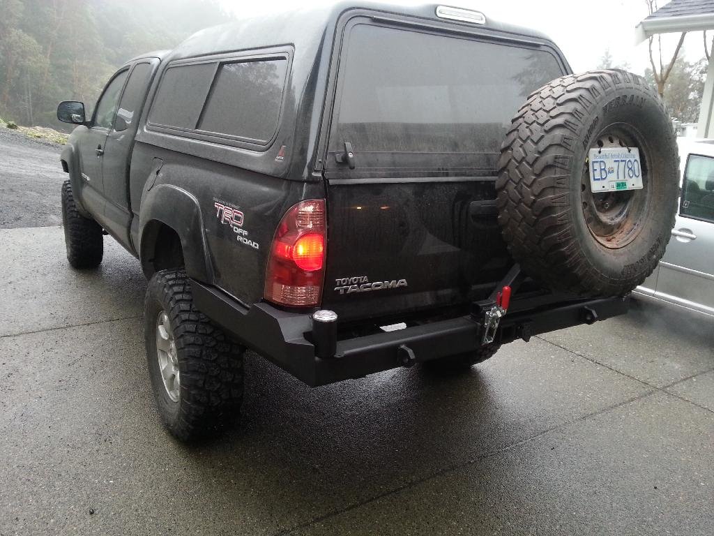

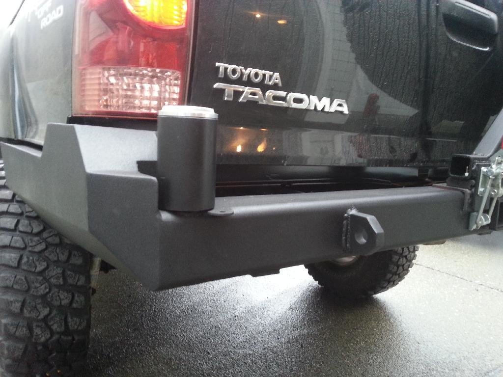

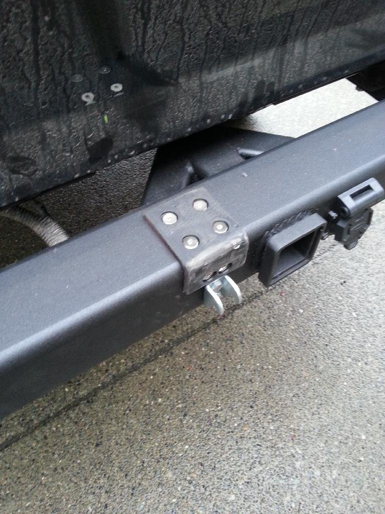

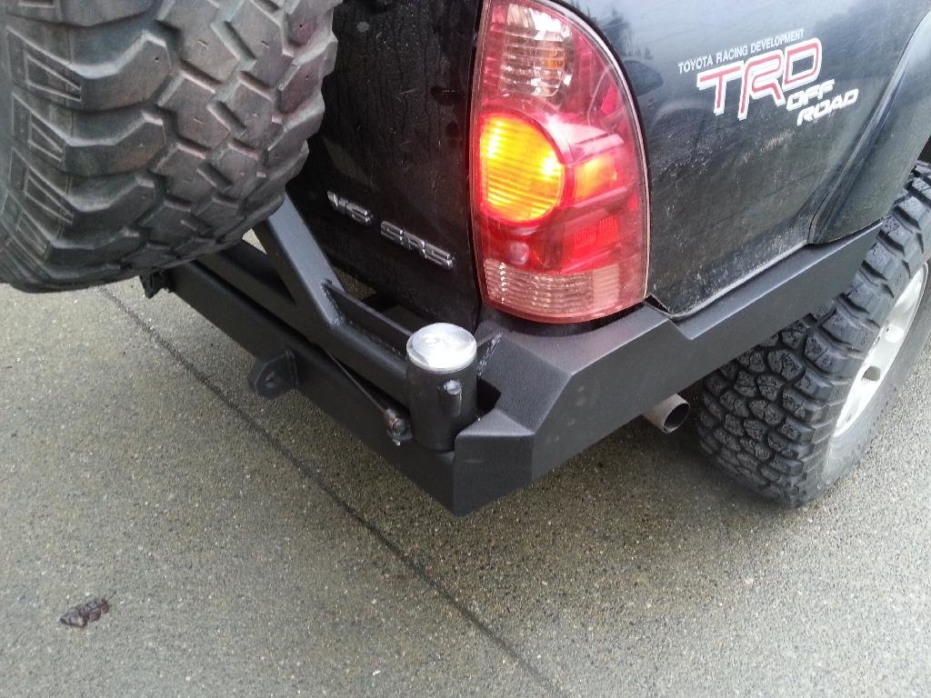

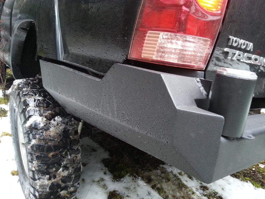

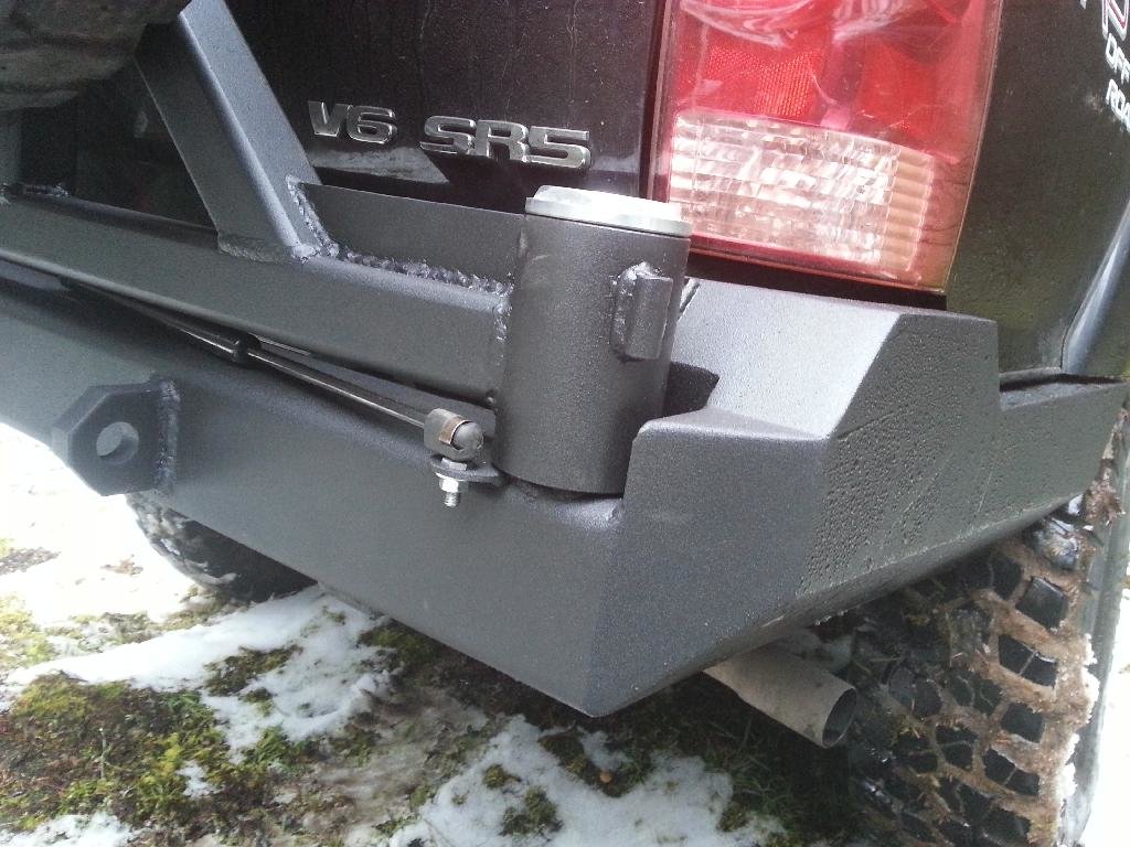

    Got the bumper to a driveable condition today.

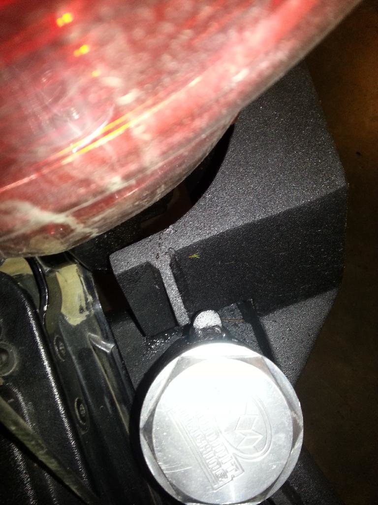

    The trim I put on the cut edges of the bedside lasted for about 15 minutes before detaching and looking like crap, so I will need another source, or I will just leave it raw. I did paint the exposed metal. What are you guys with HC bumpers using?
    Still to do:
    Fuel can holder and swingout (2x 20L Scepter Cans)
    License plate mount with light
    Order 2x Flushmount LED reverse lights (thinking about these: http://www.rigidindustries.com/led-lighting/98003)

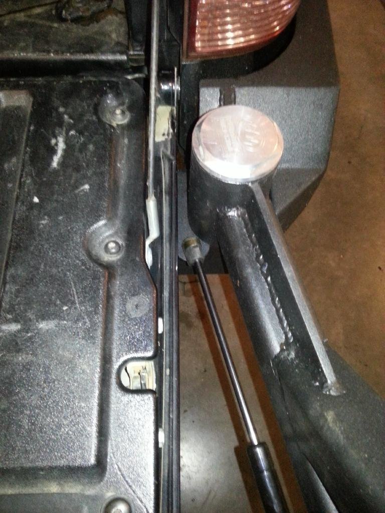

    Pretty tight clearance here. This was a bit of an oversight on my part. I didn't build the bumper low enough the clear the gas shocks while the tailgate is down. Not quite as clean this way, but is functional.

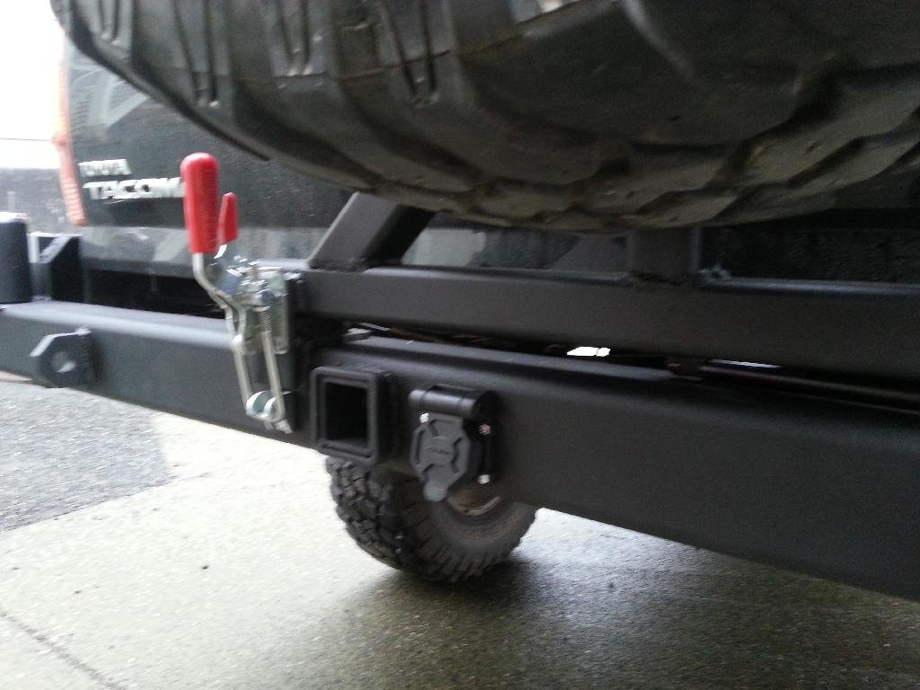

    This is the stop for the swing arm
    20131222_150138_zpsmy0obos_edit_13877583_151c4aab684971be5d21b76fcb9fd4e322fa3090.jpg
    20131222_151539_zpsyf3hpur_edit_13877585_bbab4eb283fa20f483d8da43184d5ba678a1c8fd.jpg
    Gotta fix that trim...

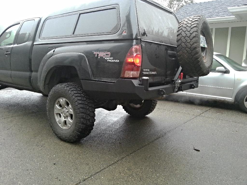

    After I mounted the bumper today, I took it for a drive. I hit some washboard gravel, and did some slow flexy crawling on a very short trail near my house. The verdict is that the swing arm is SOLID. I can pull on the top of the tire as hard as I can and all my energy is transferred directly to the suspension. Zero movement and no rattles. Should be all good :)

    This is what I used. Been on for almost 3 years and no issued. Got it from Oreilly's

    Thats what I got aswell.

    Used this as well. No issues and I appreciate that it has a built-in adhesive.

    Look great. Your springs seem to be carrying all that weight pretty good. You notice any difference wheeling with all that weight back there?

    Really dont notice any difference. The bumper weighs about 165 lbs witht the swingout. I weighed the old bumper and hitch at about 90. I dropped maybe an 1/8" not really noticable.
    The fuel cans will add alot of weight, but the tire and cans always sat in the back behind the axle when I was on extended trips anyway, so I dont expect much of a difference from what it was before.
    They are allpro expos btw
