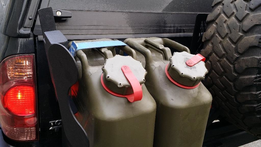

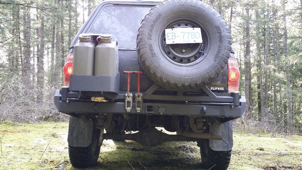

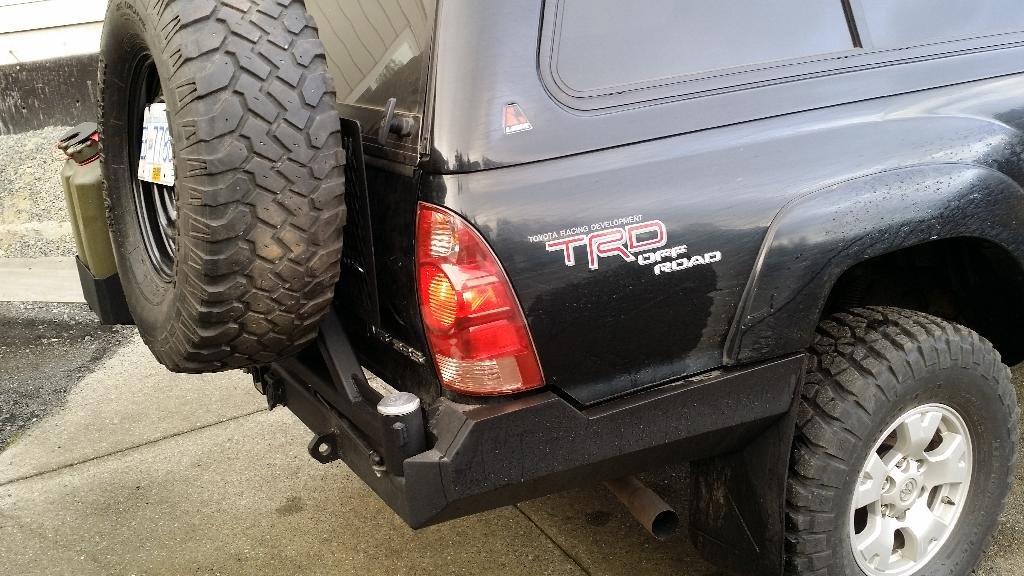

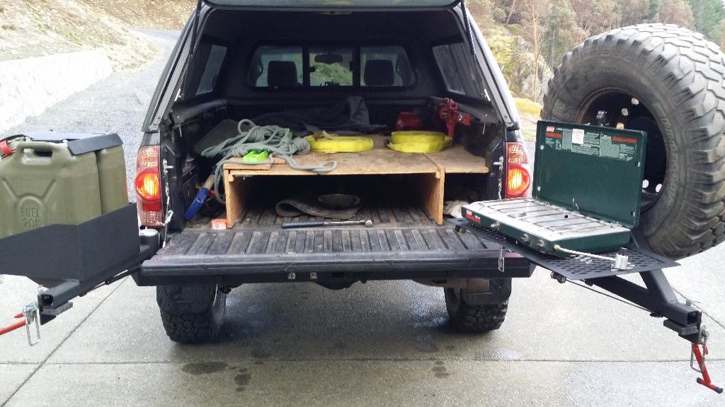

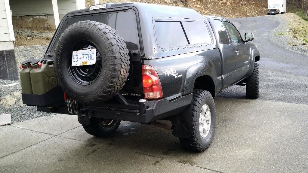

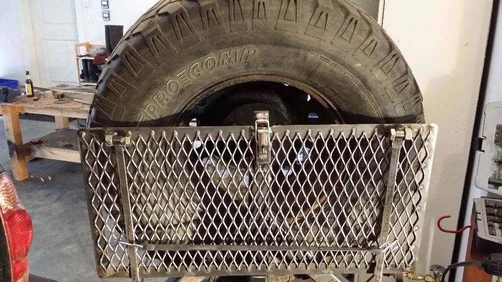

    Here is the finished product with new mud flaps.

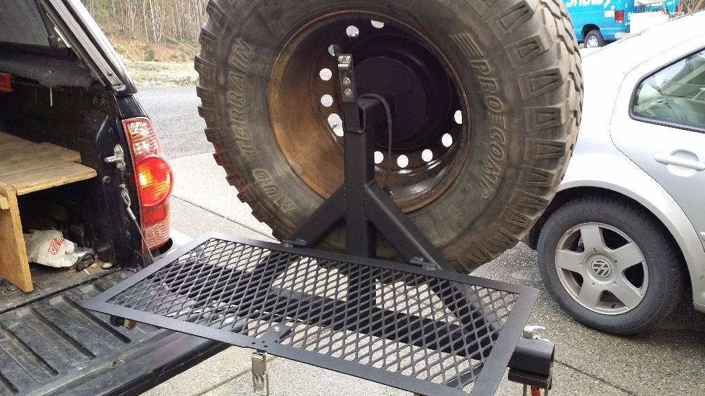

    Fold down cooking table

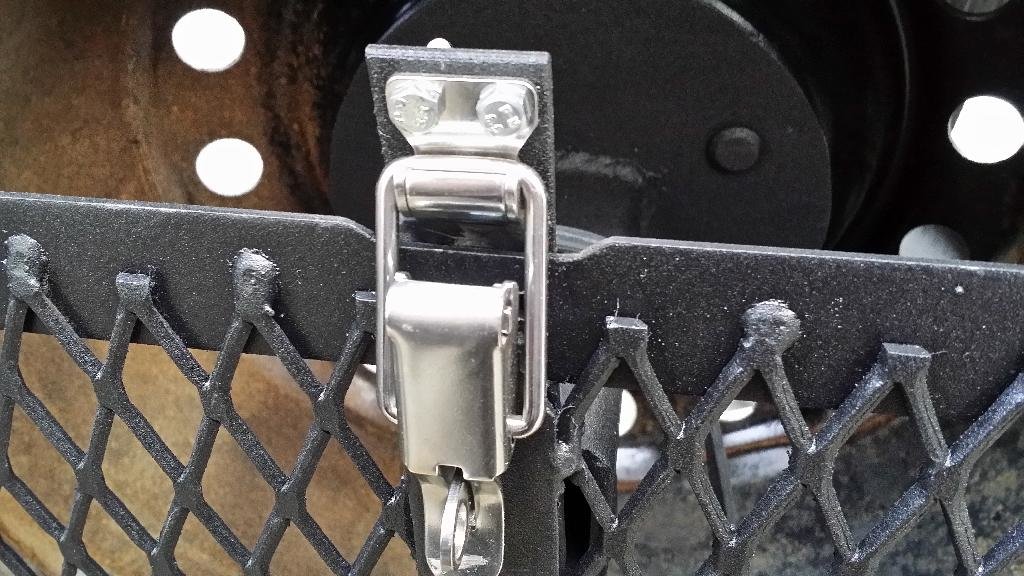

    Latch for cook table

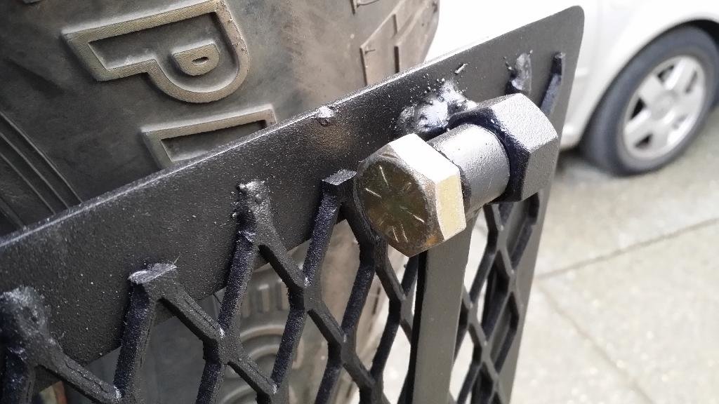

    Hinge for table support legs. A little ghetto but it works. Some real weld on hinges would have been nice, like how the table itself hinges, but I had this crap laying around.

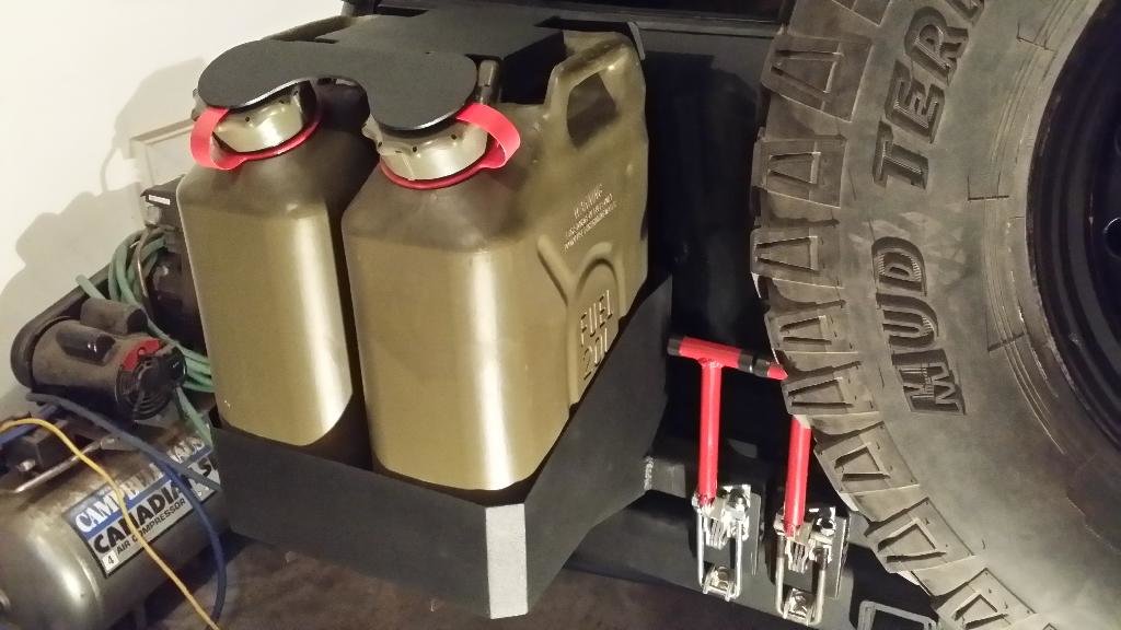

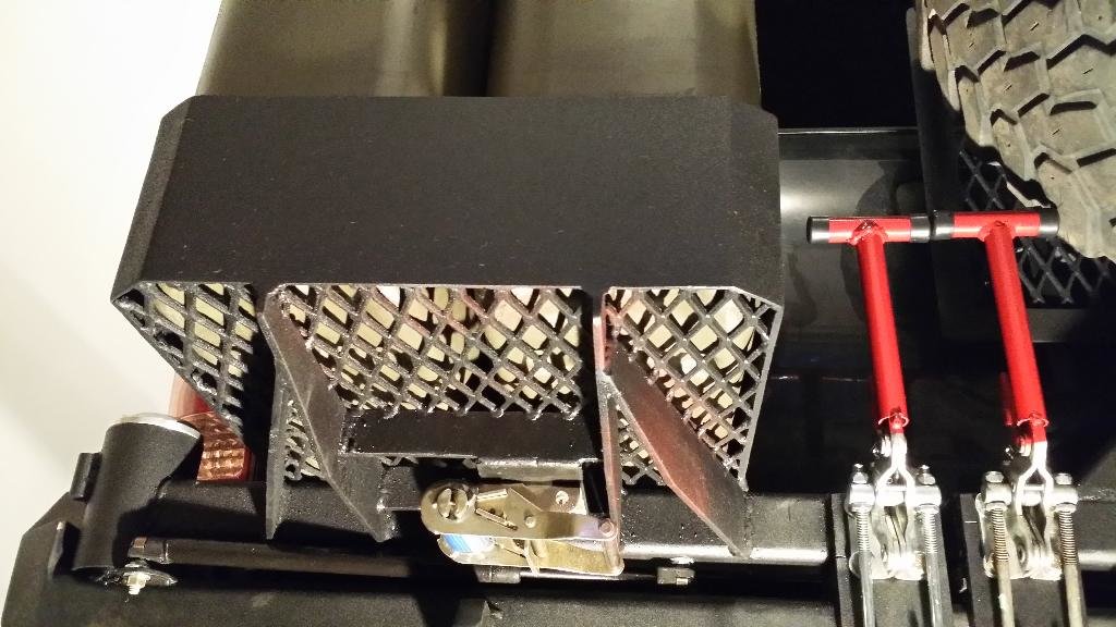

    Fueling mode

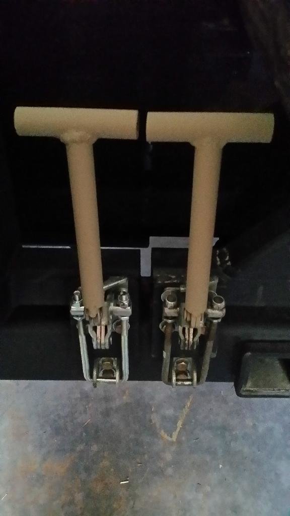

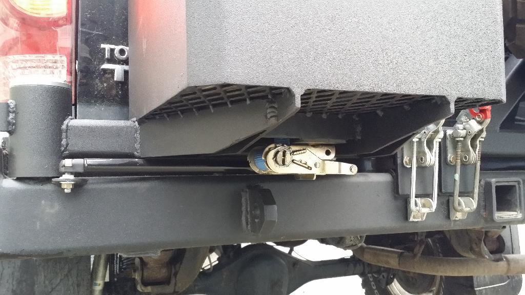

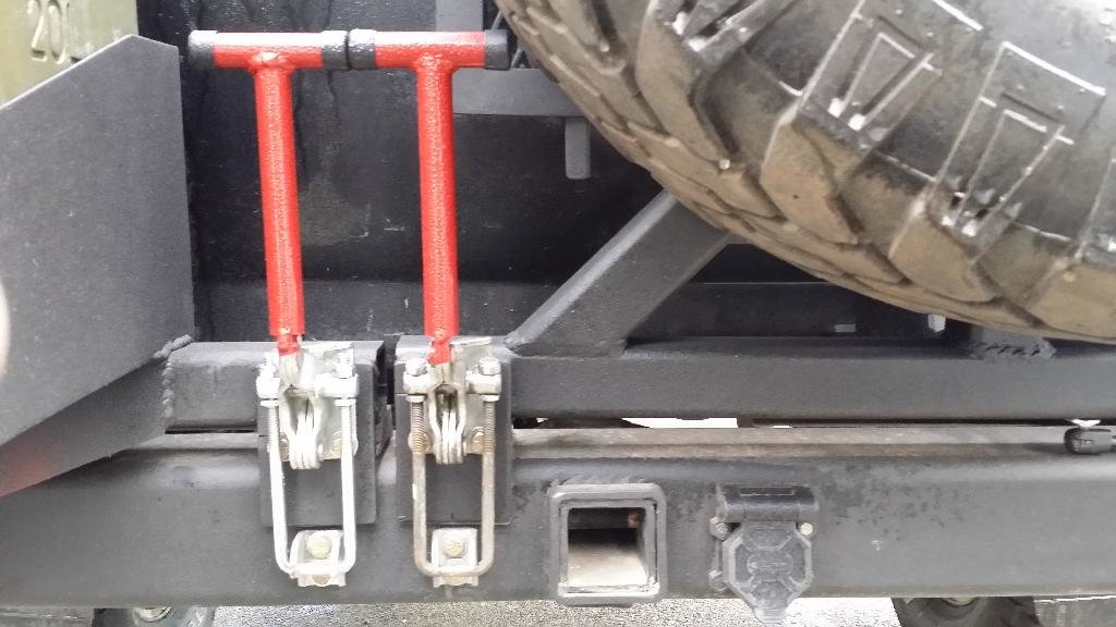

    I extended the handles on the Destaco latches to give a little more leverage so the wifey can operate. Much easier to open and Latch. With the T handle, I can open both swing arms in one motion, by grabbing the top, or just one at a time.
    Ratchet mechanism.

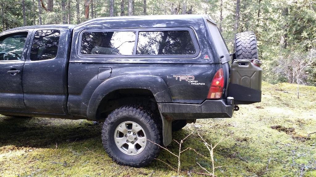

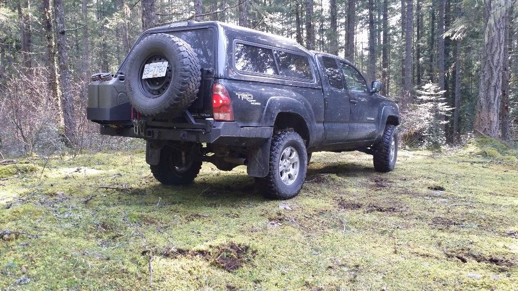

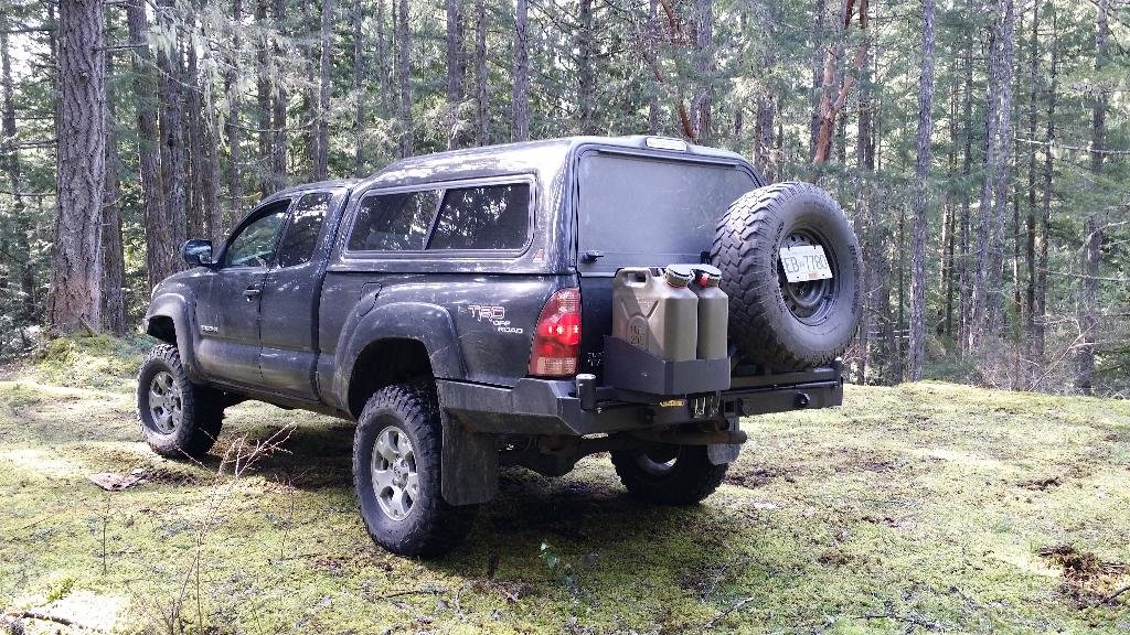

    Getting some dirt on it

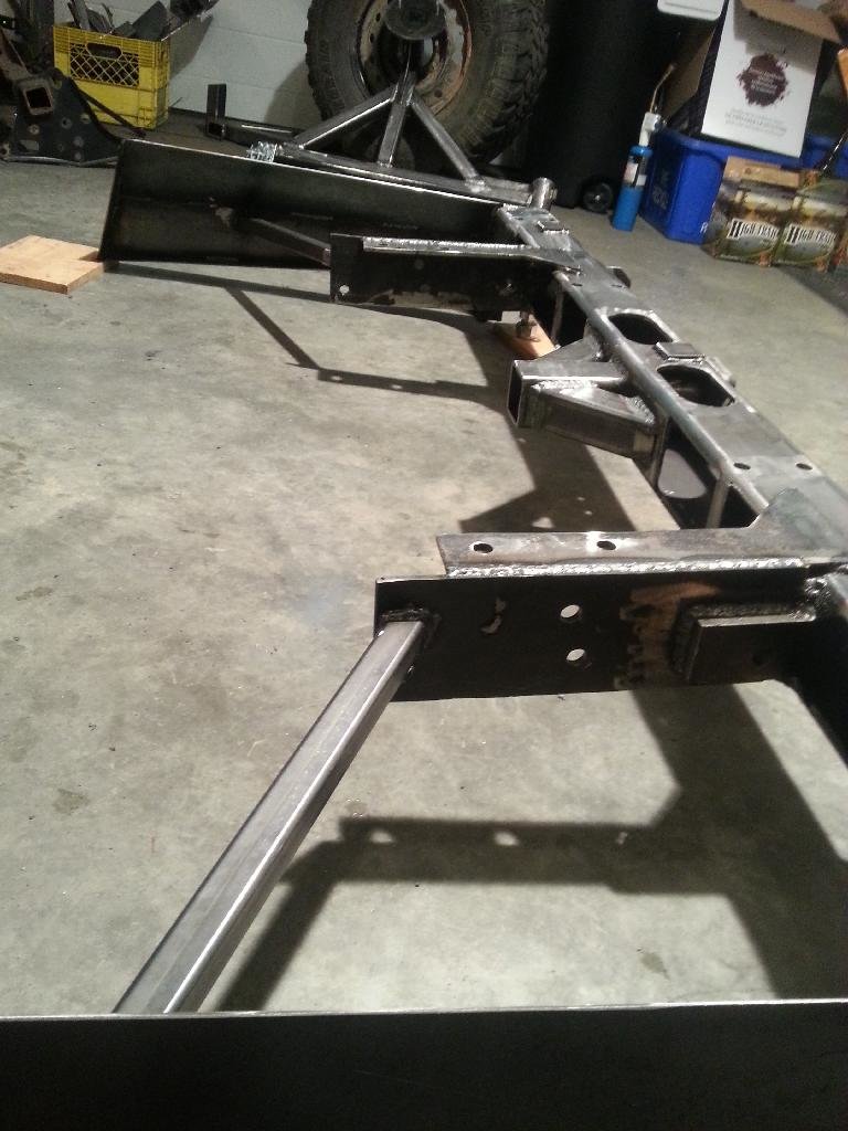

    I noticed your mounting plates don't wrap under to grab the bolt holes on the bottom of the frame... have you noticed the bumper bending or shifting to either side under stress without that attachment point?

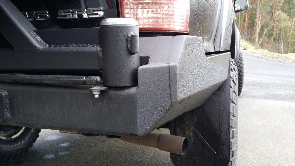

    Hmm, the mounting plates do wrap under the frame. There are 3 bolts on the side and two underneith.
    Heres a pic before paint that shpws the gusseted bottom. Is this what you are referring to?

    Yup! I had looked at this pic before but I guess it just didn't register that it was upside down er somethin, thanks tho!
