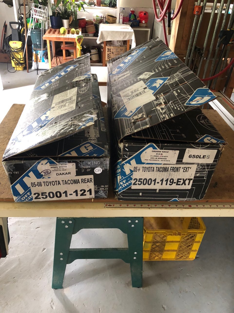

    Sorry let me elaborate. So your looking at getting the King 25001-121 setup in the rear. This to my understanding is built for about 1" of extra rear travel. The 121-EXT is for 2"-3" lift. So with your 1.5 AAL your kind of sitting in the middle of this. Neither would be ideal for your current goals. If you could hold just a little bit to get the 121-EXT and the Dakar's you want, this would be your preferred end goal.
    The 095r gives you 2" lift with 0 weight and I think the 096r gives you 2" with ~600lbs. Please do not quote me on this its just off the top of my head. So if you purchase the 096r, remove the extra leaf which turns it into the 095r, you get the 2 inch lift your looking for. Adding weight? Add the leaf back in. No money spent on the AAL that will just sit in your garage in the future, nor the pain in the behind grinding off the rivets to fit it. The hassle it will save you in the future might save you some headaches and money in the future.
    For an FYI, I purchased my Kings through DSM. They have an option for the 25001-121-Dakar where they are built for the leafs you have in mind. I went this route and it turned out really well.
    Attached pic for your reference, box on the left.
