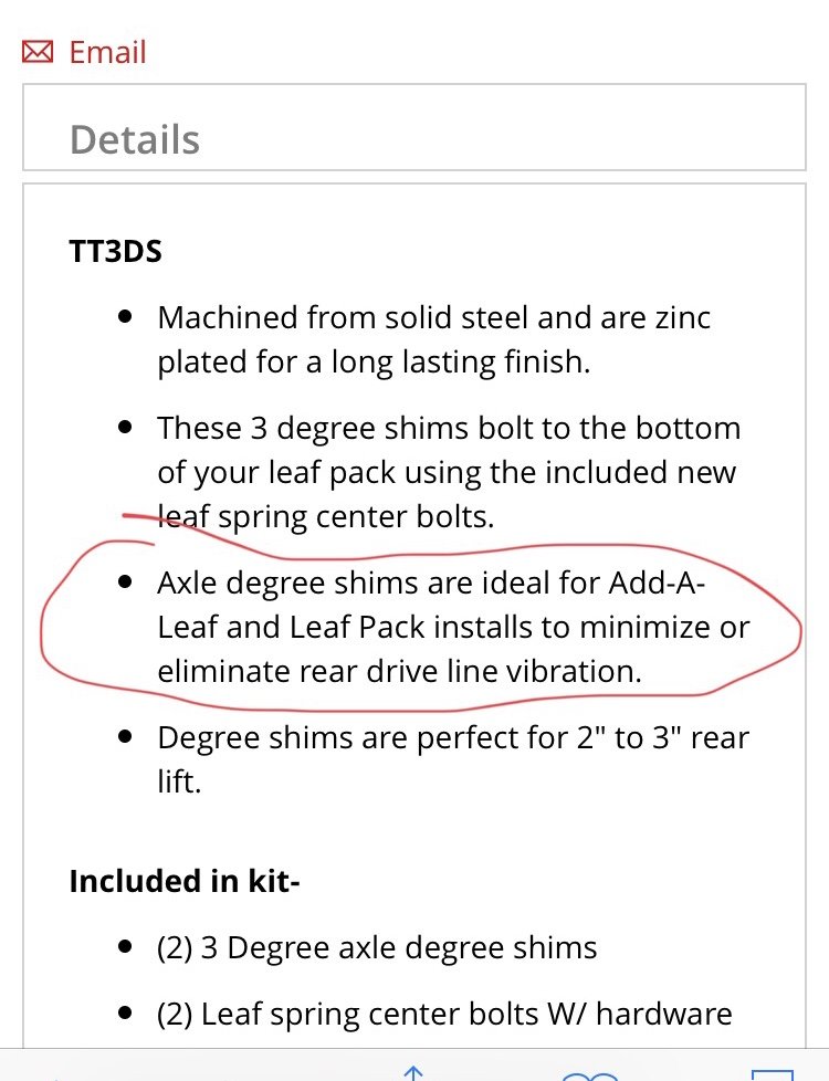

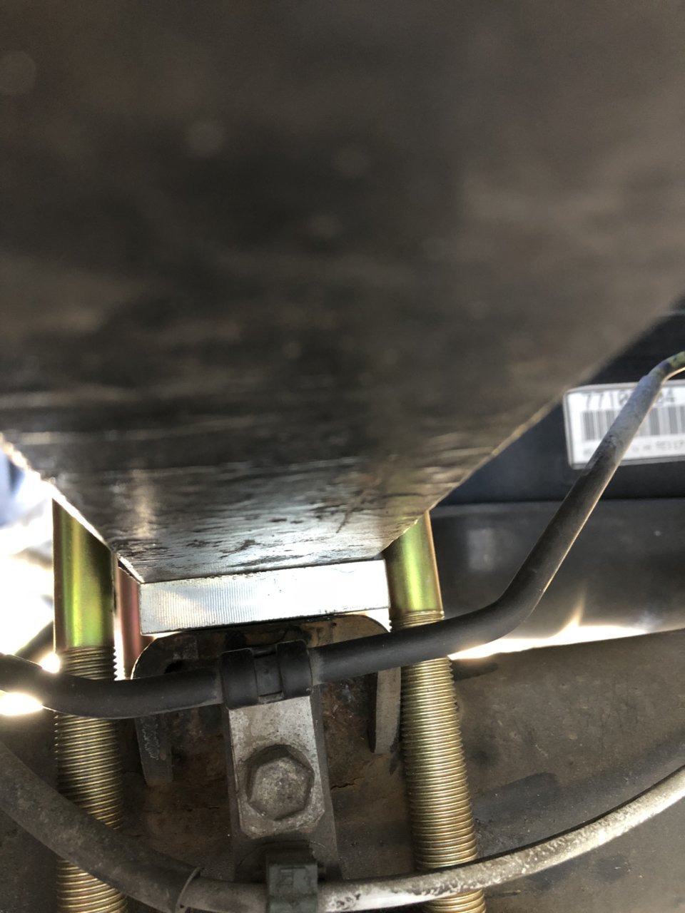

    Sure works for AAL and leaf packs...I’m running these thought they were aluminum but they are zinc plated steel...I have no complaints.
    8BD80891-657C-4F98-BB52-E603E196C7EF.jpg FD183723-59C4-401B-B3BE-39D976795E42.jpg
