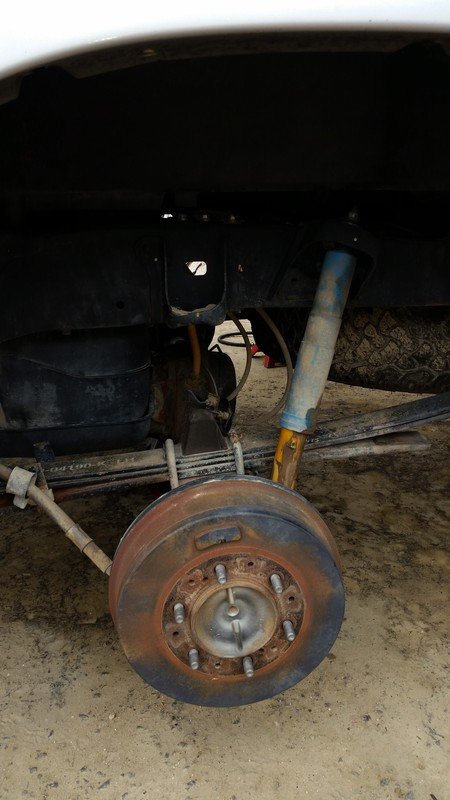

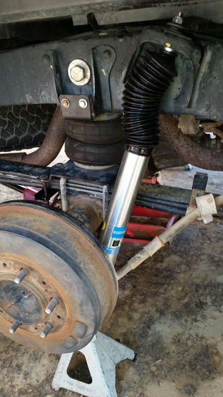

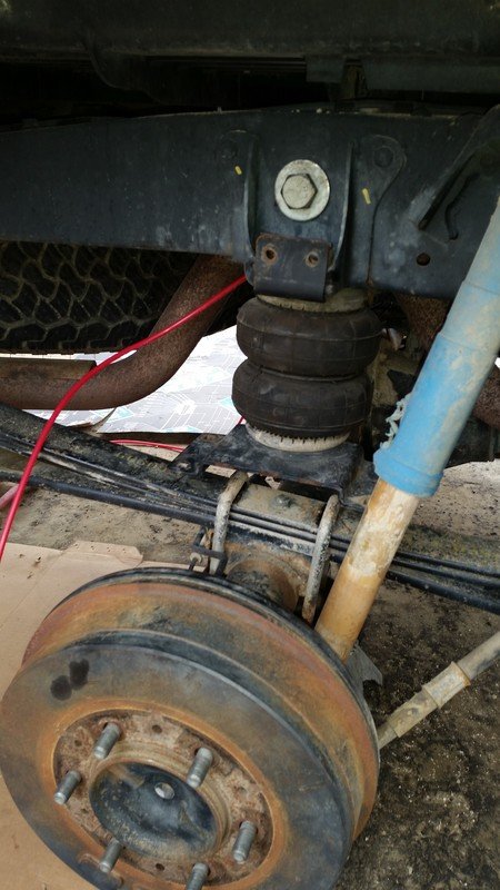

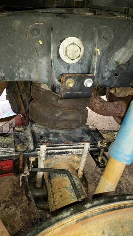

    Ride-Rites: Increase your rear clearance, they don't take it away (if I understood the concern). They go where the factory bump stops are now. At 10 psi, they don't do anything beyond the factory springs... anything more, they begin to lift the rear end up. 20-35 psi for loaded trucks.
    You don't need the compressor. Hopefully, you all have portable tire pumps (not hand pumps) that clip onto the battery or can just go the gas station... A tiny amount of air adds quickly. Mine does not lose pressure the way someone else's here did. I can go 6 months and it is never below 10 psi from 15-20 psi where I usually keep it.

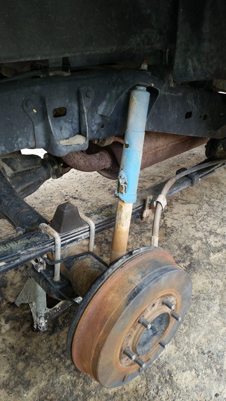

    Before airbags and new shocks:
    After airbag install:
    With new shocks:
    Installed by Jason 'SpeedFreek' of Vista CA The Tacoma World Pro in San Diego County!:
    Here are my measurements of lift they give:
    I have had these air bags for over 10 years now. First on my 2005 which bottomed-out with any load when hitting a bump and then when I traded that one for my 2010, I had the dealer remove my air bags and I boxed them up. My 2010 had better springs (still the 3-pack) and they did not bottom-out. However, after a few years, the springs weakened a bit and I began to get the "harsh ride" so I had Jason (@speedfreek) install my old Ride Rites and they again worked like a charm! I also had Jason replace the stock Bilstein shocks with new 5100s, all around.
    OK, so how much do the air bags raise the truck bed up:
