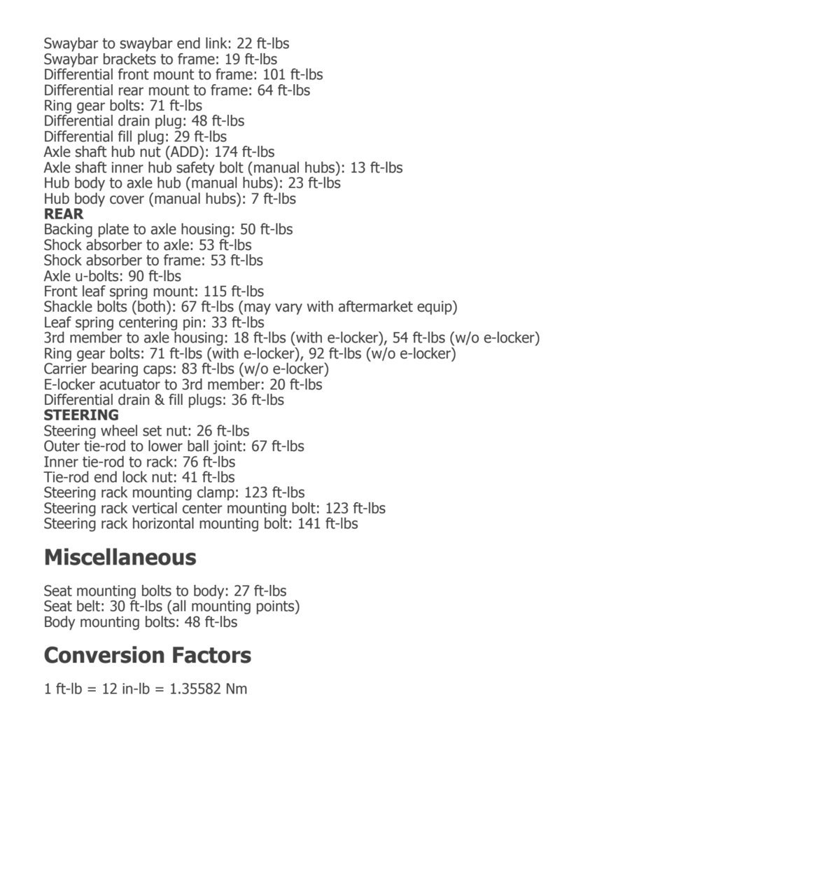

    The torque spec for the shackle bolt is 67 ft/lbs.
    The main eye bolt toward the front is indeed 115 ft/lbs. The shackle moves which is why I assume that bolt isn't torqued as heavily.

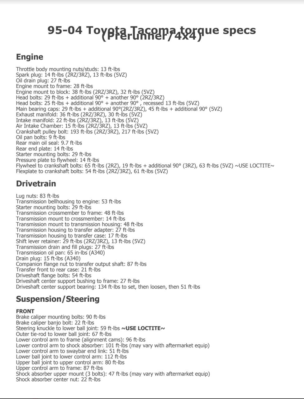

    Here's the torque spec sheets for our trucks with the numbers you need, I have these printed out and in my truck.

    Yeah I have that printed too, now that I'm looking at it again it's pretty clear. I guess I got confused because the shackle bolts and the the front leaf spring bolt are the same size (14mm?) so it seemed weird that one would have twice as much torque as the other but I get it now. Was a long day...
